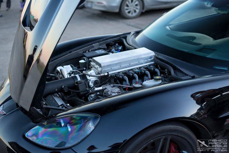

We took 2 C6 Z06's to the mile, one boosted and one on nitrous. Both cars ran personal best this year. The boosted car on 18 lbs and the nitrous car on a 400 shot.
