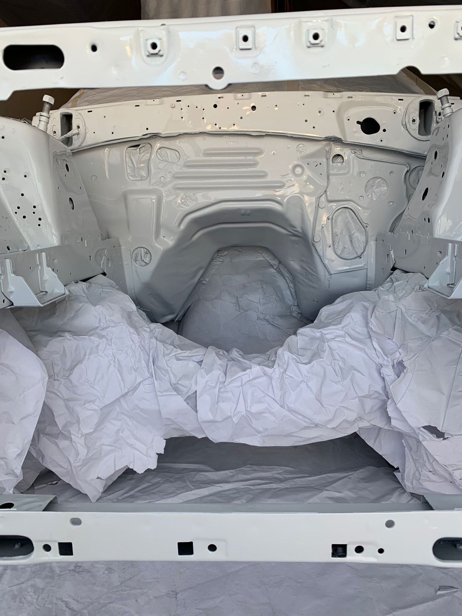

It was 95 degrees the day I shot the paint. I had high temp chemicals but not high enough. Primer went on with a sandpaper texture. I had to sand a lot of it down to make for a better topcoat.
