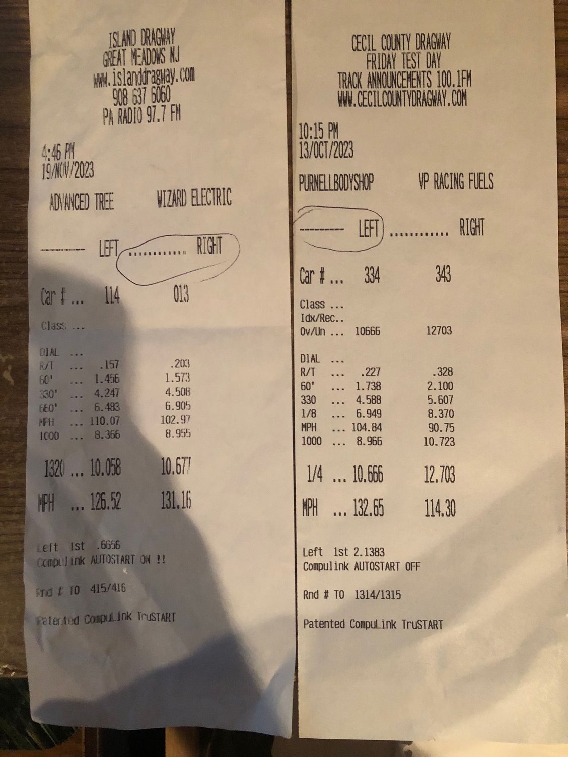

Haven't been on here in a while, but some of you may remember my posts from when I started my build a while back. I fired the car up in 2020 but the following next two years consisted of replacing 5 4l60e's built by some of the supposedly top builders in the country (won't name names) and not being able to make any solid passes with the car. Finally, in 2023 I went to a built 80e and proceeded to have a blast the entire 2023 season driving and racing the crap out of the car.
First time out to the track was a 3 hour drive through city traffic in the summer to Island Dragway in NJ and I didn't give it much time to cool. I wasn't sure how well it would hook up so I came off the line REALLY gently and ran an 11.0@128.8 with a 1.79 60', then was then told to slow it down or leave (no roll bar) so I ran the rest of the brackets I entered into with an 11.5 dial letting up at the 1/8th.
Second time I went down to Cecil in the fall since their tech was a bit more lax. Temps were much cooler. First pass I ran a 10.7@132 with a 1.75 60'. Second pass I got into it a little harder off the line and ran a 10.66@ 132.6 with a 1.73 60'.
Finally, I drove it back to Island also in the fall for another Impala SS club bracket event and after being eliminated in the brackets just before the track closed up for the day, I made an all out pass and ran a 10.67@131 with a 1.57 60'.
All these passes were made on the Toyo 345/45/17 TQ Proxes drag radials that I drive to and from the track on, aired down to about 19PSI. I found the best results with a really long burnout, I think even longer would work better but it's a balance not skyrocketing the IAT2's during the burnout. I've found on a good prep I could roll into the throttle pretty aggressively off idle, but just can't stab it too quick. I was shocked at how well they hooked up for the 1.57 60' pass, but they actually broke loose after the 60' a bit which I think hurt the ET (Island's prep definitely isn't as good as Cecil). Considering how many miles I get out of these tires and how nicely they cruise, I'm really happy with them even if I can't get them to hookup worth a damn on the street/no prep runway.

10.66 pass @ Cecil
10.67 pass @ Island
