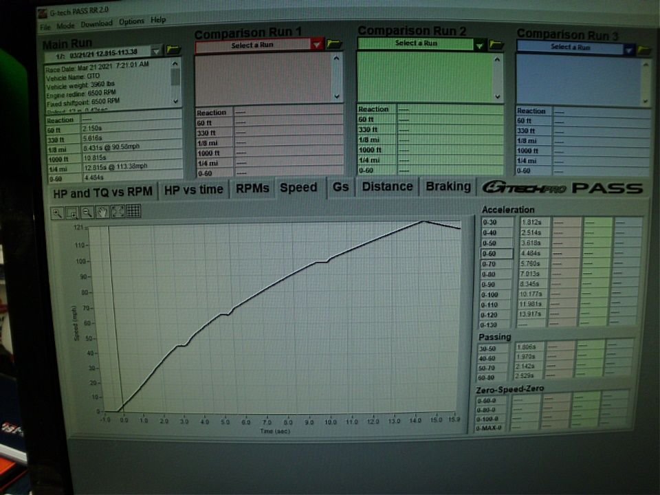

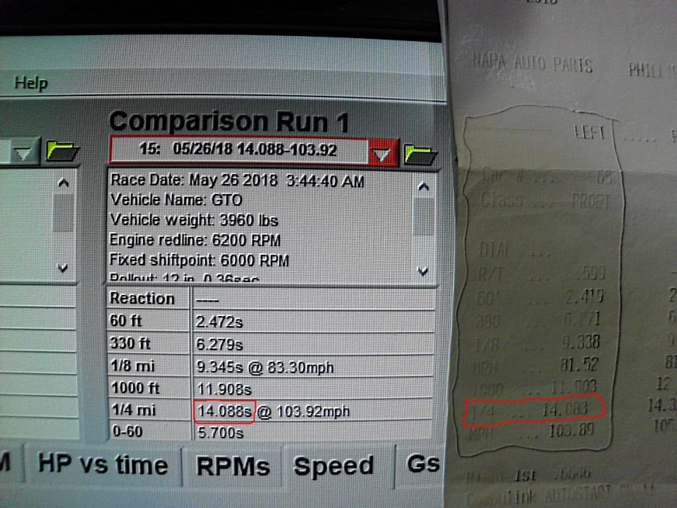

I haven't been able to get to the track in years, but the last time at the track I tweaked my GTech to pretty much match my timeslips (within a few 100ths of a second) and have then used my GTech since to practice. That day at the track was 100+ degrees, horrible air and running on old street tires so forgive me the horrible ET.
My timeslip GTech comparison:

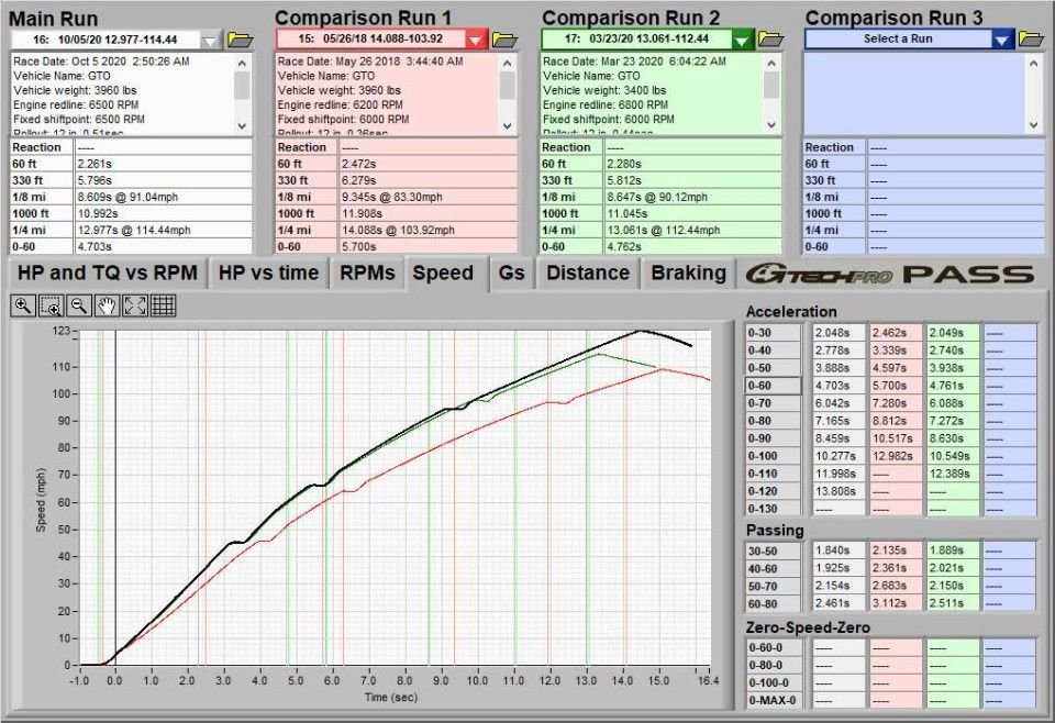

Later I was able to pull down a 12.9 on street tires on a decent piece of blacktop. At this time the car had a stock long block, Kooks LT headers and high flow cats, FAST 102, DuSpeed OTRCAI, 1.8 ratio roller rockers, 25% UD pulley and a tune.
The same set up but with Nitto NT05 drag radials.

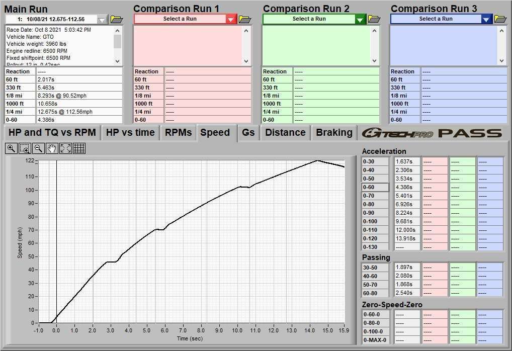

Then this year I added a TVS2300. This meant I lost my DuSpeed intake and my underdrive pulley, had to go back to a stock crank pulley/balancer for the blower. Also, I was stupid and had a Wix paper filter in the air box. But I improved to 12.6. I recently replaced the intake with a Lingenfelter CAI and I'm sure the output improved noticeably but it has gotten too cold out to get in another timed run. I hope to get to an actual track this coming Spring.

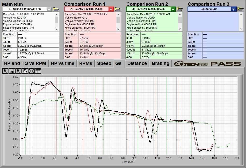

As you can see from this g-force graph the issue especially on the 12.6 run is a lack of traction during the launch.

Look at the wheel spin through first on the the post-blower run. I think that explains the lack of trap speed.
