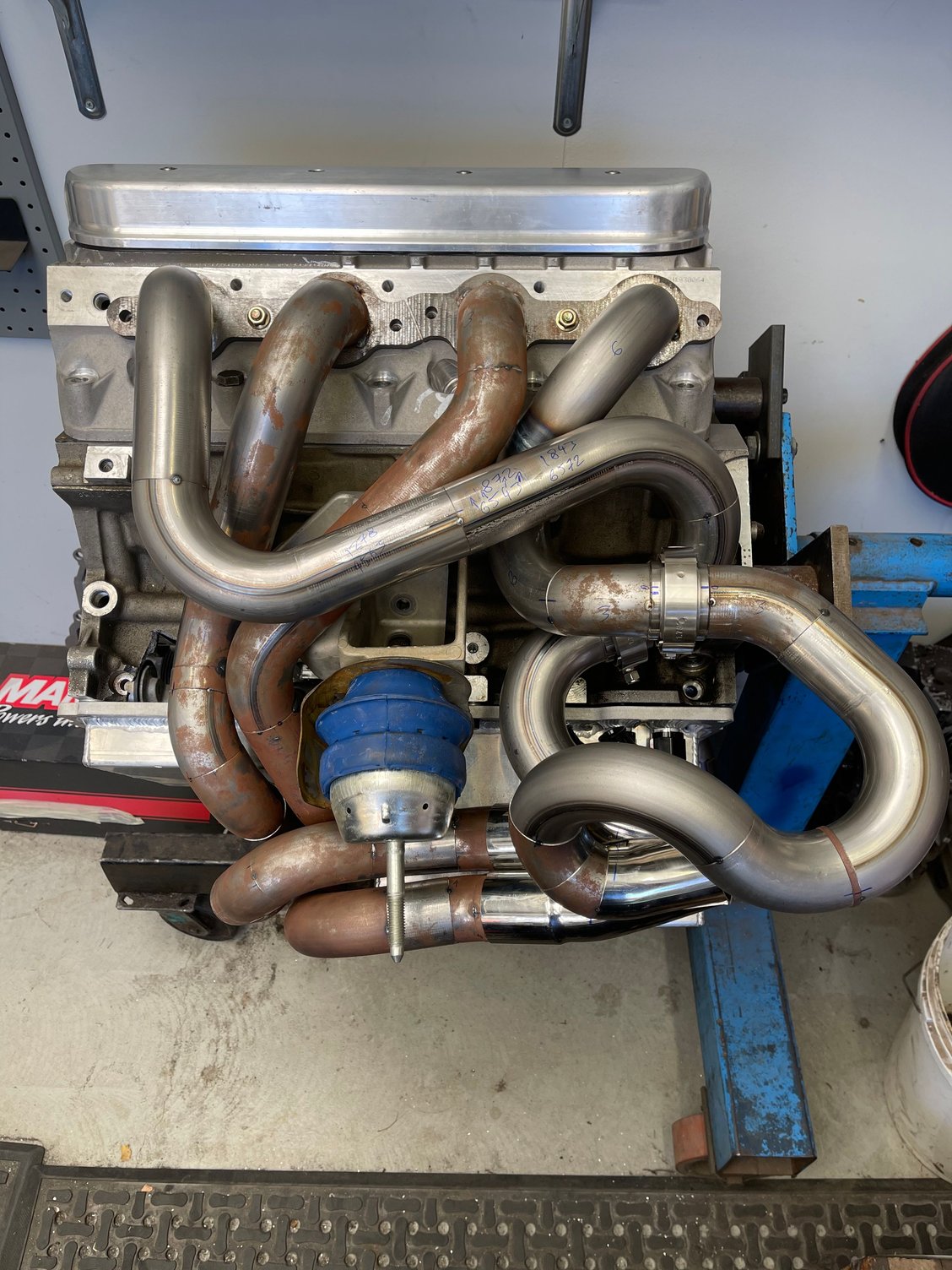

Hey guys,
I made an account just for this thread…
It’s a little long in the tooth now, but I thought id share my experience.
I’ve been making equal length headers for 10 years now, not as a business, but for a little side hustle essentially. From Sprintcars to circuit cars, turbo manifolds, motorcycles - you name it.
For my own projects, I built a set of equal length - around the front 6 into 1 pipes for a VS commodore ( Buick v6 ) with great results. Sounded unreal, and made pretty reasonable power for a mild cam 3.8.
Also built a set of equal length turbo pipes for a Gc8 Impreza, that made the same power as the standard manifold, on 7psi less boost.
Just recently I decided that I was sick of seeing and being tagged in posts for shops building 8 into 1 around the front pipes for race cars, using all the real estate where the radiator should be and it being called an engineering marvel.. I’d love to see someone build a proper equal length 180° setup in a street car. Turns out I had to do it myself.
Making a long story a little bit shorter, fabricating a sump, modifying engine mounts, remote oil filter and about 120 hours netted the result of a set of 36” long, 1-7/8” 180 degree headers. I’d also had the car dyno’d in stock form, un opened, un tuned before the headers.
The car is a VE Commodore, with a 6L and a 6 speed.
needless to say, it was massive project and I am super stoked with the results. Gains of 43kw and 120Nm, albeit with the addition of 2° timing around peak torque just to smarten it up. As you can see by the graph, it raised the whole power and torque curves and is a completely different car to drive..
I’m currently building a high comp 6L for it now, as the engine had 230k on it..
Old Nov 30, 2022 | 09:04 PM
  #78
Posts: 7,853
Likes: 5,206
Wow, nice work man. Welcome to LS1Tech!
Old Nov 30, 2022 | 10:25 PM
  #79
pdxmotorhead's Avatar
Joined: Oct 2016
Posts: 2,513
Likes: 480
From: PDX-OR-USA
its SOOO much easier to put 180's on a dry sump motor.
I worked trackside with a 67 Camaro that had them. Was a race car from day one and ran in the old road racing series back in the day, they dod not punch in teh top end, they did however work so well in the mid range they were banned in most classes, they really rewarded cars on tight curvy tracks..
Old guy moment.. thanks for listening..
Old Nov 30, 2022 | 10:36 PM
  #80
moffpipes's Avatar
Joined: Nov 2022
Posts: 3
From: Melbourne, Vic
it’s SOOO much easier to put 180's on a dry sump motor.
Agreed. This is still a wet motor, I ended up taking about 1L off the oil capacity.. hopefully the 6’ of oil lines make it up.
