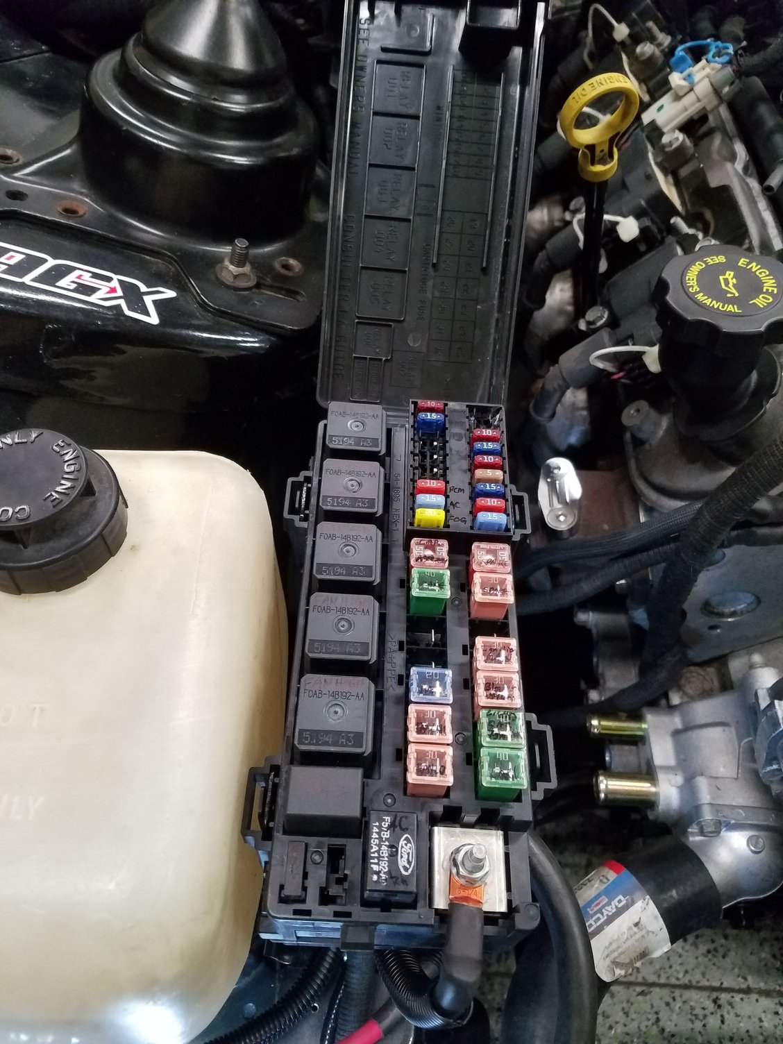

In my swaps I have found that ford fuse/relay boxes are the easiest to integrate into the cars existing wiring circuits since they have removable pins on the backside. It makes it easy to trace where the wires go and also to make changes to wire size or pinouts. Most of the gm boxes seem to just have factory plugs on the backside so not as easy to make changes imo.
I found this on a 02 lincoln ls. It has 7 relay slots and large fuses for the main power wires and lots of slots for mini fuses. It has a removable cover on the backside so easy access to wiring. The older crown vics have a smaller square box that have 4 relay slots & lots of maxi fuse slots and a few standard fuse slots.

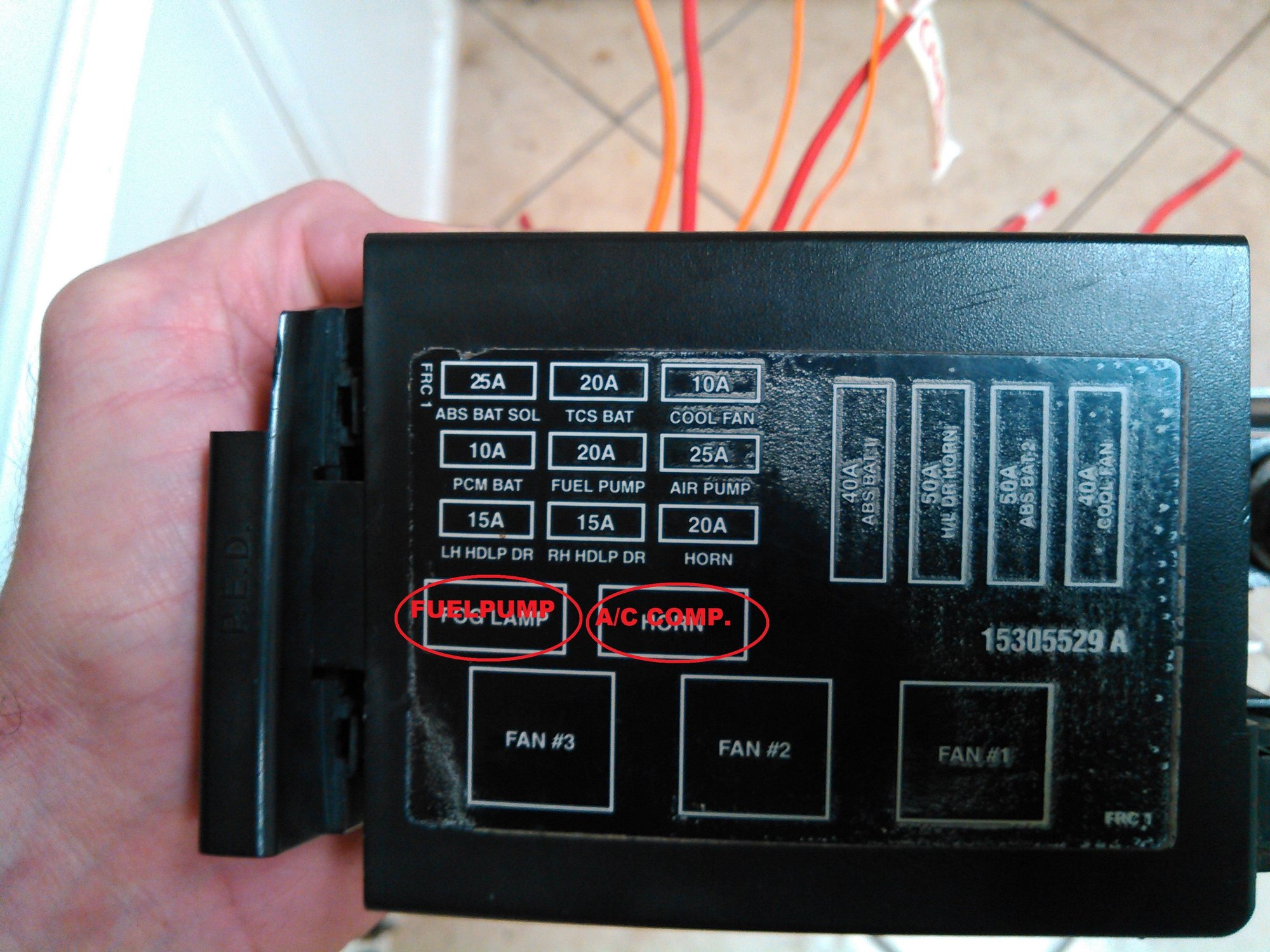

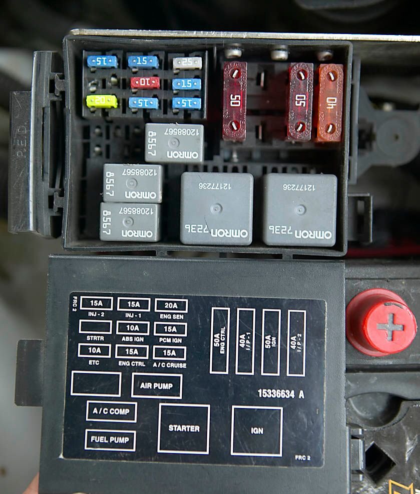

I'm using a late '90s F-Body box on my swap; GM used this same design on MANY cars throughout the '90s and early '00s.
What I really like about this box is that you can easily take the terminals out and rearrange it however you want.
Here's a picture of the style of box I'm talking about:
Here is how mine is arranged:
Here's how I repinned it:
Here's what the bottom looks like (don't pay attention to the numbers, they're specific to my swap):
