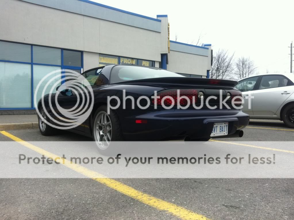

Originally Posted by SnakeStomper
Strano springs checking in.
This picture just made up my mind on Strano's! Identical to mine other than my wheels..
The ground clearance and everything I am hearing about Sam's springs are sounding amazing. My lt's and custom turn downs had me worried, I think I'm going to give it a shot though..
Quick question.. With my 315's in the back, how bad is it going to be as far as rubbing? Is it going to be rolling fenders, BFH mod, or both? Who runs an adjustable PH bar with this setup?

JustAFool: I would start with the BFH mod. Still might have to roll the lip to keep from catching the tire. What offset do you have in the rear? Adjustable PHB is a must when lowered and 315's.
