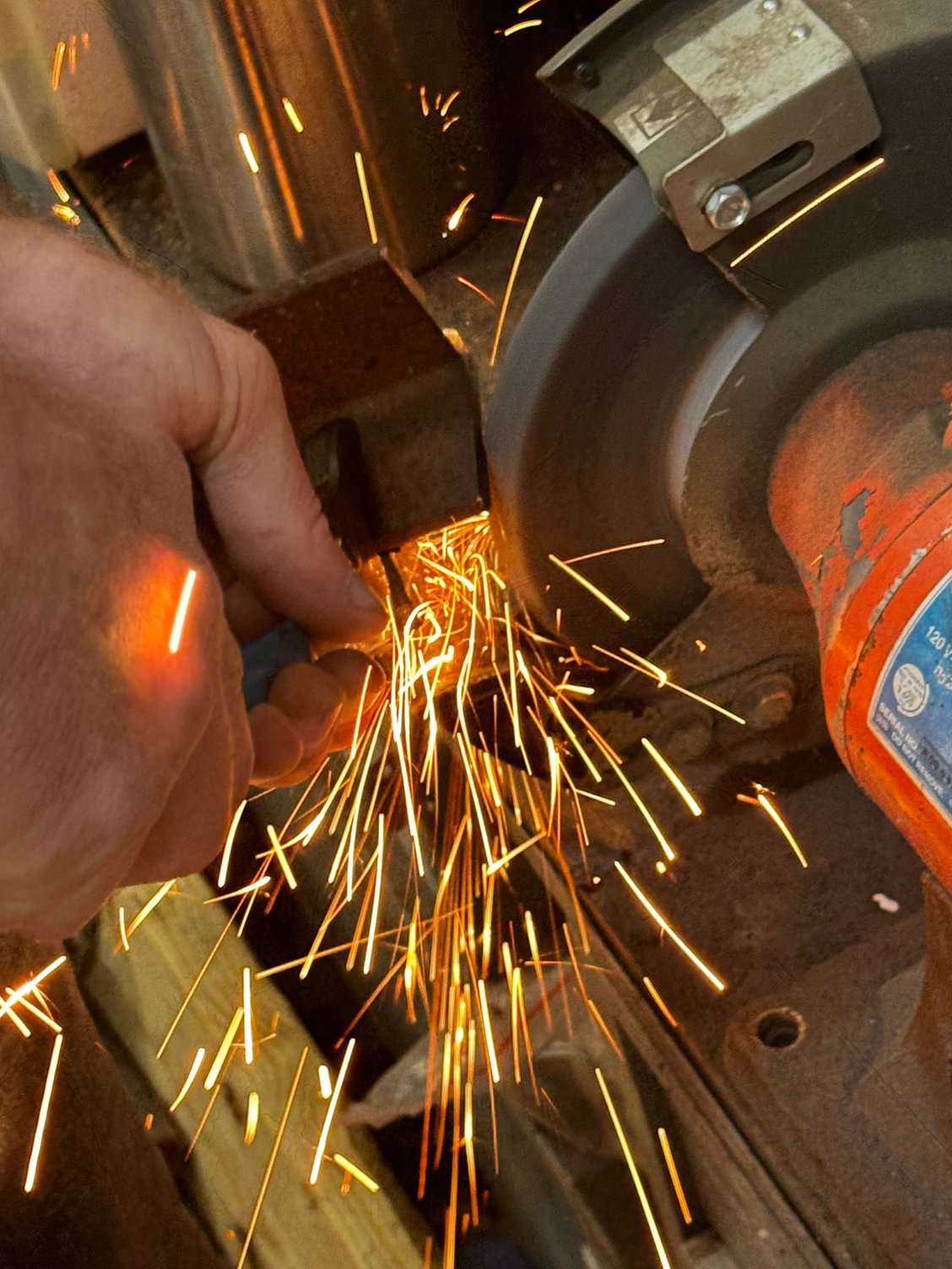

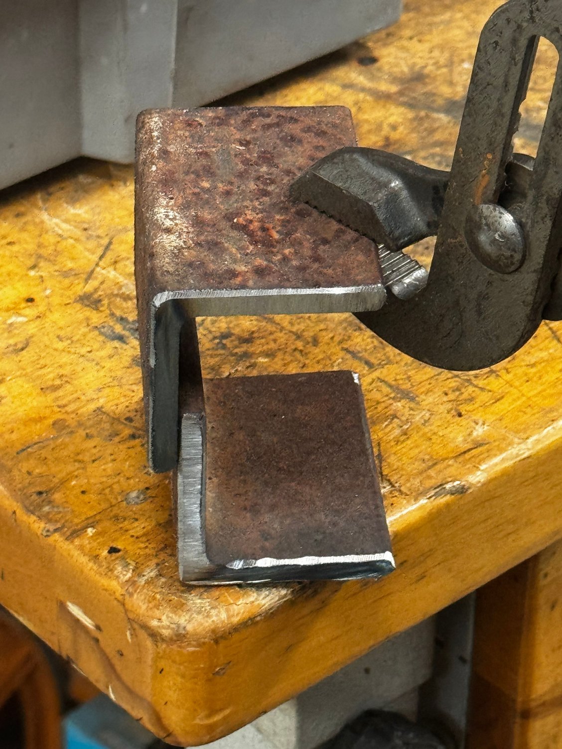

Trying to find the right height for this bracket and weld it.
Grinding it down
Grinding it down

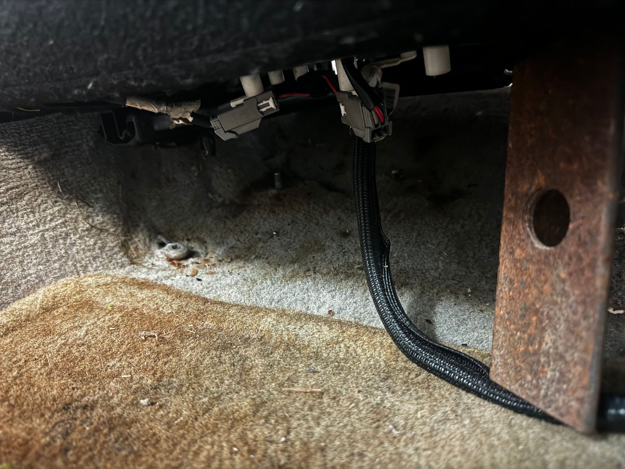

View of the left rear mounting bolt.

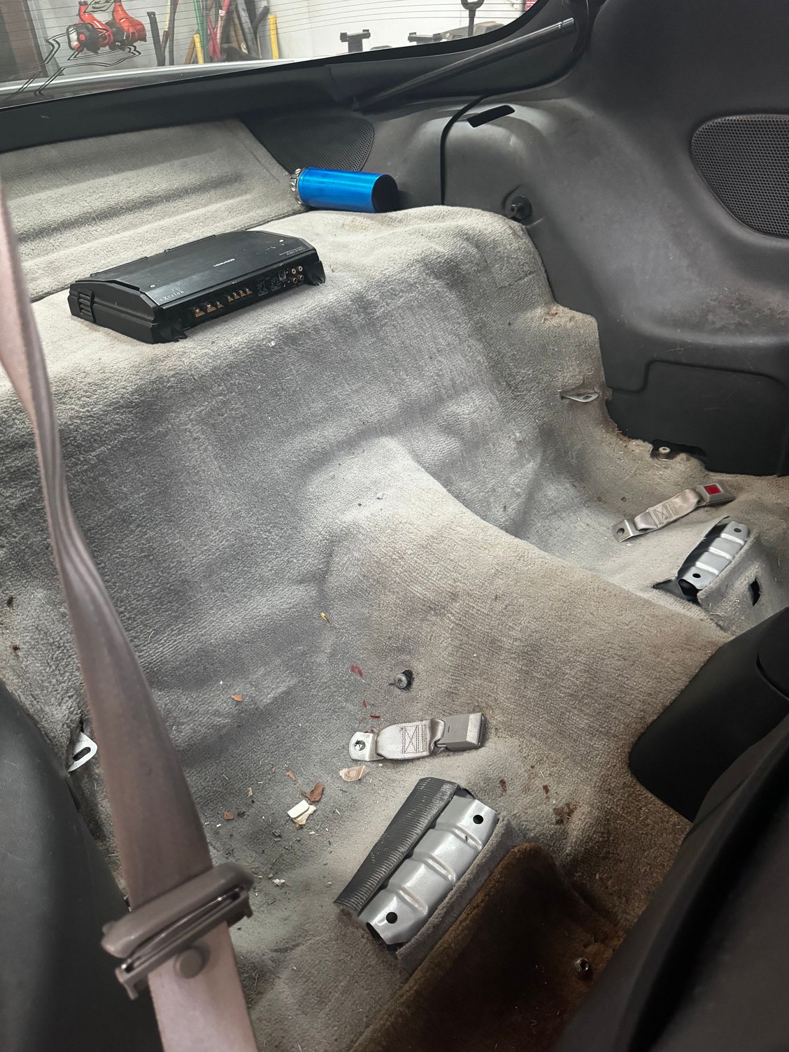

Had to take the back seats out, not like they were doing much anyways. Now I have room for some subs.

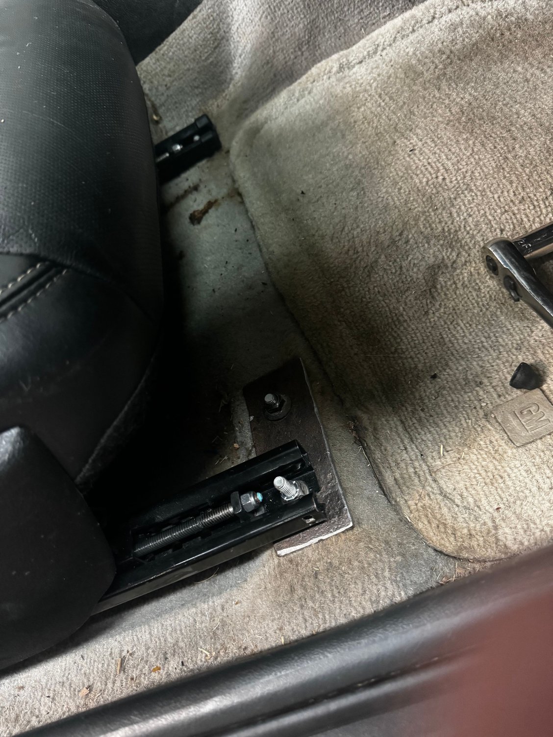

Front mounting situation (not finalized)

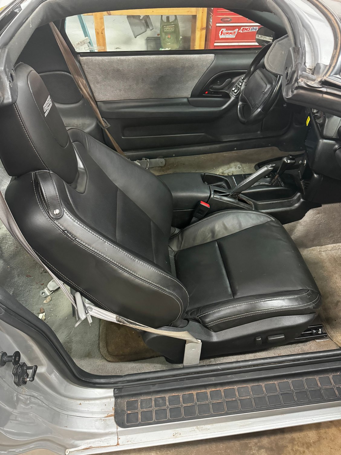

Mock up of the seat. Noticed that I’d have to figure out how the seatbelts will work, since the 4th gen belt doesn’t last into the 5th gen receptacle. Any ideas?
Mock up of the seat. Noticed that I’d have to figure out how the seatbelts will work, since the 4th gen belt doesn’t latch into the 5th gen receptacle. Any ideas?

I was referring to just using the 4th Gen seat belt receptacle. Does removing the 5th Gen one screw something up?

Upon further research they must have standardized how the belt and buckle are designed sometime in the late 90s or early 00s, and if you buy a new seatbelt kit made for a 4th gen, it’ll come with the newer belt design that’ll work with the 5th gen buckle. I didn’t know whether or not it would come with the old design or the new one when you buy a new kit, so that problems resolved.
