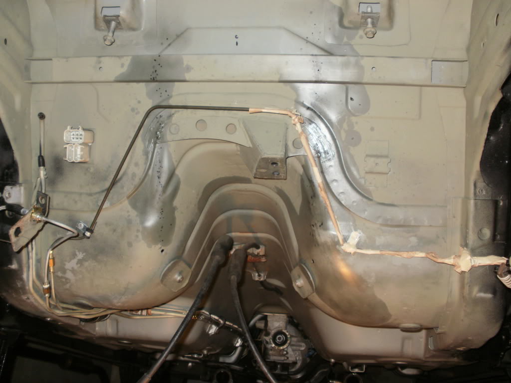

POR-15 is a popular choice, but decided try rust bullet automotive paint.
Before:
After:
I'm pretty pleased with the result. I'm going to paint the "frame rails" in Por-15 though.

I did prep the surfaces by sanding everything down with an orbital sander where possible, and by hand where the sander couldn't be used.

Very nice! How long did that take you?

3 days, I took my time sanding and masking. I did not use my spray gun, just brushed it on.

Nice work. What did you have to do to disconnect all the lines to the fuel tank to drop it?

I released the pressure using the schrader valve on the fuel rail. Then I disconnected all the fuel lines, and plugged them up using vacuum caps. Thanks for the compliment.

Got everything back in. Too much silver??

not to much silver at all, that looks killer!

Looks immaculate!

What car is this? My first thought was f-body (that looks like the bottom of the trunk), but I see an IRS.

That's an fbody you can see the rear seat holes.

Fbody but not fbody rear.

Correct, it's a 4th gen f-body, but a c4 rear suspension.

I've never seen that done before. Got a write up, some more info, pictures? How does it drive?

The guy that own zeus performance has the same setup in his SOM lt1 firebird.

There is an IRS thread in the suspension section from August 2011. It rides firm, it's still a lowered car with 11" wide wheels on the rear, but is far less jittery over road imperfections.
That is correct also, he was probably the first to put one on a 4th gen - at least first documented install any way, Orange_99_SS also has one.
