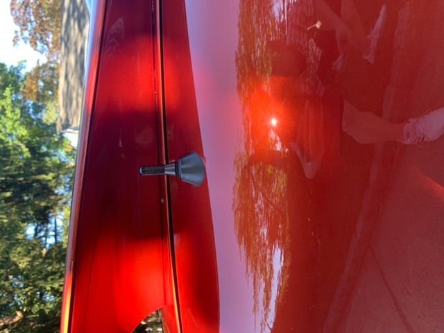

finished product:
Uploaded these from my phone, so I guess that’s why they are sideways. The process outlined earlier is the same. I confirmed radio reception is actually decent, even though I won’t really use terrestrial radio (I’m a satellite guy), but I wanted it to work. Ideally, I’d like for there to be NO antenna (a member here shaved his), but I don’t feel like touching the paint. It’s basically still new, with 19k miles.

Nice. Looks good! So what did you tell Hawks? That you need the Camaro bracket for a shorty antenna on your TA? Is that what you received and installed? What did you pay for it?

So basically, I called and originally asked for a 93-97 Trans Am fixed antenna bracket (I gave them the discontinued part number that is mentioned in this thread). I spoke to Ryan on the phone in sales, basically telling him my year make a model, and what my intentions were. Don't know if it matters, but he told me we can just take a bracket from a 98-02 model year vehicle (same part #) and all I have to do is swap it out as per the instructions in this thread. Yes, you have to drill the bracket that is in the wheel well inside the car, yes you have to be careful and measure, no I didn't take pictures of that portion of it, because it's exactly the same as what is already here in this thread. Cost was not cheap - $75 + shipping. You get the mast and the original 3 foot antenna which I wouldn't use anyway, but they only sell it together. Like I said, not cheap, but you can then turn around and sell your motorized antenna if it still works and is in good condition, as they could fetch a pretty penny and are in demand.
