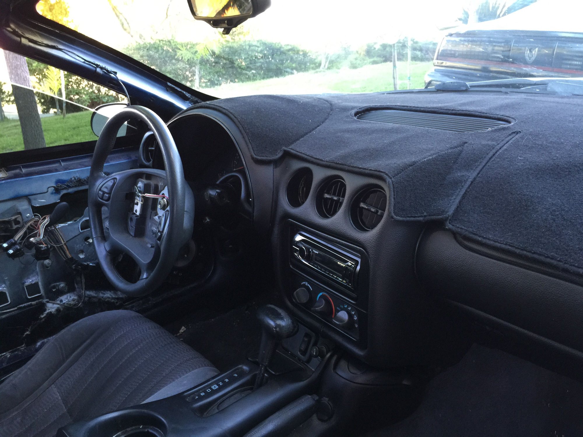

Old Nov 27, 2015 | 07:07 PM
THEF4NG's Avatar
Joined: Jan 2014
Posts: 9
From: Banning,California

Wow, that looks great. I wouldnt even know where to start taking the dash out.
That vinyl doesnt look any thinner than mine, but you got the vent holes covered flawlessly. Kudos!
