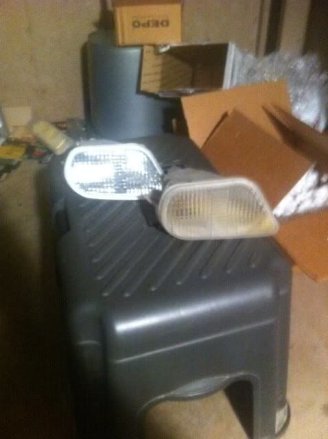

Depo 336-2002N-AS Pontiac Trans Am Driver/Passenger Side Replacement Fog Light Assembly
by Depo
Bought the above for my 2000 Trans Am. They come with the mounting brackets and bulbs and factory electrical connector. They come packaged nicely and have a clear cellophane film on the front to prevent scratches. This film should be removed prior to install. They fit perfect and work perfect. Make sure you buy GM 14103461 bumper cover retainers as you will need three. I butchered mine getting the lower three off the front facia to access the two 10mm bolts that hold the fog lights in. It will help to take out the bolts that hold the lower end extractors to gain access to the fog light bolts. When removing or installing the fog lights the trick is to rotate them towards the cut outs in the fog light hole so that you are pulling them out/putting them in bracket end up through front fog light opening.

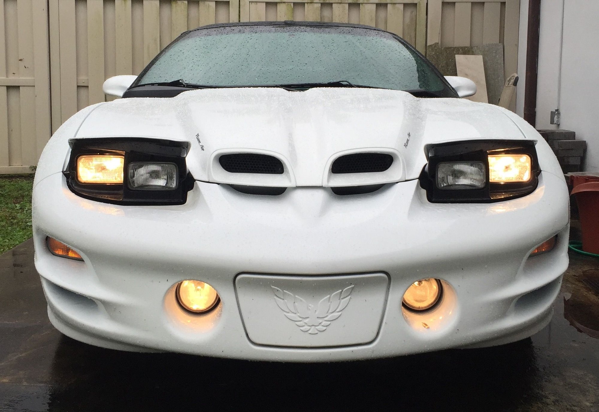

Before
After

Looks MUCH better, now replace those DRL housings! You don't realize how bad they are until you replace them with fresh ones.

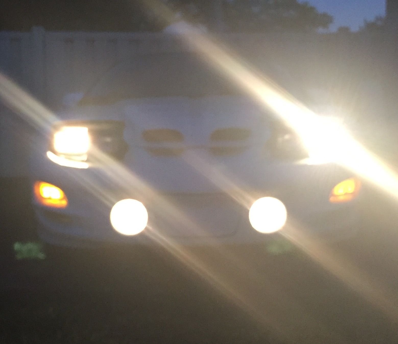

I don't think I will be changing my drl's any time soon. They look fine to me at night. I think that photo above it was too much sun light.
