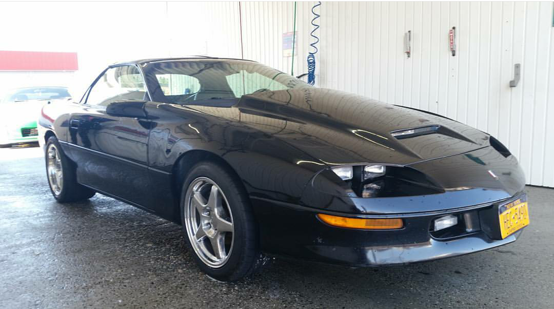

does any one know what hood this?
i have a 94 camaro and have been looking for a new hood, id love this for the extra vents for under hood temps and cant go wrong with the SS style. please help hahha

That's a super grainy picture. I can't see the hood at all maybe an ultra z? Anyway check out this link it may help you out... http://www.vfnfiberglass.com/932001camaro.htm
Mine is a harwood. It's 2.5" high. I wouldnt go any higher unless I needed to fit a huge blower or carb box under it. For street use even my 2.5" can be difficult to see over. As far as the vents I would be very carful with an lt1 due to the placement of the opti, you really don't want to get any water in the vent that could get the opti wet. You may notice a vent on my hood but it is just for looks, not an actual vent. If anything open it up from the cowl side if heat is that much of a issue for you.
