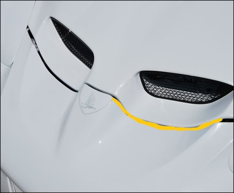

Since you switched to a formula front bumper, how much did you have to cut off for the Firehawk hood? I am wondering if it is just the flat part that is cut for this hood. I have no idea and no Firehawks to look at. I am going to have to hunt down a Firehawk hood and cut my bumper for it since it's been 2 years waiting for a superhawk hood that I paid for and still not here and that's the closest hood to it.
Thank you,
-Mark jr.

Ill see if I can find any pictures. It is pretty simple to cut with a dremel. You have to buy the firehawk badge/plate/emblem whatever it's called that sits right in the middle of the nose because it fills in a gap between the bumper and the hood.

I appreciate any pics of this that you may have.
That is not what I wanted to hear regarding the badge, was hoping I could cut it close to not have to use that, but I will know better with some pics. I just saw those badges on eBay for I think $250, so I may make my own assuming I can find a hood locally.

Pretty much let the hood rest on the bumper. trace this line where the hood hangs over the bumper and trim it back.

That is some good info. I understood it all wrong. I thought that the only part that required trimming was the point directly under the Firehawk badge and that the badge filled a gap. Didn't know that the entire from nostril edge to nostril edge needed to be modified.
I figured that that flat part on the bumper for a normal hood where the badge goes was all that needed cut.
One more piece of the puzzle. Thanks again for the pics

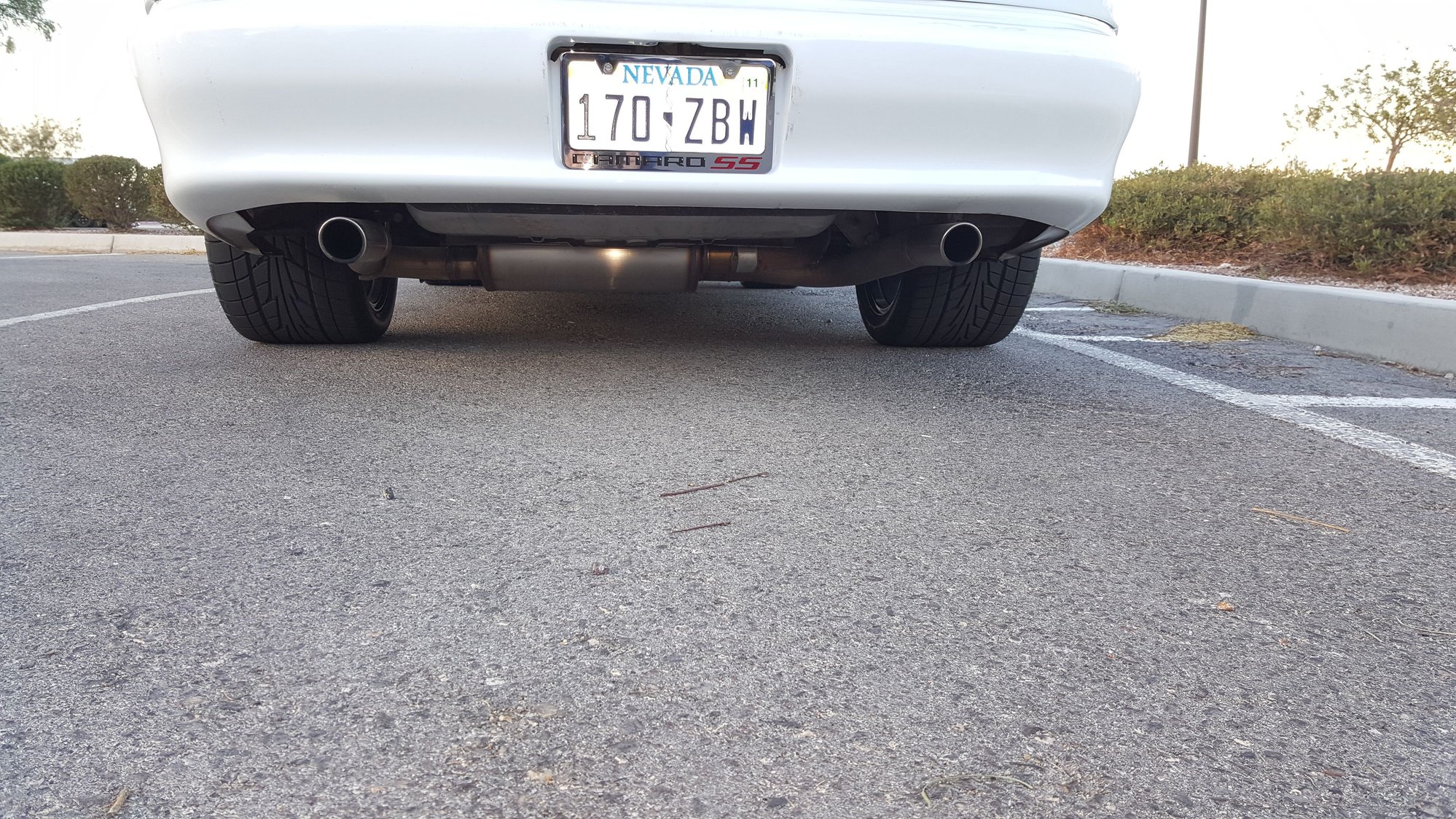

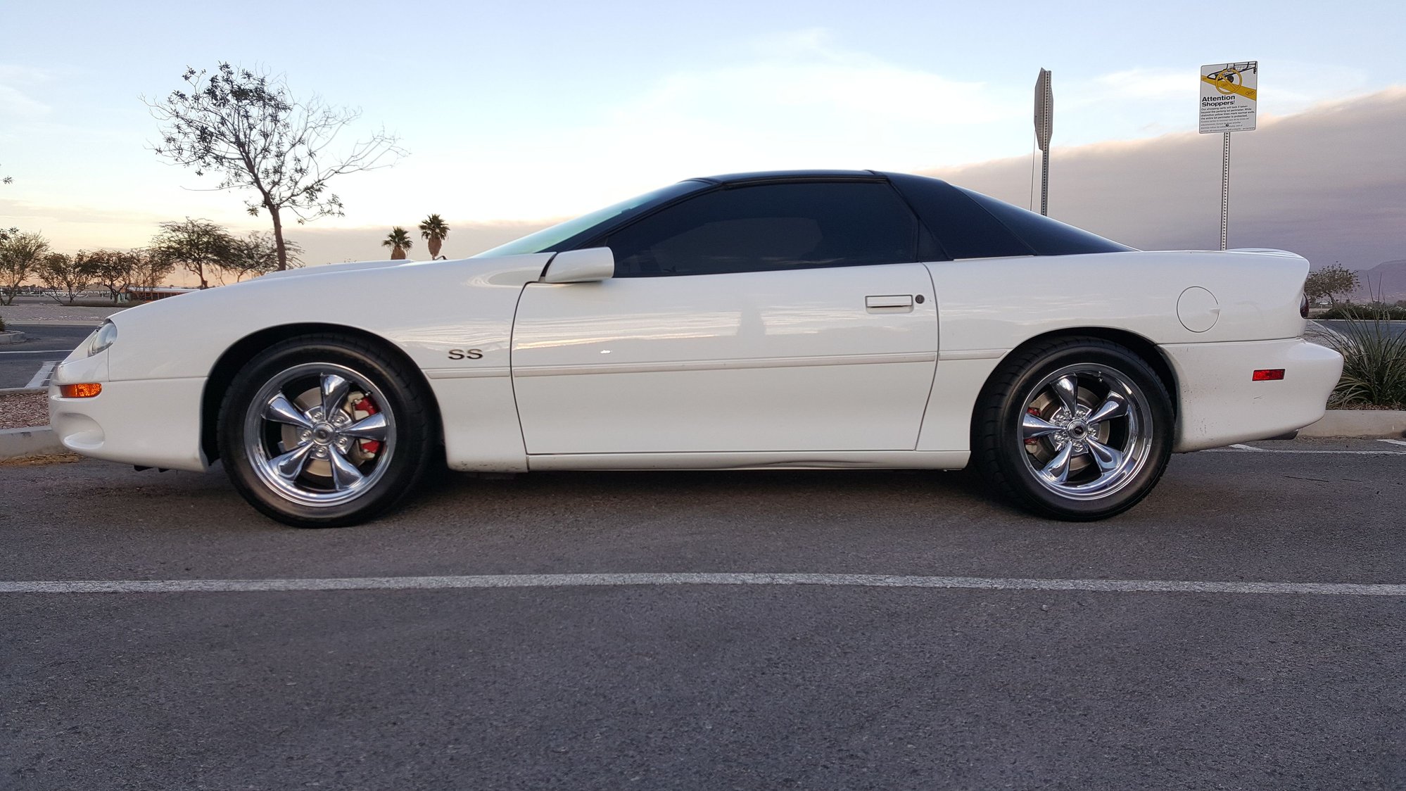

Originally Posted by DopeFedZ
Had a little down time before work yesterday so I snapped some pictures of the completed car. Picked this up as a roller a few months back and I have been working on getting it finished. It has been a fun project now I finally get to enjoy driving it.
Very nice! No matter what anyone says about your tips, I like them. Here's mine. Thanks!
