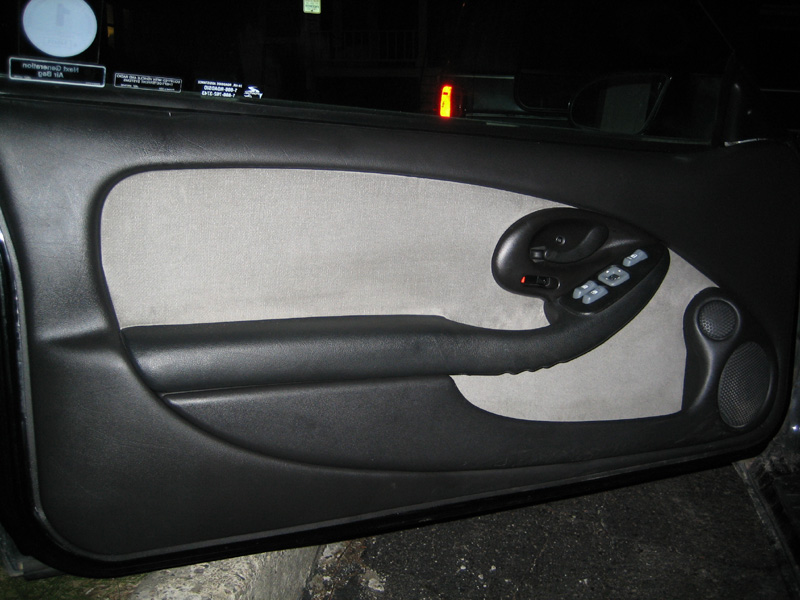

The bigger /rounder tabs in the center are hollow. You can drill a hole in the middle of the round tab and use a screw and washer to re-attach the panel. The edge ones, you can use plastic epoxy on the heads to reattach the panel. For some around the edge, you can put a thin screw sideways through the tab that sticks up to help hold it all in place.
I used a combination of epoxy and screws.
I don't have a pic of inside the door, but there is what it looks like on the outside.
