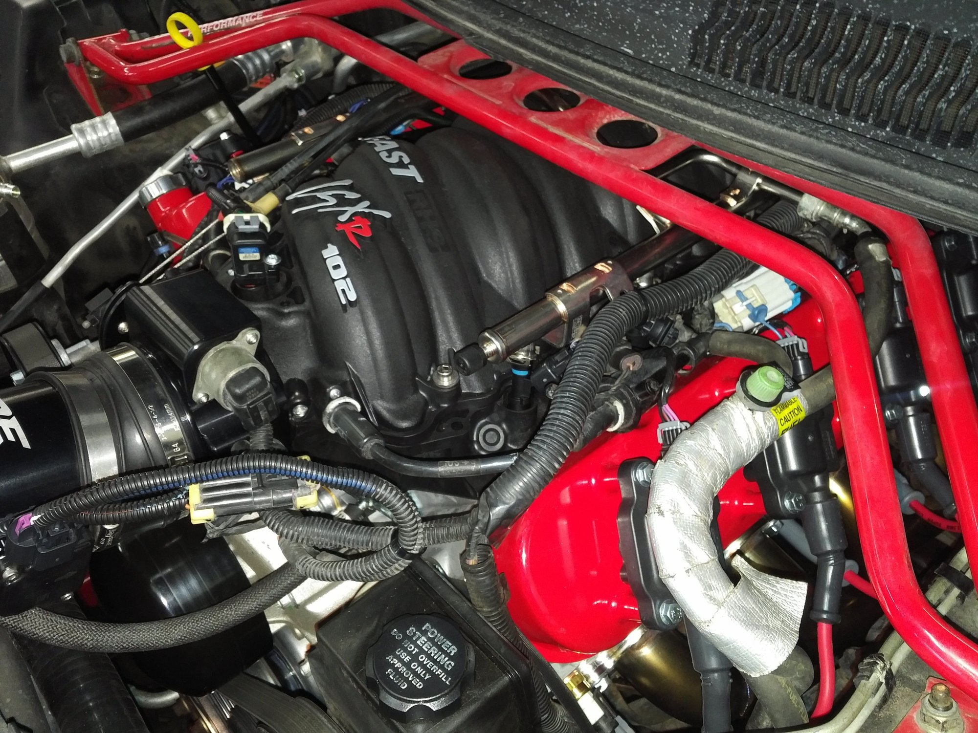

Originally Posted by Craig Chamboullides
Yeah I had one but it won't clear that 102 intake
The Hotchkiss STB will clear the LSXR 102 with a couple of spacers to lift it. This is my 99TA with the STB & 102 LSXR on the 416.

Love those valve covers man. Good looking setup and thanks for the info.
