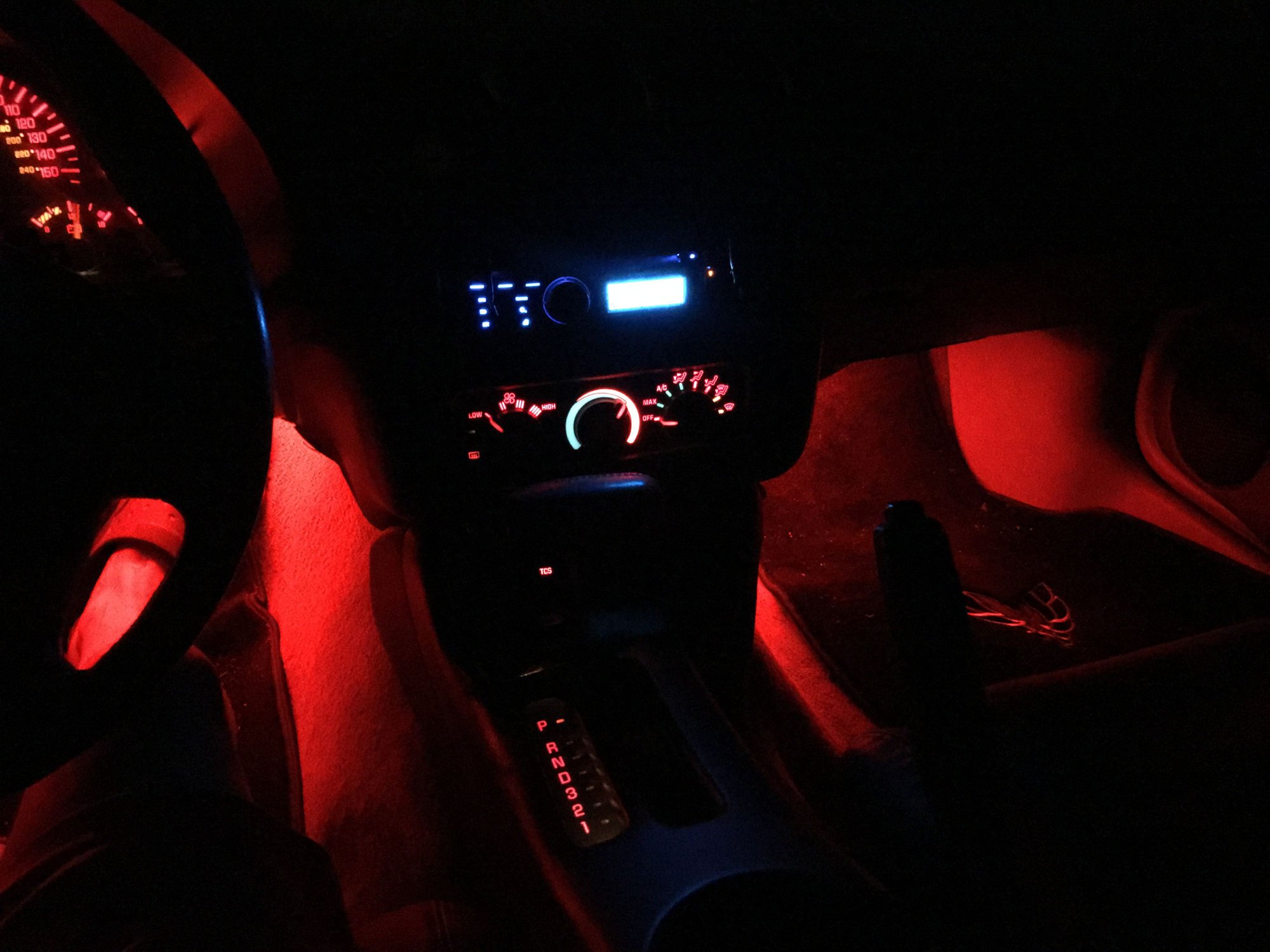

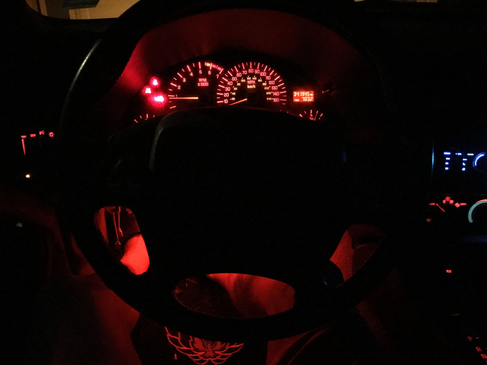

So today I was kind of bored and had been wanting to do this for a while. It was such a simple job. I used a 4 foot piece of LED strip lighting and it's wired to the dimmer..... so I am able to dim with the gauges. I also have a remote and can change the color if I like with the IR controller. If you've ever thought of doing it, it's cheap and easy!

Sure. In a nutshell, the LED strip light has an IR controller and I soldered the positive side to the right side of the 5A fuse post for the dimmer and extended the negative to one of the ground locations behind the brake pedal. The LED strip is around 4 feet and I simply taped it up the vent on the passenger's side (with packing tape) and looped it over cables on the driver's side. I like the idea of soldering to the fuse because I'm not a fan of cutting into my wires.

Very cool. I like that mine are wired to the dimmer because I keep my gauges dimmed as low as they can go without being off. I also like that I have my strip soldered to the fuse.

No time to learn to solder than the present! .... if you so choose. Of course that's just one way to get it done. You can always butt connectorize it by cutting into the dimmer circuit. I do love the idea to dim them. I also have the option to change colors with the remote.
