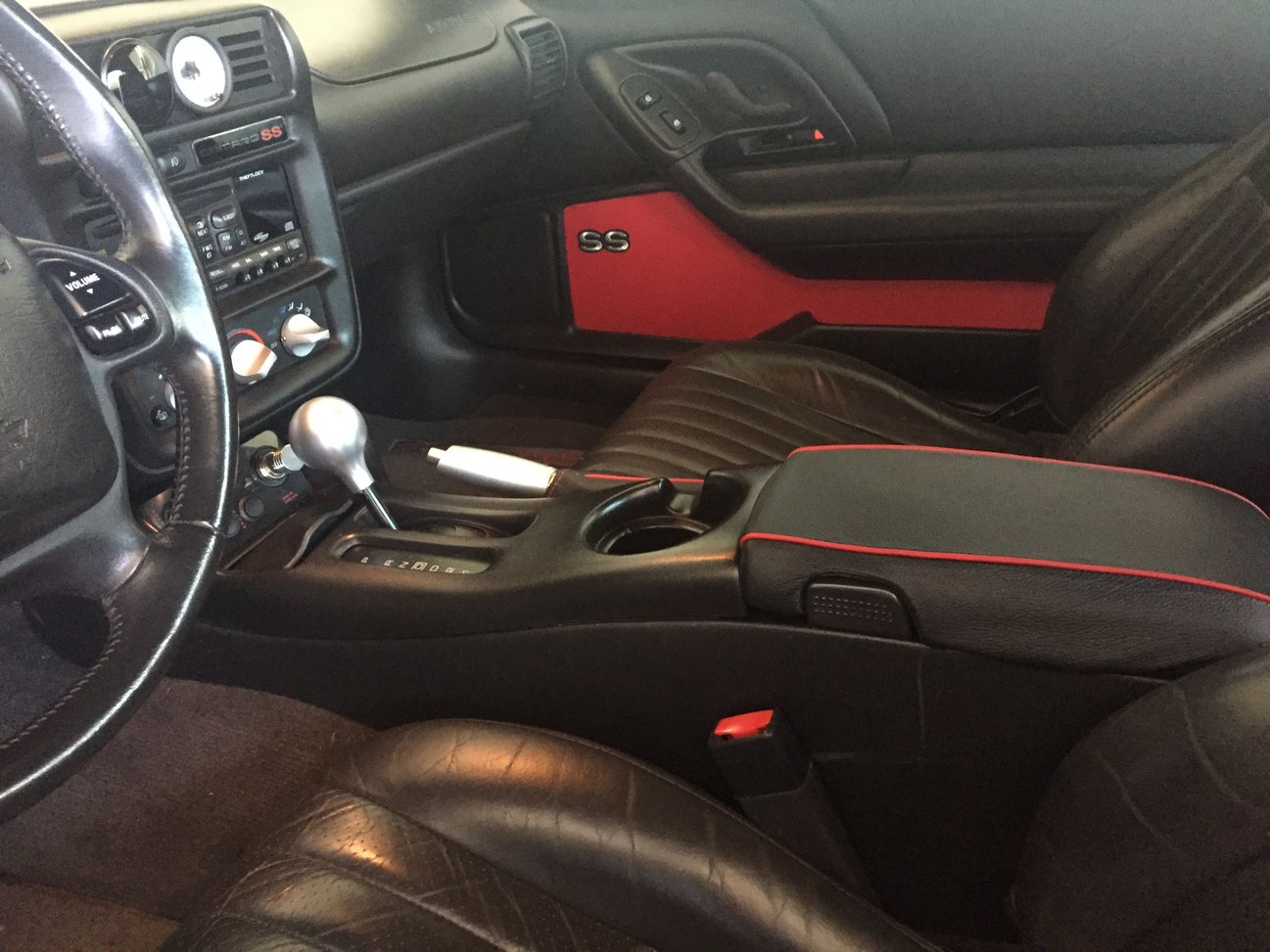

So I went back into the passenger door panel today because I got some connectors to install in my tweeters and I took some pics of the back side.
This is where I screwed the panel down. You can see where I did the plastic welding prior.
Staples replaced with self tappers.
Beautifully wrapped door panel.
