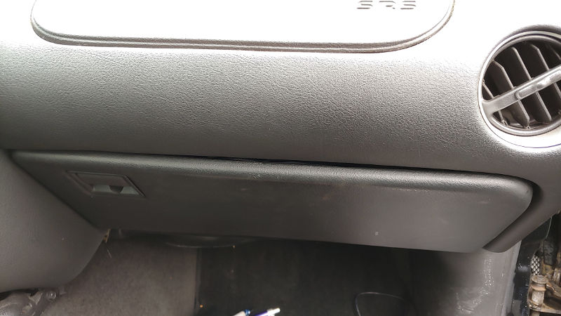

I fixed the droop in my glovebox and improved lighting in it.

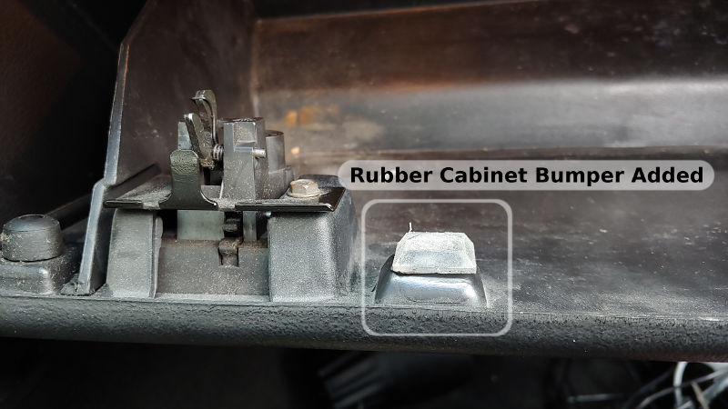

Added cabinet bumper to bump that pushes plunger to turn off the light. This makes it more reliably turn off and stay off when the glovebox door is closed.

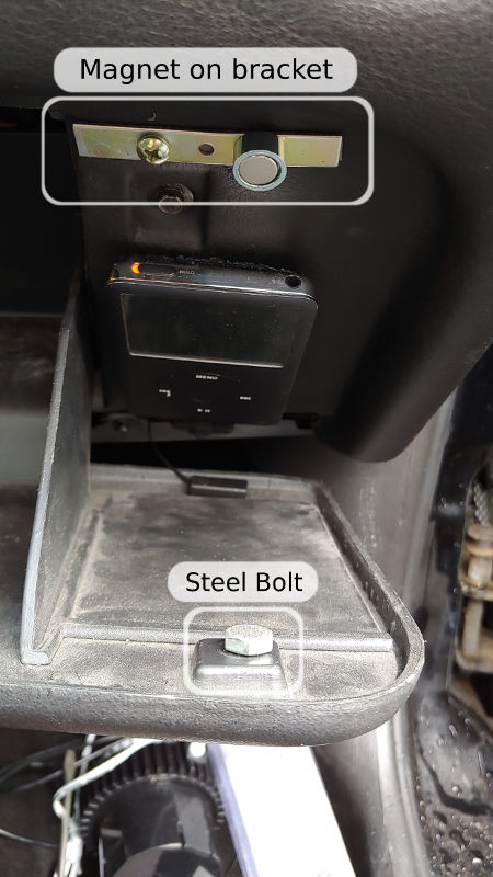

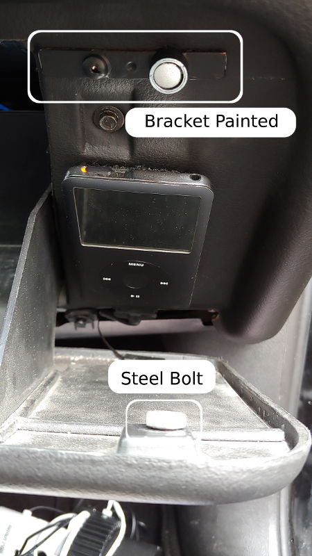

To fix the droop, I added a magnetic catch to the right side of the glovebox. I replaced the rubber bumper with a steel bolt and mounted a magnet to the dash directly above where the bumper would strike. However, there is no plastic or metal exactly where the magnet needed to be so I to use a strip of metal to be able to attach it. The magnet is screwed to the metal strip and the metal strip is held in with 3M Trim Tape and a screw. The screw ties into the plastic behind the dash cover in that spot. I'm thinking of painting the bracket black because its not the prettiest right now.
That ipod is an older one that has been in the car for years. A few years ago, I swapped out the hard drive in it to an SD card via an adapter so I'm not worried about the magnet being two inches from it.

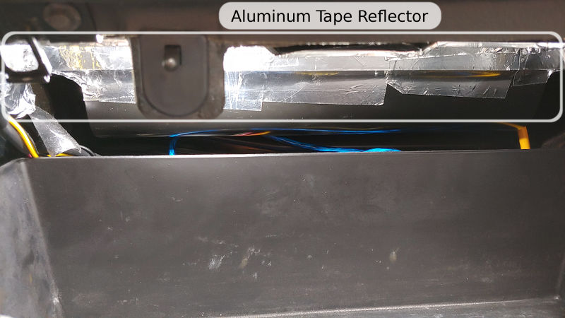

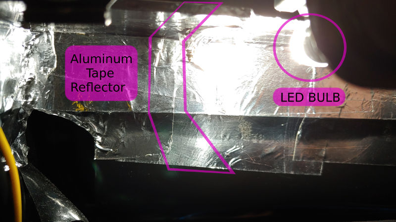

I replaced the bulb with an LED and noticed it was aimed towards the front of the car away from what's in the glovebox, so I used aluminum tape to make a reflector to reflect the light back down into the glovebox.
The reflector may not be the prettiest, but its also not particularly visible from the seat especially with stuff in the glovebox.
