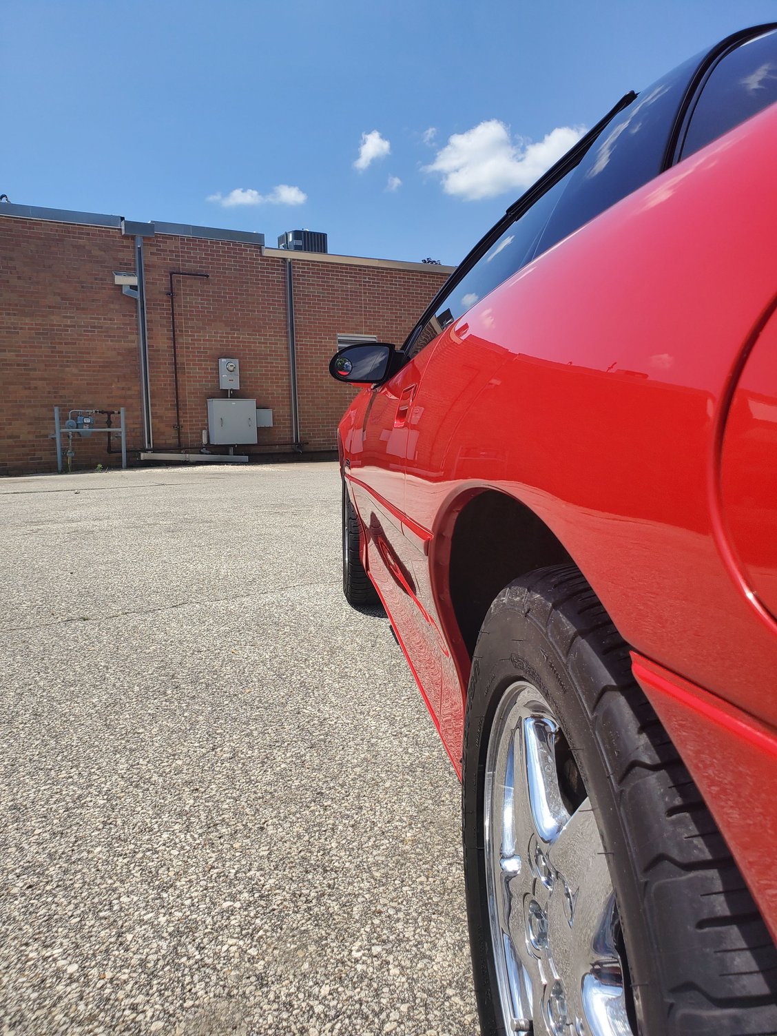

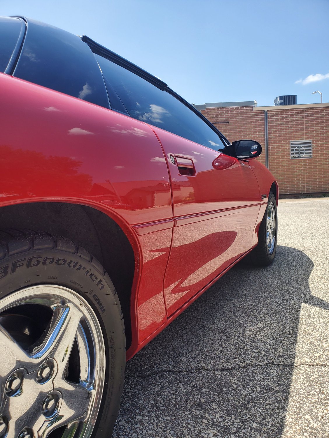

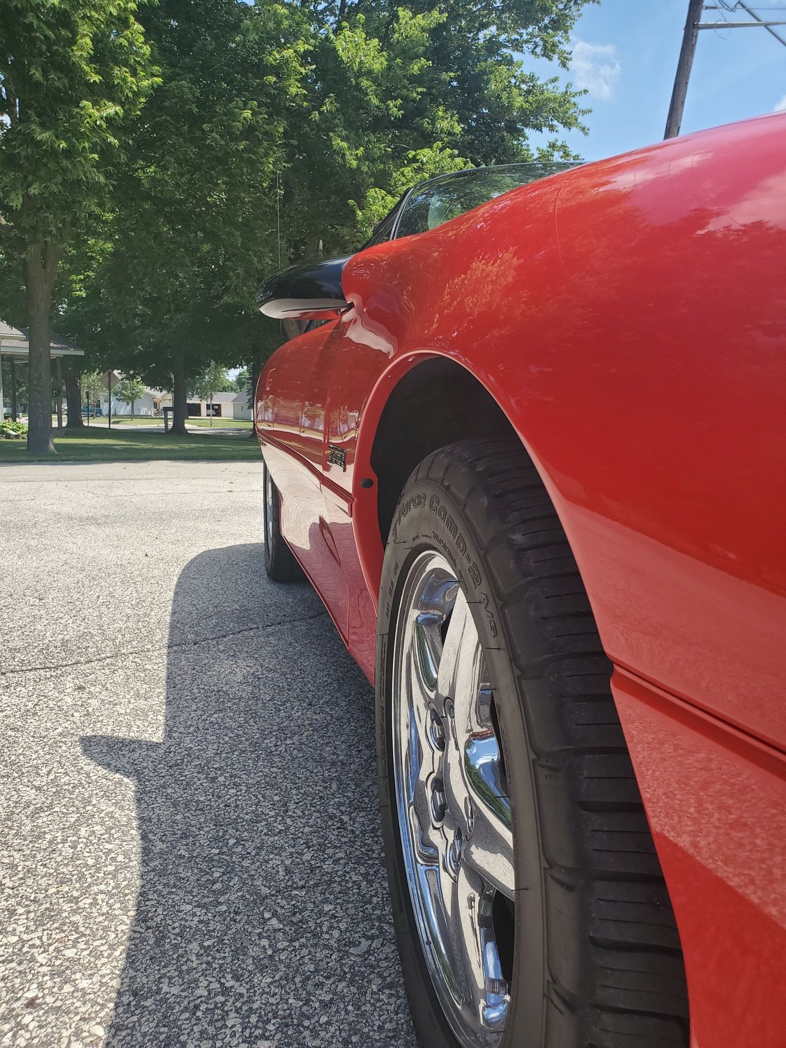

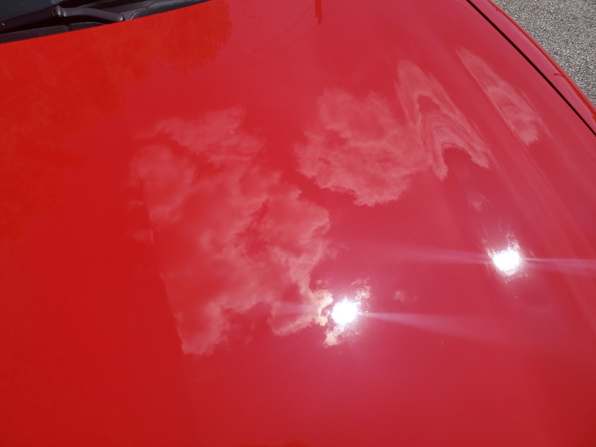

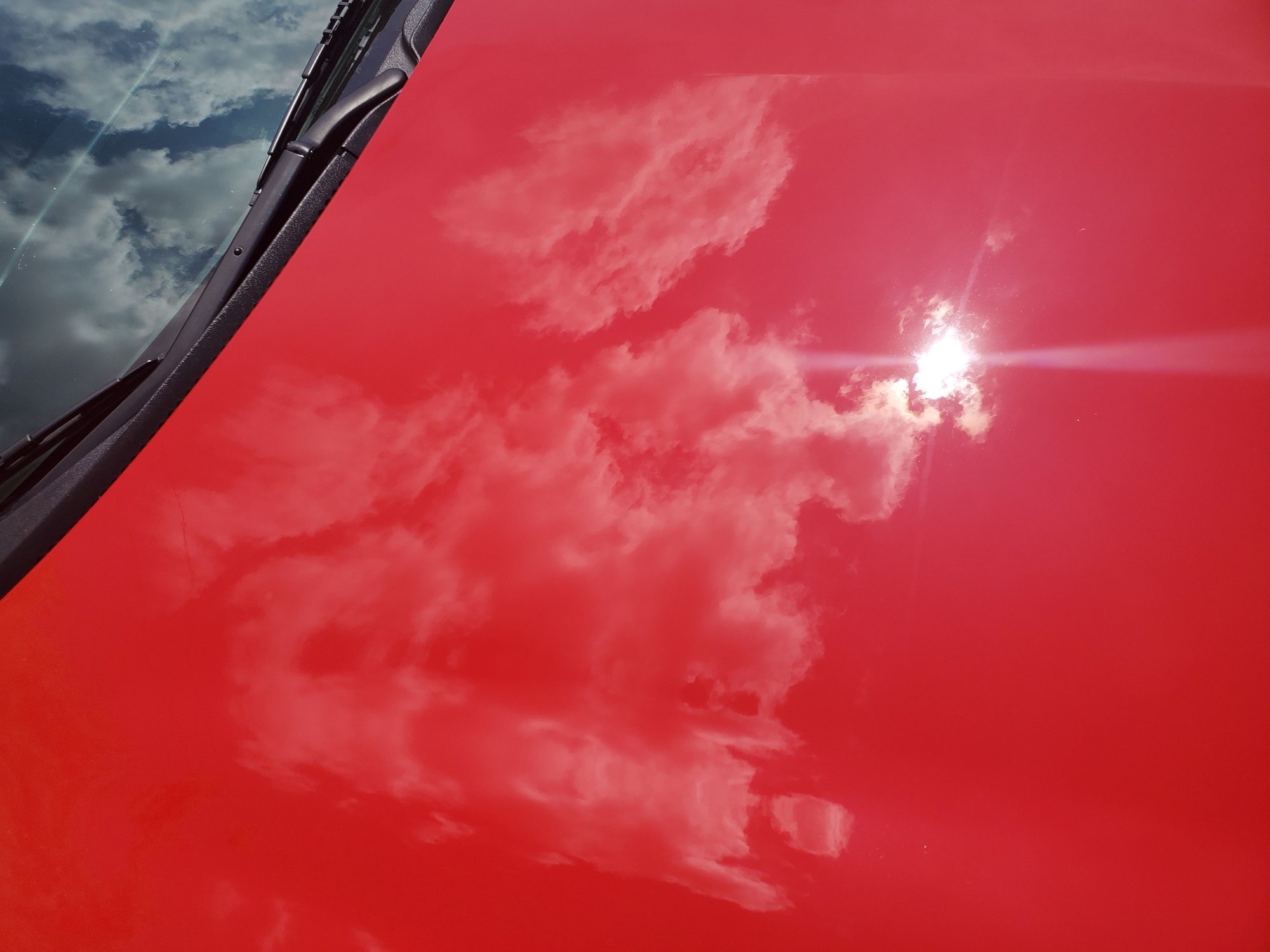

For those who stumble on this thread I used the following items in no particular order: Bauer 1814E DA, 5" Lake Country backing plate, Buff and shine 5.5" green foam pads, Carpro ClearCUT, Carpro Essence X-treme Gloss Enhancer, Carpro Eraser Intense Oil and Polish Cleanser, Carpro Trix Tar and Iron Remover, Carpro Reset Intensive Car Shampoo, Carpro CQuartz Lite Kit, 16x16 Chinchilla microfiber towels, Speedmaster Clay Towel, Carpro Immolube, Supreme Micro-Chinille wash mitt.
