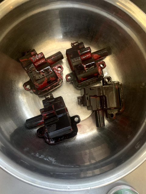

Has anyone stripped painted coils before?
I've made the mistake of forgetting to use primer first and after the first coat of caliper paint they look terrible...
I'm hoping to get them stripped before the first coat cures...
Luckily I had only painted half of them...
I went with a quick coating of brake fluid. Seems to be working half decent.
Letting this second application of brake fluid set in for a few minutes then going to hit them with a scotch brite pad...
This was a "real men of genius" moment (not the brake fluid, forgetting the primer). Don't be like me, use primer...
These are fresh from the womb now...

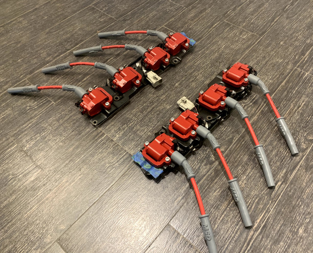

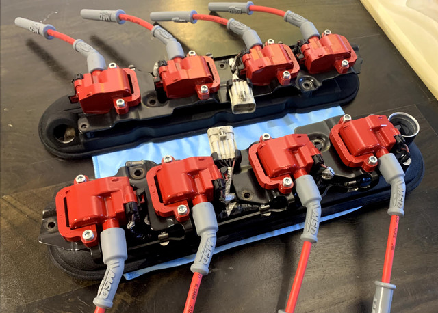

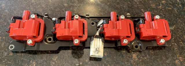

Here they are finished (primer engaged)...
I know this topic has been beat to death on this forum over the years... It's a small victory for me though...
