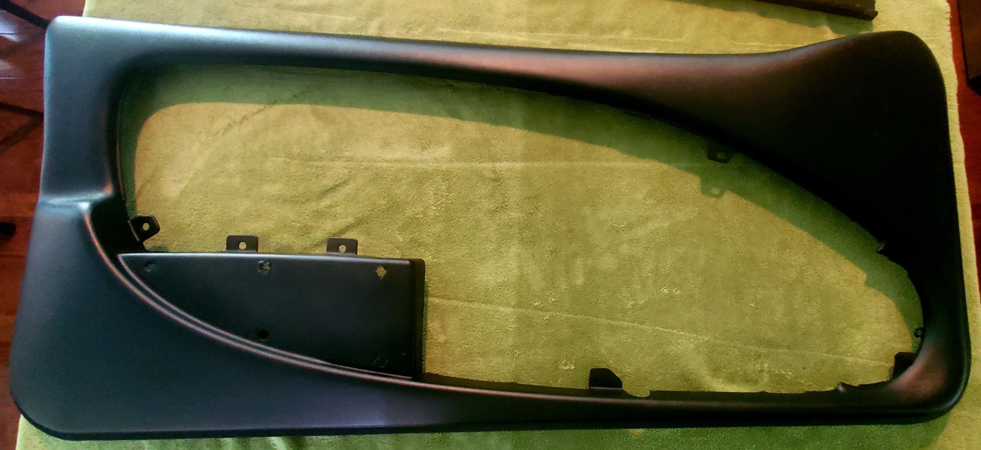

Old May 27, 2021 | 02:47 PM
Matt Salvas's Avatar
Joined: Jun 2019
Posts: 8
From: Hagerstown MD
Originally Posted by darrylzuk
I know the un-split panels are hard to come by, but dying or painting them sounds like a pretty involved process that I don't have the confidence nor time for at present. The professional route is interesting, I'd have to see what options are available locally. Good luck with you repair, I'd be interested to hear about your experience, lessons learned, etc... and also see how it turns out!
I'm currently in the process of changing my 98 interior from gray to ebony. I've been using SEM landau black color coat dye. It really is a simple process. Just takes attention to detail.
