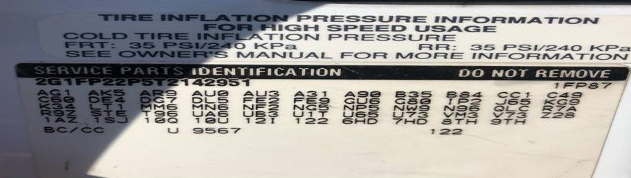

Hey Guys,
Its time to redo my front seats & I am looking into hawks interior kit-unless there is better options out there, can you guys let me know what color I am looking for from this VIN tag?
Vince

In the bottom row, RPOs "12I" and "122" would be the interior trim and seating surface, respectively (the "12" indicates color and the final "2" indicates material, should be leather).

Is the color named Graphite?
