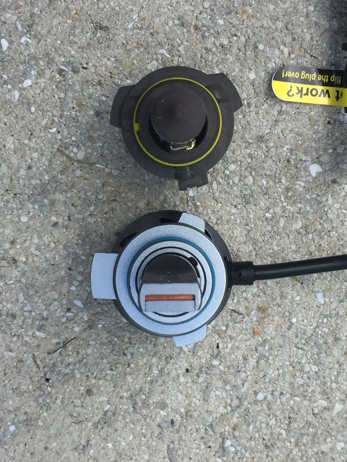

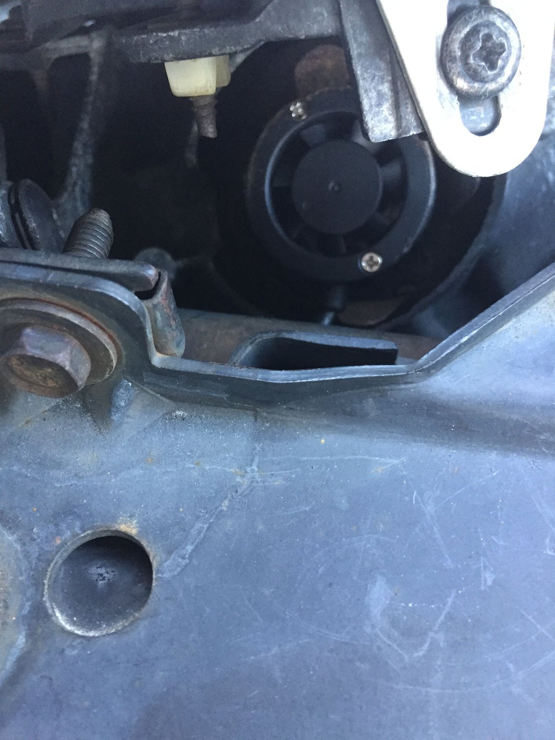

I exchanged the old lamps for new. Easy swap. They do fit, and lock in, though not as tight as the halogens. The tabs are slightly smaller on these. LMC truck housings, by the way.
The challenge this time was getting the end through the hole in the bucket.
The LED passes through okay by itself because you can maneuver it. The wire from the LED is on the side (obviously because of the little fan on the end) and this prevents it from going straight through when mounted in the housing. We’re talking a couple millimeters
All I did was take a slip joint plier and open it up inside the bucket, forcing the tabs apart.
When putting the housing back in, you have to be careful not to pinch the wire as the end of the lamp goes through the hole in the bucket.
I suppose one could grind/cut the hole wider, but I really didn’t want to go that route.
I did not secure the power supplies. They are very close to the end of the LED, so not much wire to play with and you really can't see what you're doing. I think they might be okay. We’ll see.

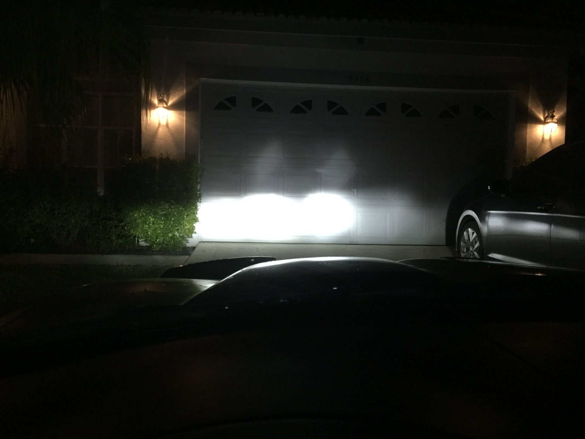

Here are photos:

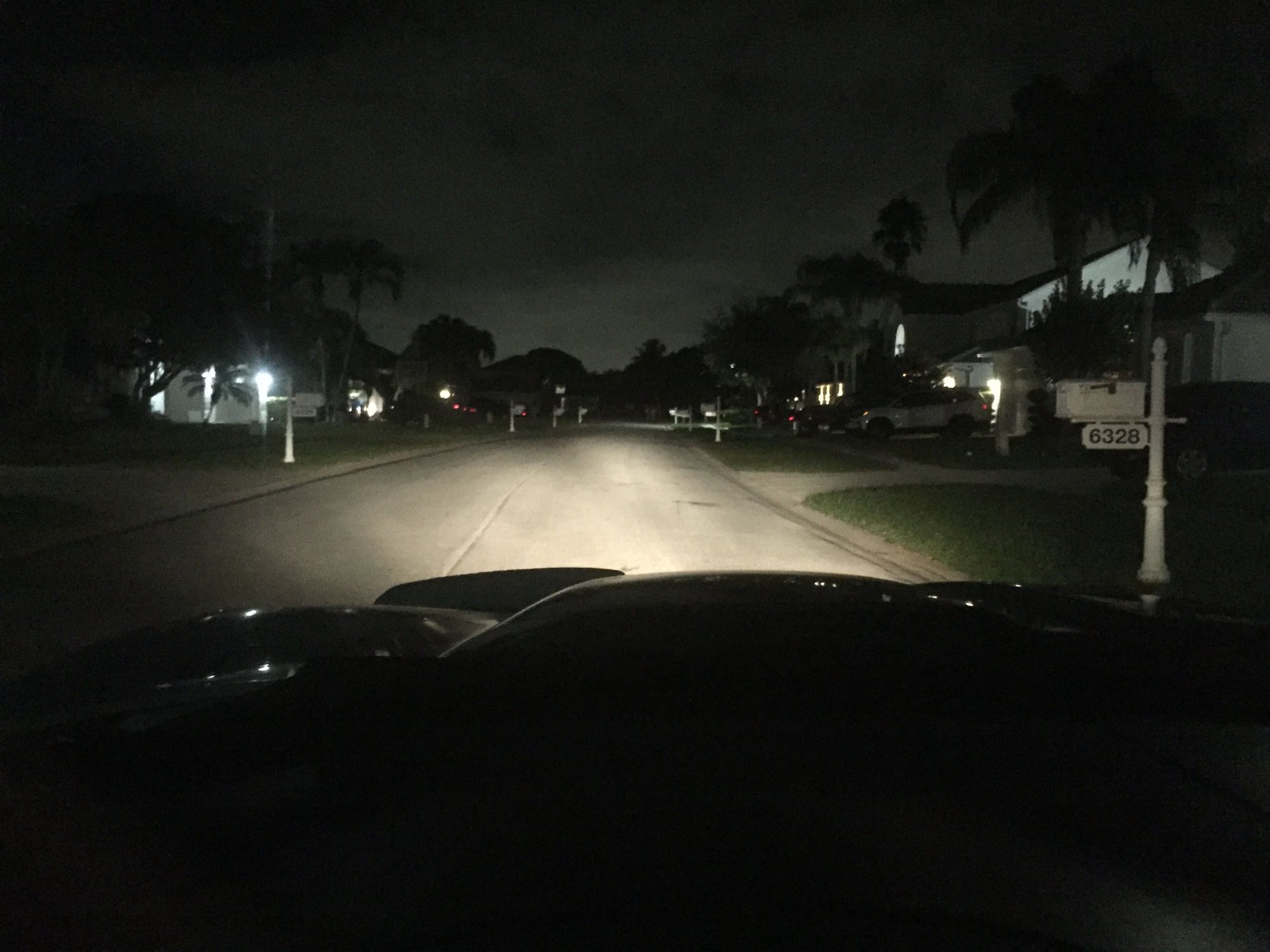

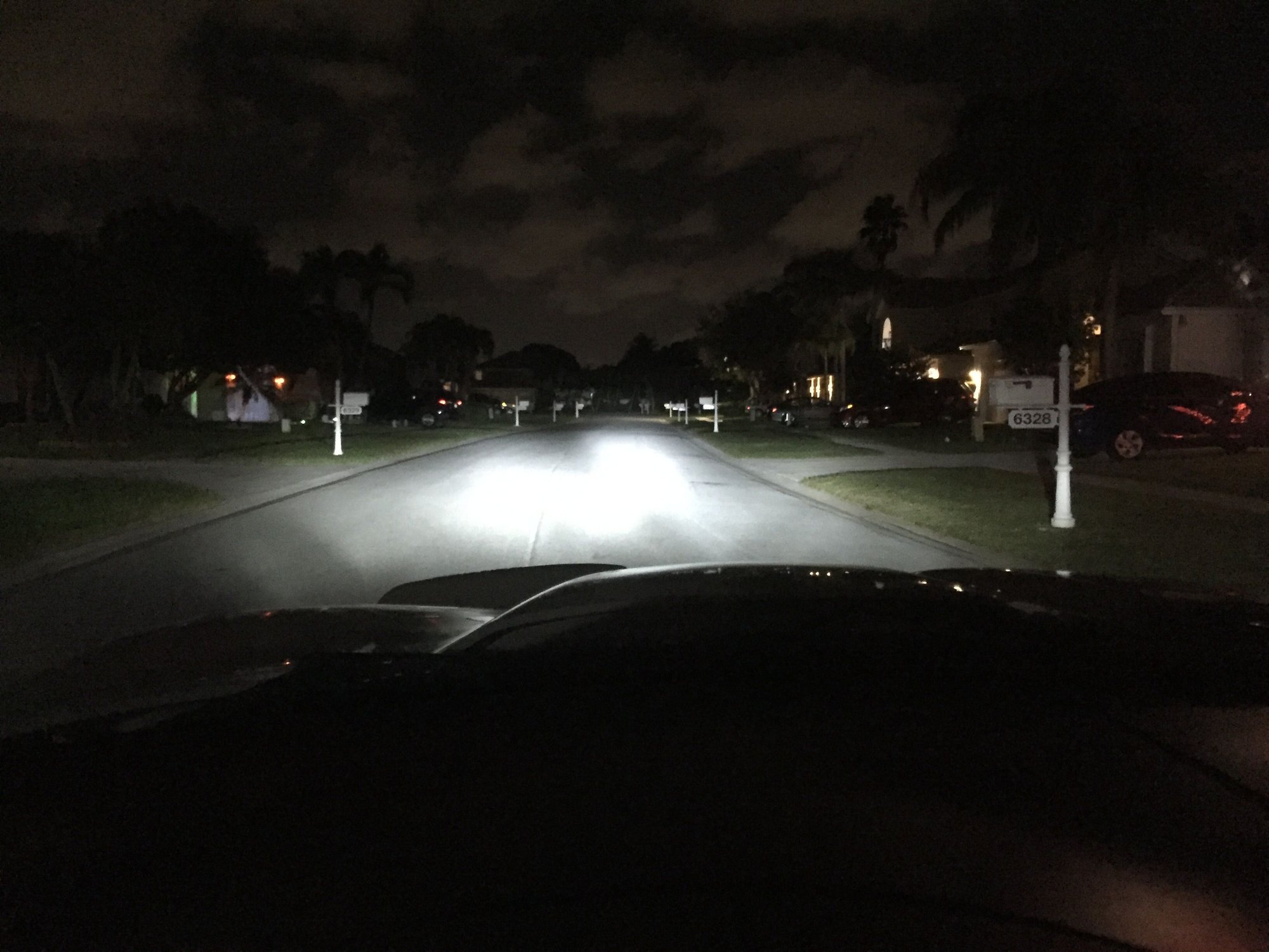

One down my street with halogens; one with LEDs.

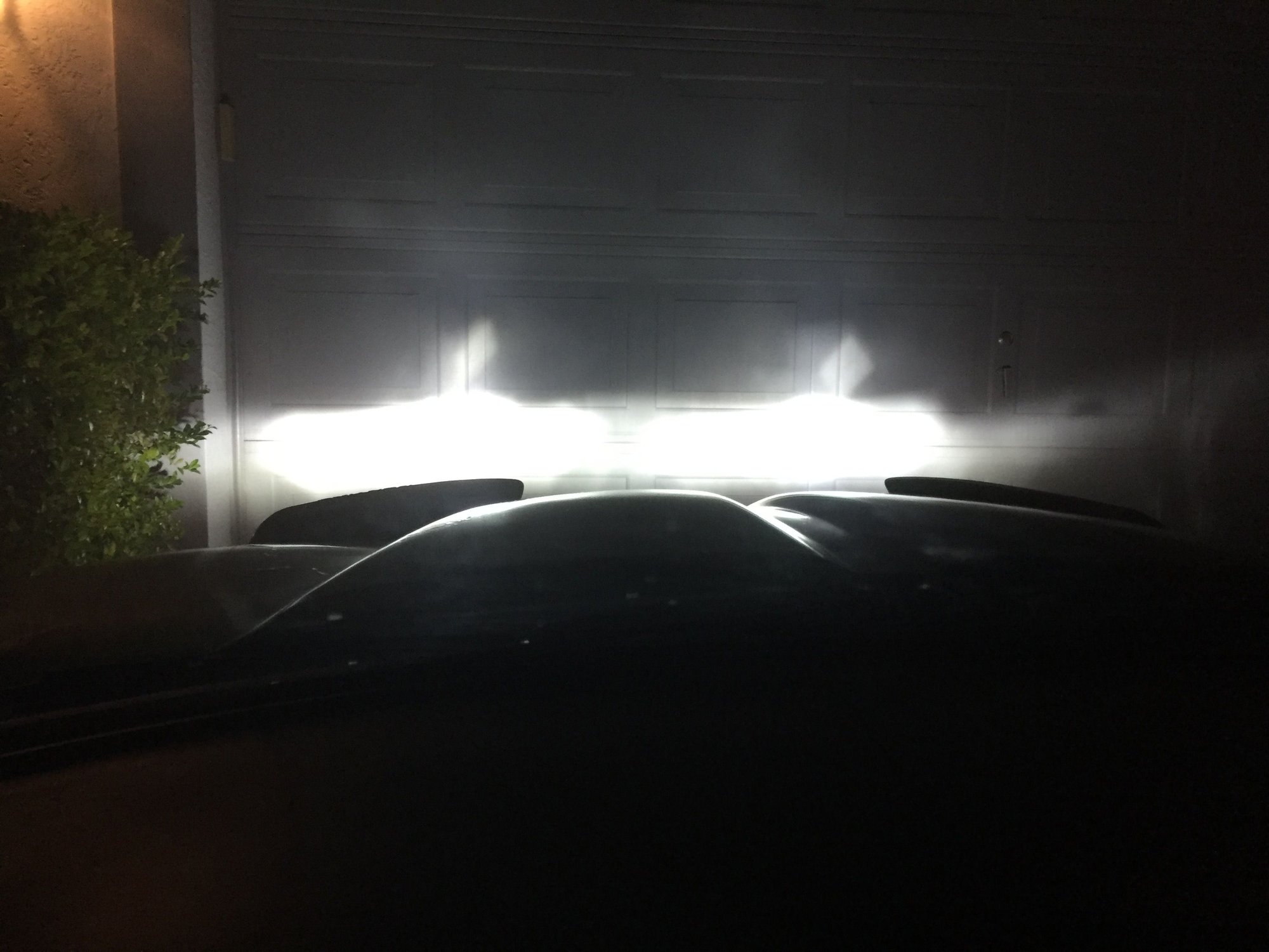

Pulling up to the garage door at two distances.
The closed headlight showing the fan end of the bulb.
I don’t think the LED necessarily lights up the road much better, but I do prefer the white light.
They do look uneven, especially down the road, but I think this is the car and not the headlight adjustment. I believe one of the lights is adjusted as far as it will go.

Doesn't seem as even as I was hoping either. It might be the size/shape of the LED contributing. I commented earlier that they looked a bit large. Unless they are aimed too low? Can you take more pics aimed at a wall at about 25 feet? The set screw might allow you to slightly adjust the depth of the bulb in the housing too. That may also help. Don't go too far and wash out the beam though.

I had done my best to aim the lights when I first got the LMCs and new lamps (watched a lot of tutorials and took notes). They've been aimed like this for a while. I don't remember which is which, but I got one on target, and the other is as far as it goes; comes close but does not match. Do you think they're too high? I'll try to find a spot to take pics one night after work.

You'll have to go someplace level and aim at a wall 25 feet away to check aim. I can't tell if they are aimed right from those pics. at 25 feet, they should be aimed straight ahead with a 2 in drop from center measurement of headlight.
