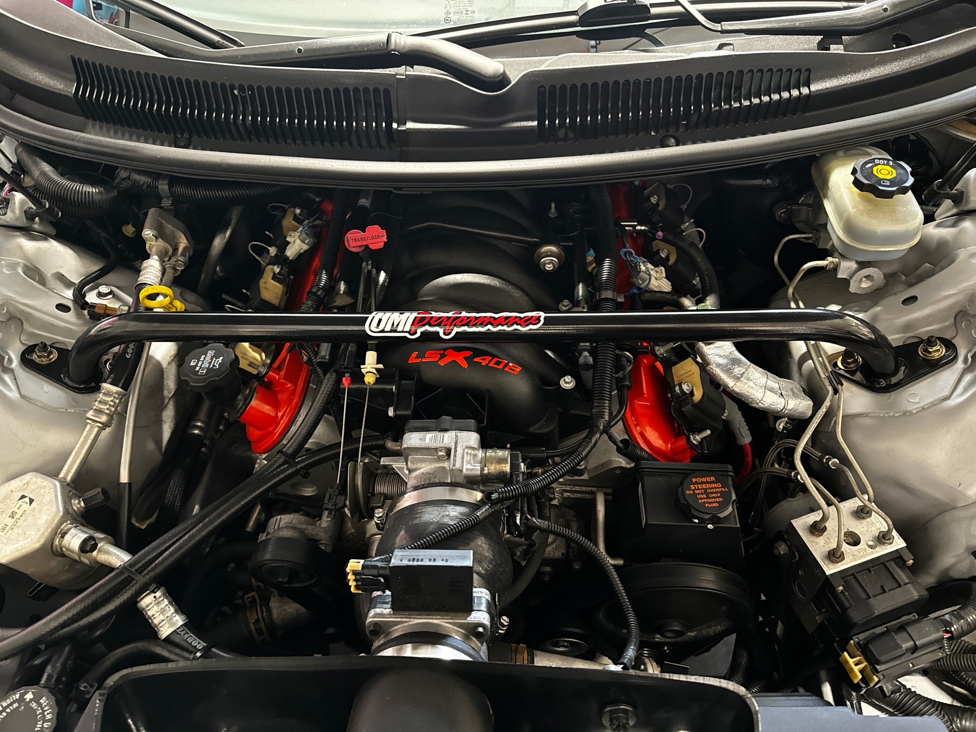

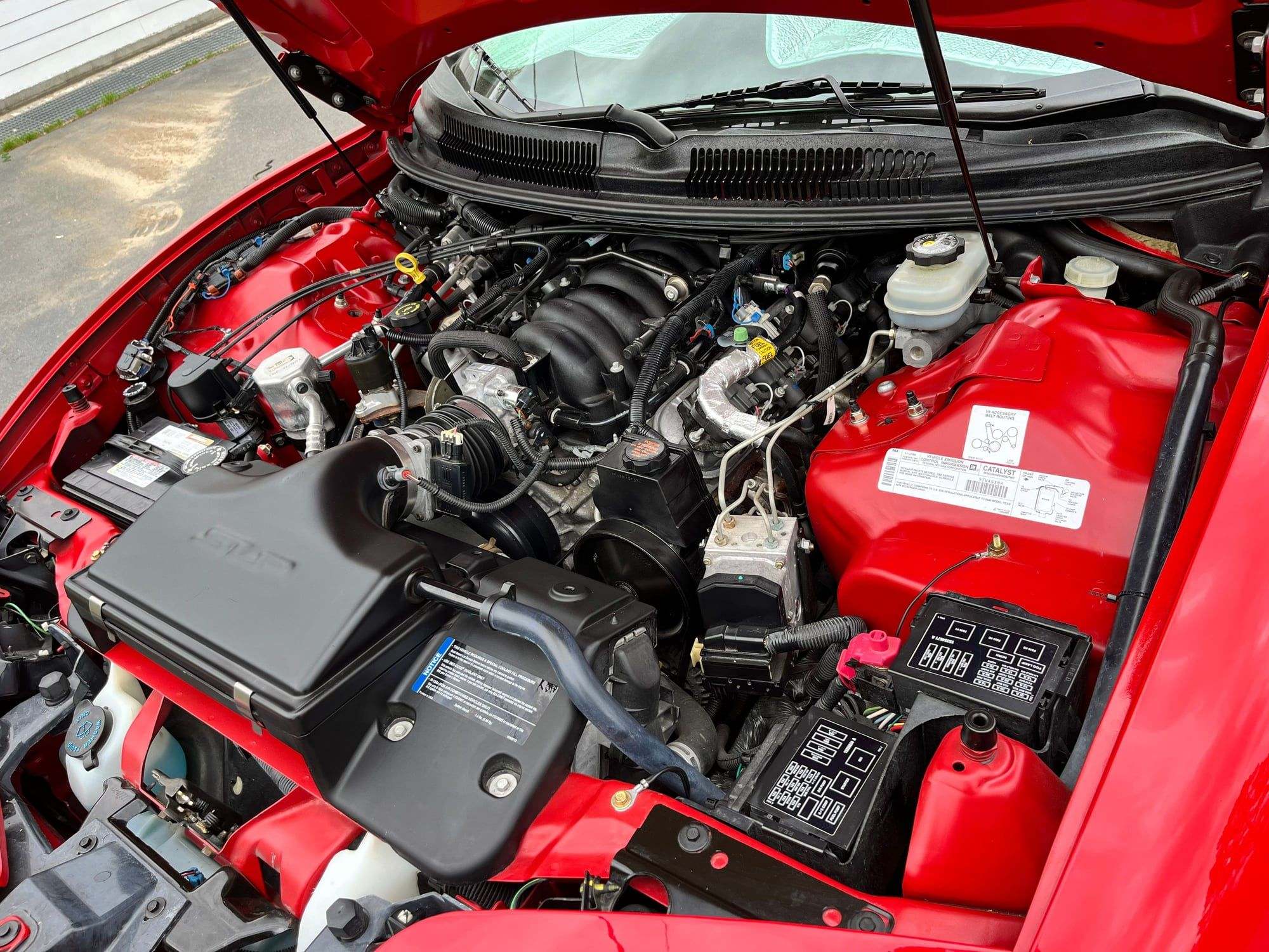

For reference, I bought two of my four LS1 F-bodies brand new, so I can personally attest to the fact that they came somewhat glossy from the factory. Here is an image of a super low mile, original cowl trim panel in factory-mint condition. As you can see, it's not super shiny like the painted exterior of the car, but it's not matte either:
If they were taken care of like yours and mine, they should look like that.
