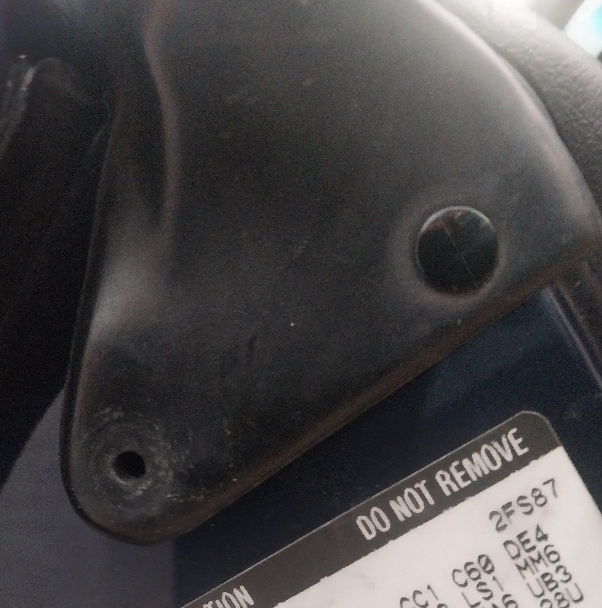

Just so happened that the xmas trees holding the rubber molding end piece on my door were missing ....then found the reason why they were missing is because the xmas trees are to SMALL for the hole in the door

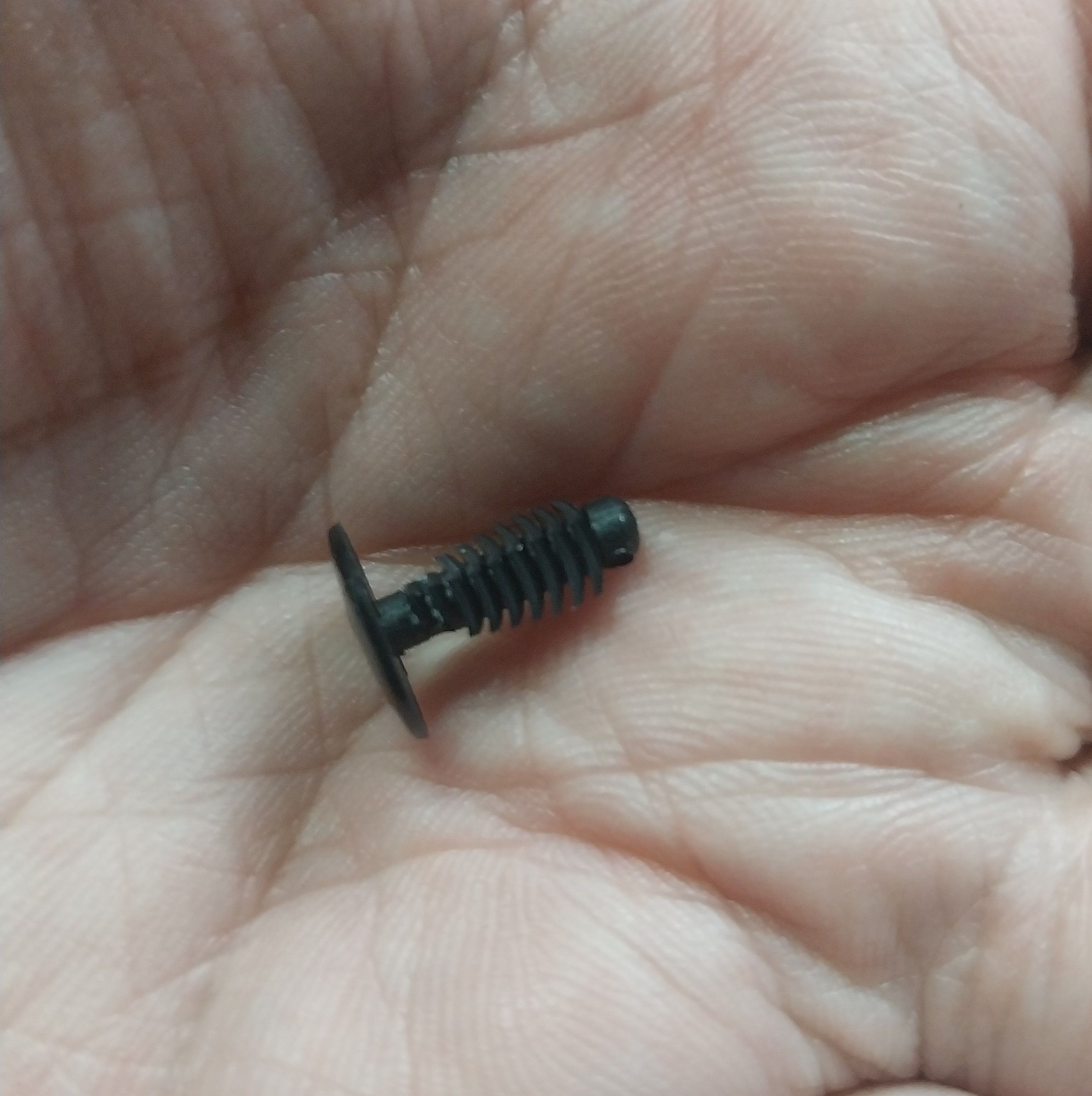

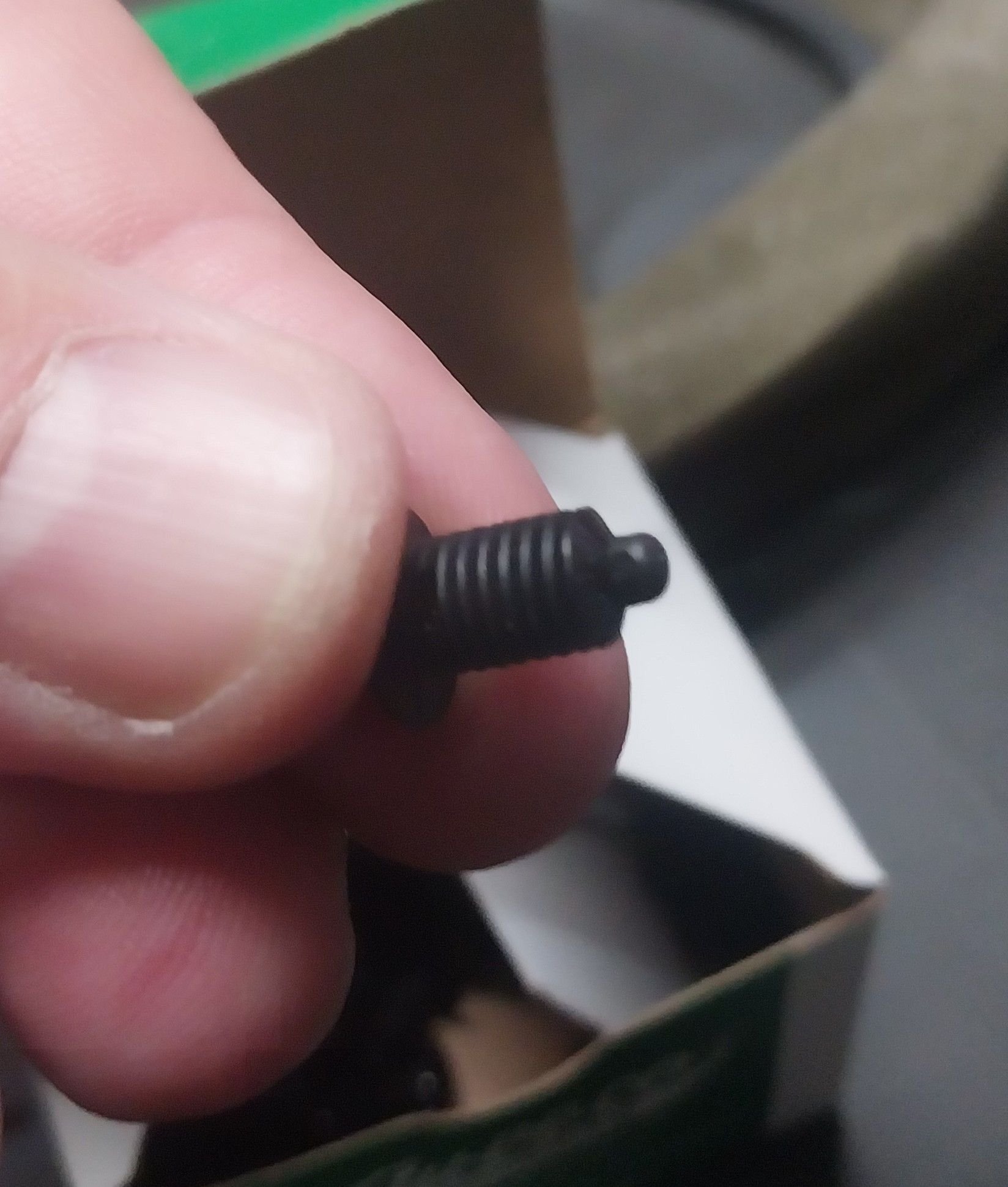

it has the correct stem dia and head dia.....but the xmas tree is a lil to thick

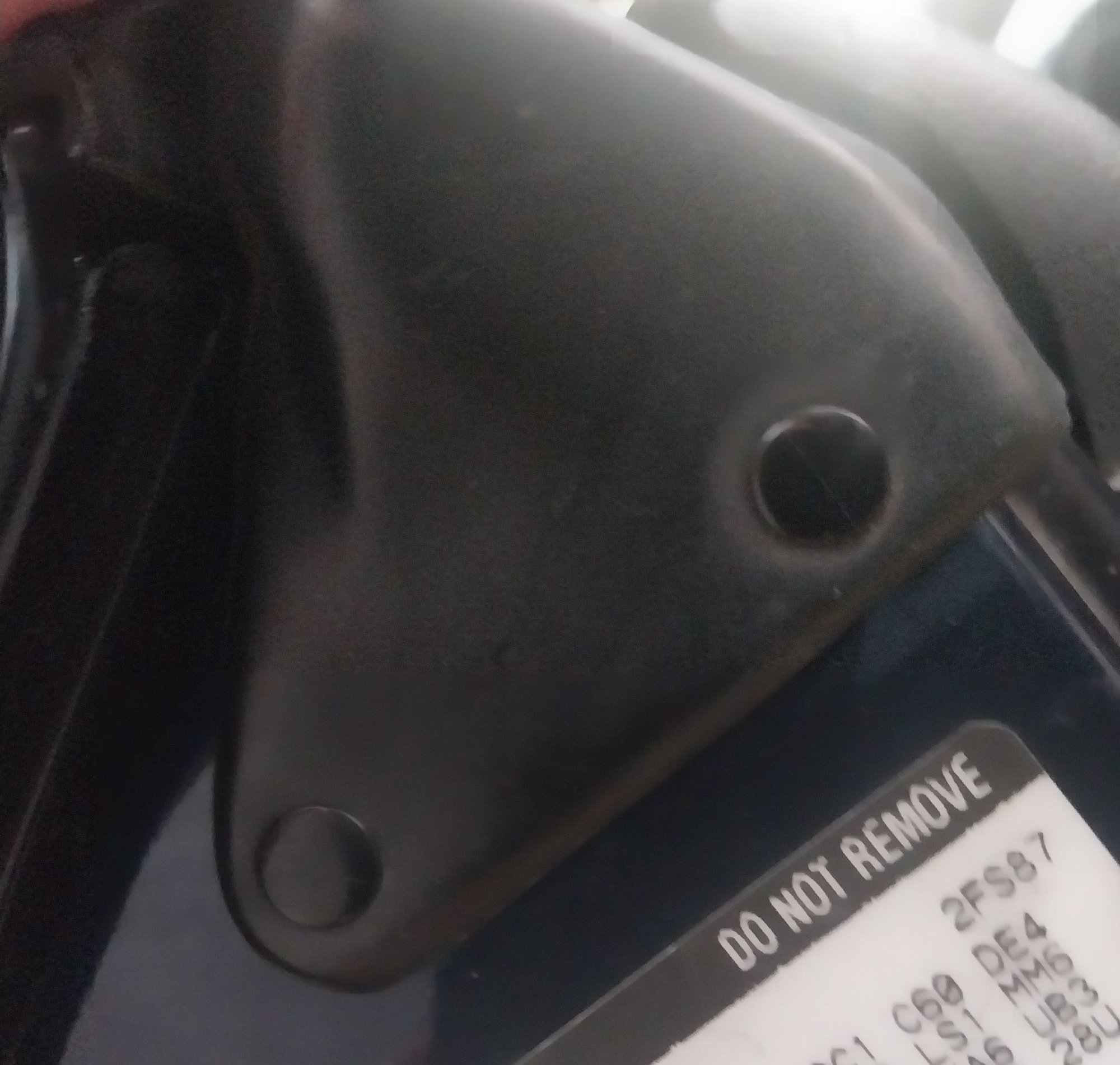

Just a lil trim with a razor blade fixes that

good find
