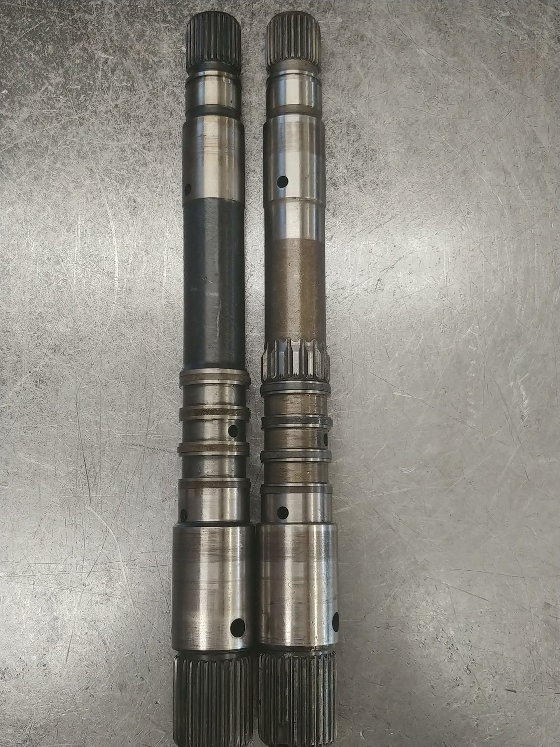

I have a 2000 S10 LS 2.2 2wd. I pulled the tranny and have this bolt pattern the one without the bolt hole in the 12 0'clock position. Why is that?

A 2000 S10 2.2L transmission has a 60 degree FWD V-6 style bell-housing, The shape is in the S10 bell-housing PDF. The picture shows the input shaft. If yours has a 4.3L/5.7L bell I don't know how you did it. Post a picture of the transmission tag...
