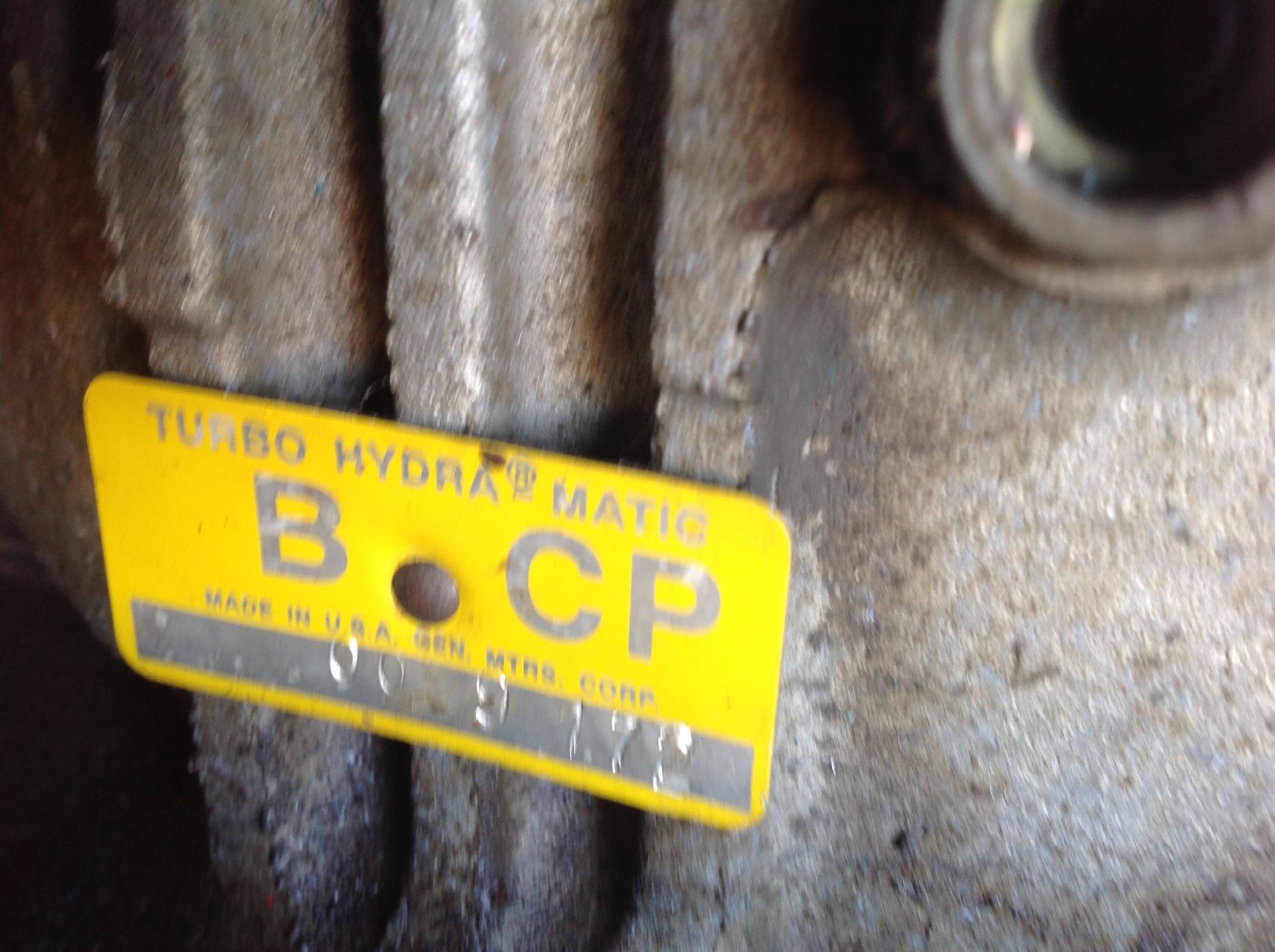

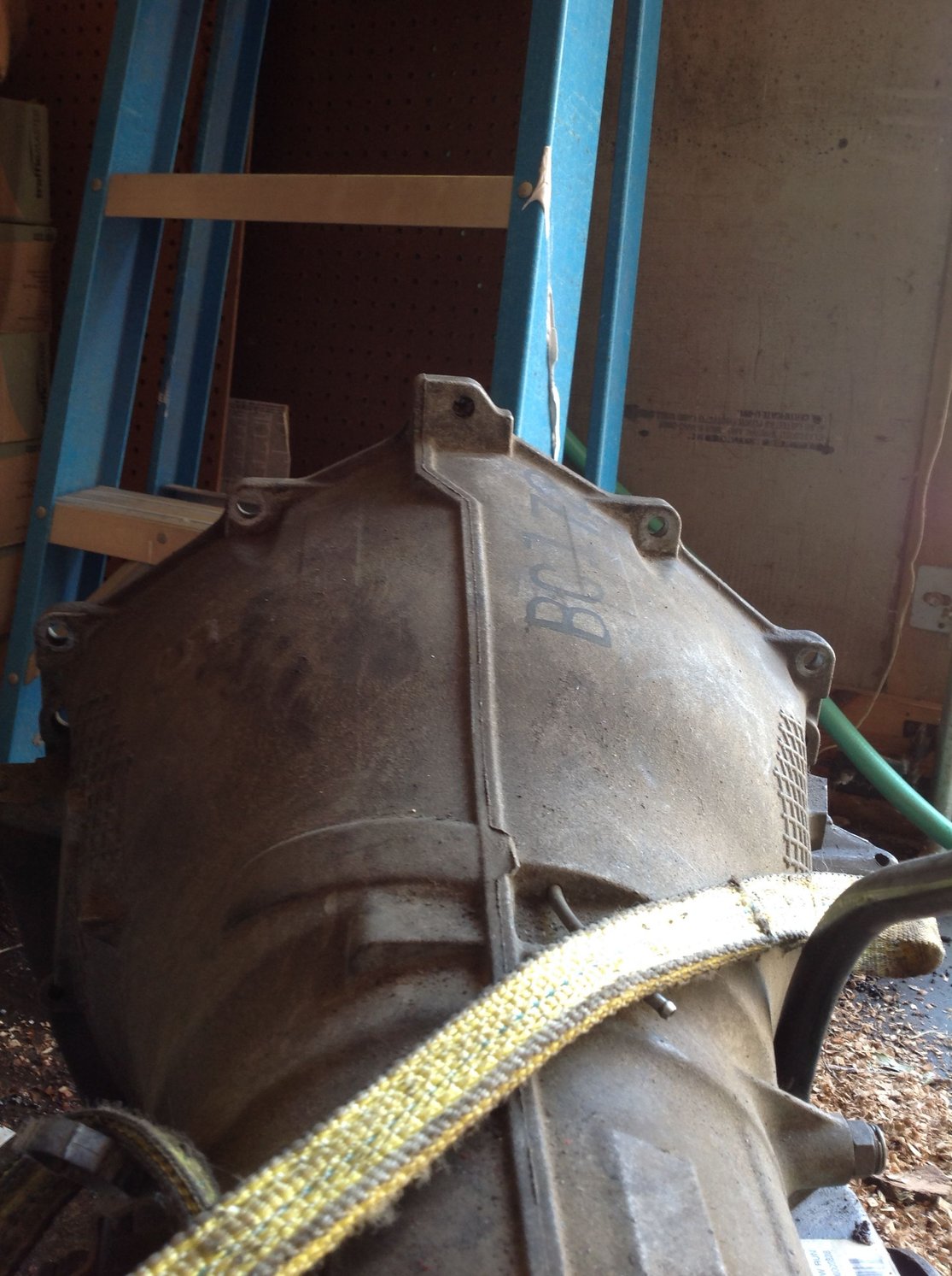

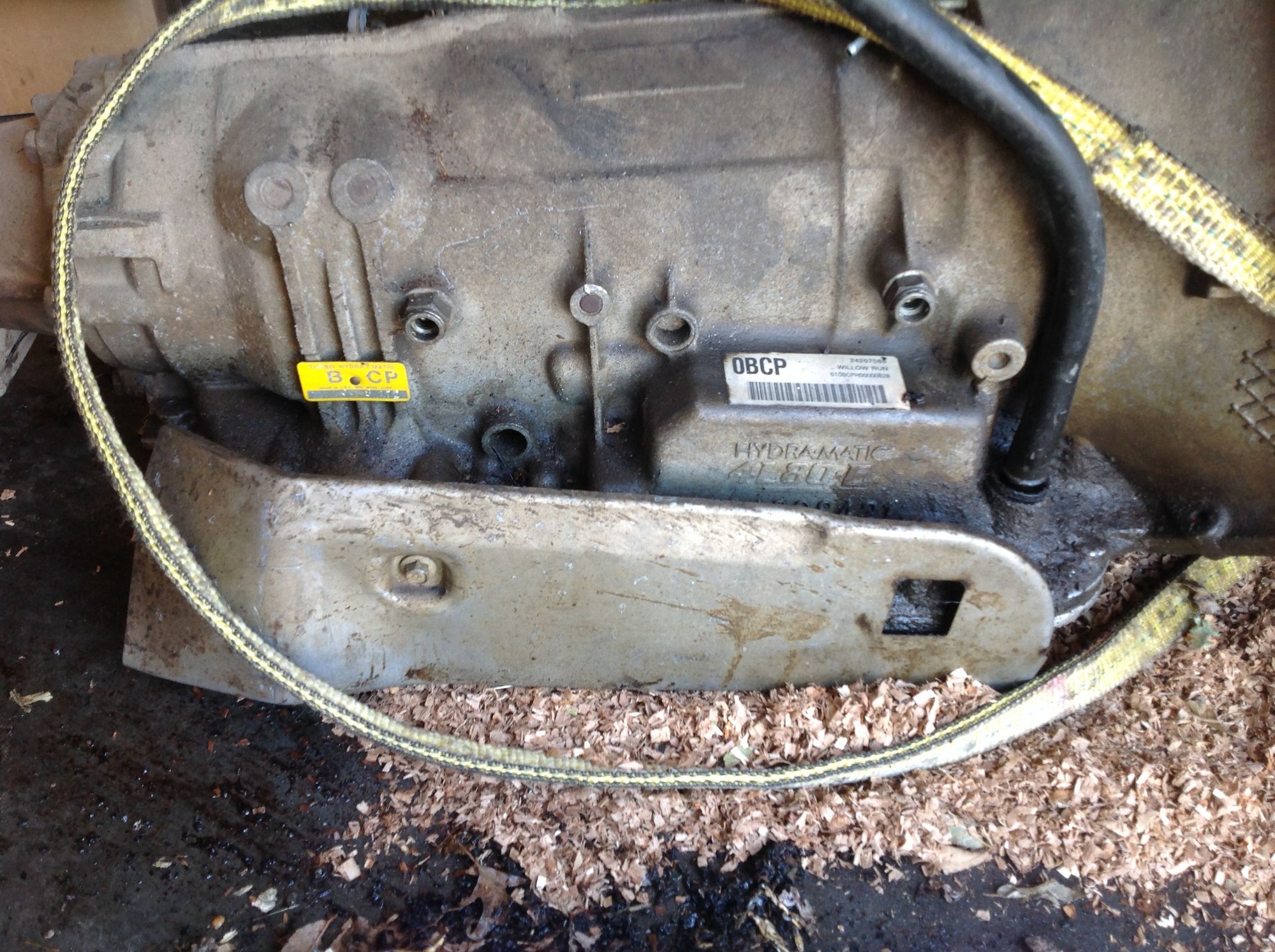

Now for the 4l80e I got but have no idea what year or what it's out of.
And my questions. Will the stock 00 Tahoe computer control this style 4l80e with the conversion on lt1swap and instead of buying a flexplate and bolts and a converter could i just use one of these spacers (because I already have one) by just drilling out my 5.3s flexplate adapter holes. (Which I read is possible in the stickies above)

Not sure about the reusing of the flex plate with spacer. You have a late model 4l80e because the cooler lines are spread apart and the it has the rear line feeding the center support. That spacer looks nothing like the LQ4 spacer they used for the 4l80e flex plate. I would say your best bet would be to purchase a 4l80e flexplate with spacer and that should work just fine. Your PCM will control it, however you will either have to segment swap in HPtuners, or change the vehicle to something that came factory with a 4l80e. I swapped from 5.3 4l60e to 6.0 4l80e, and ended up just reburning my 411 pcm to a 2002 silverado 2500 as it was less complicated because my original program was 1999 silverado. The wiring changes are very basic, but you will need to repin the PCM for the new speed sensor. Tons of data floating around online.
Not to mention the 4l60e torque converter bolt holes are way different than the 80e, unless you had a conversion converter.
