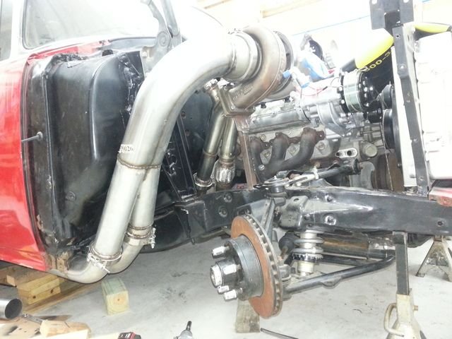

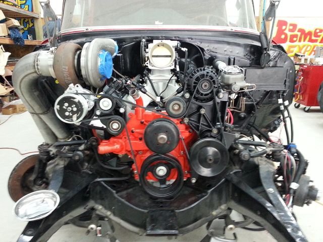

Don't know if the tunnels are similar but the 4L80 fit in my '55 210 sedan with room to spare. It's behind a 6.0
No modification necessary other than cutting the old bell housing/frame mounts off that were still in there.

Still under construction, should be running within the next few months though. Not stock though, it has a big turbo
Dam.
Wife walked in with her sexy stuff on whilst I was look looking at this ...... was a really confusing moment ....*jk*
Good cclearance to front panel on side?
Support for turbo ?

From: Orange, Texas
It would have been easier without the A/C but I'm too old and fat not to have A/C.......it's tight but clear
Turbo is supported off the frame
