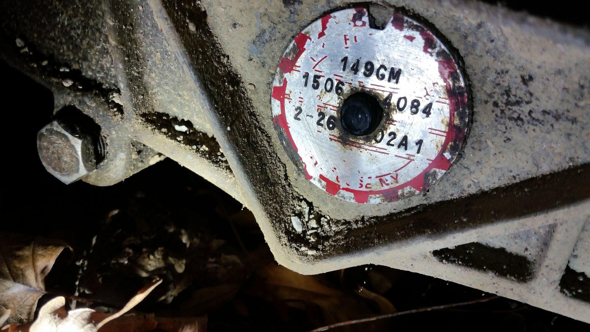

Silveradoss.com moves pretty slow so I figured I'd ask here. Just bought a 2004 Silverado SS with a bad transfer case. A buddy of mine has a case from a 2002 Escalade sitting around. The SS has a NP (or NV or NVG) 149, and the tag on escalade case says 149 as well. Any difference between a 2002 and 2004 case or good to go?
pic of the Escalade case

As long as they were both behind the same transmission(4L60E),you should be good.

No thats not true. As long as their function is the same you're good. If it was a truck that had hi/low ranges it won't work in a truck that had no selector. The problem is it changed over the years based on make/model. Lots of escalades and denalis got the non selectable awd system, and this is different then 4wd.
