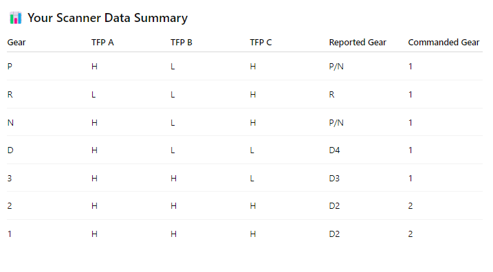

Old Jul 12, 2025 | 02:31 PM
  #33
Fuhnortoner's Avatar
Joined: Apr 2017
Posts: 276
From: █▬█ █▄█ █▬█ █▄██▬█ █▄█ █▬█ █▄█
🔍 What Your Scanner Data Tells Us
When you shift to manual low (1), your commanded gear is still "2" and the pressure switch states HHH, which indicates Drive 2 (D2) mode — not manual 1. The 1-2 solenoid remains OFF, which also aligns with being in 2nd gear.
So the PCM is not seeing the shift into manual 1 at all.
🎯 Key Diagnosis:
  • It's not the solenoids or electronics: Since everything changes as expected in D3/D4, your solenoids are working fine.
  • The PCM is not commanding 1st gear in manual low, meaning it doesn’t think you’ve selected 1st.
  • Removing the cable and shifting manually at the trans still doesn't help — so it’s not the cable adjustment.
🧨 Most Likely Root Cause:
The manual valve inside the valve body is not fully engaging 1st gear.
This is very common if the manual valve was:
  • Misaligned during reassembly
  • Binding due to a bent or worn linkage
  • Reinstalled without verifying full travel to 1st
Even if the external shift lever is hitting the stop, the internal valve may not be reaching its "manual 1" position, which is what causes the PCM to never see it as 1st gear.
🔧 What to Do Next:
To confirm and fix this, you’ll need to:
  1. Drop the trans pan
  2. Manually move the shift linkage and watch the manual valve on the valve body.
    • Make sure it moves fully to the end of its travel when in manual 1.
    • It should not have play or bind midway.
  3. If it doesn’t move all the way or is sloppy:
    • Remove and re-seat the manual valve
    • Inspect the rooster comb / manual valve linkage pin for wear or misalignment
🛠 Additional Checks:
  • Make sure the detent spring and ball are present and giving the correct tactile feedback inside.
  • Check that the valve isn’t hung up on a burr or mis-machined part of the valve body (this happens on rebuilds).
  • Inspect the PRNDL switch (MLPS) for misadjustment — if it’s off a hair, it can throw off the PCM gear logic.
Summary:
Your PCM is seeing Drive 2 even when shifted to manual 1 — that means the internal manual valve isn’t traveling far enough.
It’s not an electrical issue, and not the shift cable. It's mechanical — inside the valve body.
Once you correct the manual valve alignment or travel issue, you should regain proper manual 1st gear functionality and see the commanded gear change on the scanner.
Let me know if you want images or diagrams for reference during pan drop or valve inspection.

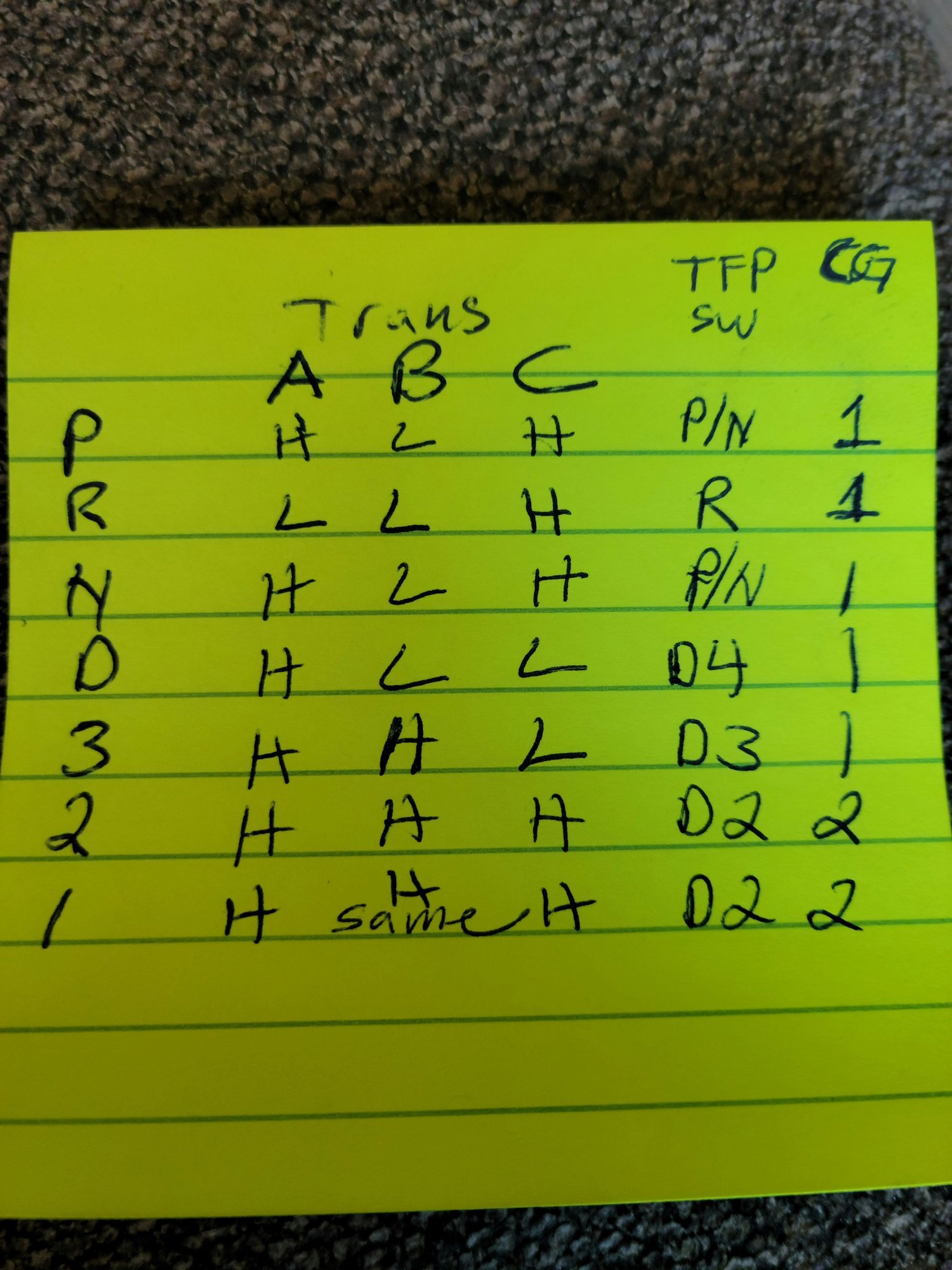

  #34
Mariodave's Avatar
Joined: Jul 2025
Posts: 14
Originally Posted by Mariodave
So I connected my scanner to monitor transmission data. In manual low, the data for the pressure switch and the command gear are the same. Pressure switch ABC is HHH, D2. Commanded gear is 2. The 1-2 solenoid is off. These seem correct for 2nd gear. I took the cable off the transmission and shifted to 1st, no change. It stays in D2. In D4 or D3, the solenoids and Commanded gear all change correctly. I don't know if the manual valve is not moving far enough to send a signal to turn on the solenoid for 1-2, or if the pressure switch is bad.
This the data off the scanner. How does the pressure switch and manual valve work to send the solenoid command to the PCM?

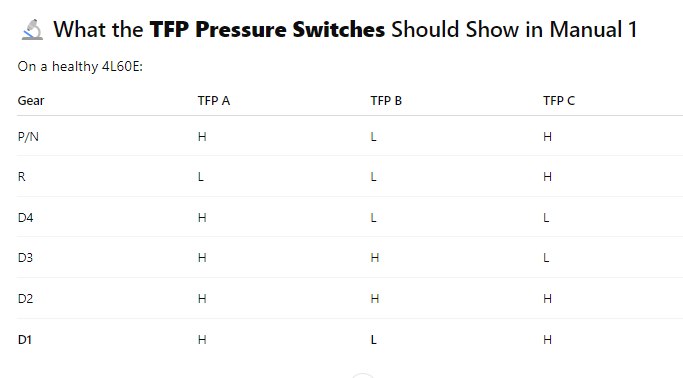

Old Jul 12, 2025 | 02:37 PM
  #35
Joined: Apr 2017
Posts: 276
Out here doing gods work
🔧 How It Works: Manual Valve + Pressure Switch + PCM
1. Manual Valve
  • The manual valve is physically moved by the shift linkage.
  • It controls hydraulic flow paths inside the valve body.
  • As it moves, it directs fluid pressure to various circuits including the pressure switch manifold (PSM), and routes pressure to clutch packs and servos.
2. Transmission Fluid Pressure (TFP) Switches – A/B/C
  • Located in the pressure switch manifold.
  • Sense whether hydraulic pressure is present in key circuits.
  • Return either High (H) (pressure present) or Low (L) (no pressure).
  • This H/L combination forms a “code” that the PCM decodes to identify the gear position.
3. PCM Gear Logic
  • The PCM reads the TFP switch state AND the manual valve position (via PRNDL switch).
  • It does not control the manual valve — it responds to it.
  • Based on the position and switch state, the PCM then decides:
    • What gear is commanded
    • Which shift solenoids (1–2, 2–3) to activate or deactivate
    • Whether to enable engine braking, torque converter clutch, etc.
🚩 Interpretation of "1" Gear Not Being Recognized
Your manual "1" gear (all the way down) reads the exact same switch pattern as D2, so the PCM thinks it's still in 2nd gear:
  • This means the manual valve is not traveling far enough to route pressure to the unique “manual 1” circuit.
  • No fluid is sent to the switch manifold’s unique 1st gear pressure circuit → so the switch pattern doesn’t change → PCM doesn’t know you want 1st → it holds 2nd.
Even though you shift to "1", the internal hydraulics never change to match it.
🧰 What Sends the "Manual 1" Signal?
  • The manual valve has to:
    1. Engage the 1st gear hydraulic circuits
    2. Apply pressure to TFP switch B to L
      • But in your case, it’s still High, so the hydraulic pressure isn’t changing
    3. Engage the 1–2 shift solenoid (Sol A) and allow engine braking
Because TFP B stays High in 1st (when it should change), this confirms the manual valve isn’t getting into the 1st gear position.
✅ Conclusion
  • Your scan data proves the PCM is not being told you're in 1st, because the pressure switch state never changes.
  • This points 100% to a mechanical issue:
    • Manual valve travel is incomplete
    • Possible worn or misaligned rooster comb, bent linkage, or improperly seated valve
  • It’s not the pressure switch itself — it’s not being triggered because pressure never gets there.
🔧 Recommended Fix:
  • Drop the pan and verify manual valve travel all the way to 1st.
  • Watch the manual valve link pin and rooster comb as you shift through the gears.
  • You should feel distinct detents all the way into 1.
  • If it’s limited, adjust the selector shaft or remove/reseat the manual valve.
Let me know if you want a diagram showing how the manual valve is routed through the valve body and connects to the selector pin. I can mock one up or label an existing image.
Old Jul 12, 2025 | 02:46 PM
  #36
Mariodave's Avatar
Joined: Jul 2025
Posts: 14
Also, I disconnected the PRNDL switch. That doesn't change the actual shift data, however it won't crank. That switch is worn out and fits loose on the shaft, sometimes have to move shifter to get the gear indicator to light up so starter will engage. I will replace it for that reason. Any information you have on checking the manual valve operation and testing would be greatly appreciated. Is it possible that the pressure switch is bad? Do you know what the switch should read in manual 1st ? Instead of HHH.

🔬 What the TFP Pressure Switches Should Show in Manual 1
🟡 Your truck still reads: H H H → which matches D2, not 1st gear.
So:
  • In Manual 1, TFP B should go LOW, not HIGH.
  • The fact that it doesn’t confirms pressure isn’t being routed to the D1 circuit.
  • Only 1 pressure switch needs to change (B → L) for the PCM to see D1.

Before suspecting a switch failure:
  • Make 100% sure the manual valve moves fully into D1
  • If it does, and the TFP B switch still reads High, then suspect a bad switch
  • You can test switches manually with a regulated air hose, or ohm test if removed — but that’s advanced level

Thanks for your help. I agree on the switch being ok as it changes to L in park thru drive.
