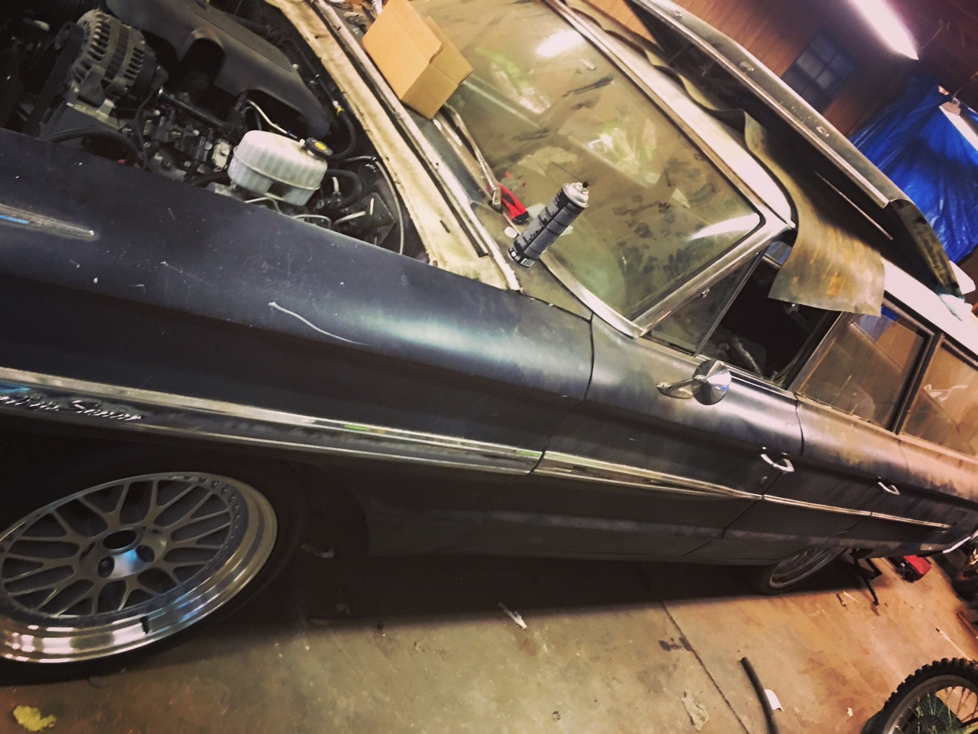

I hope this is the right way/place to post first timer here.
i have a 5.3 4l80e(all stock) swapped 1964 galaxie wagon with psi conversion harness . Everything from the swap was from the same matching 04 yukon except the 80e it was in a running/driving 03 van. I had the ecu tune done local. The issue I'm having is the trans will shift 1-2-3 and over driver very early causing jerking,lugging of the engine then won't shift down threw the gears when I come to a stop almost stalling. Codes that come up are p0650,p0740,p0785,p0856,p1689,p0856
had the tune re checked and he said it's fine must be in harness. Psi checked harness and is saying it's in the tune a few of the codes it has thrown shouldn't even be there for a 80e swap. Any info or tips to solve this issue would help a lot problem has been going on 3 months now
