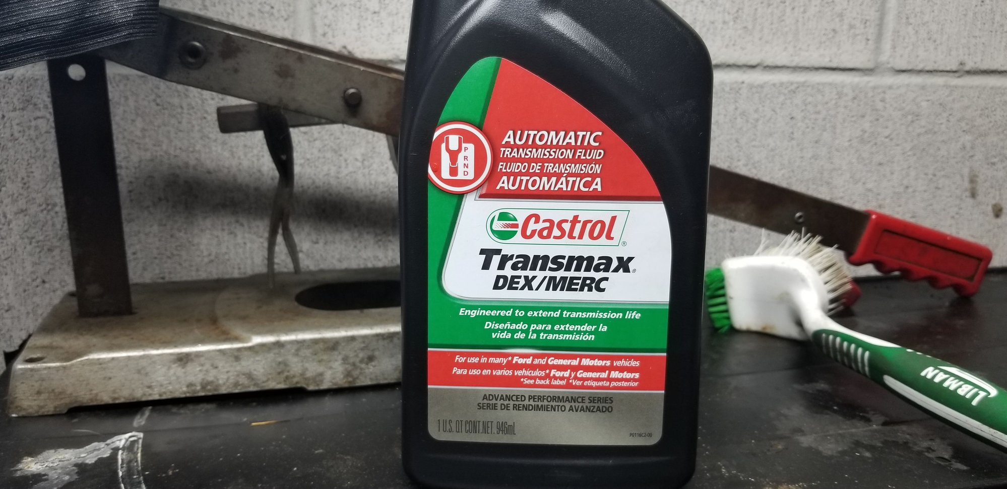

Th400 here, I use this..... seems to be fine. 740rwhp
