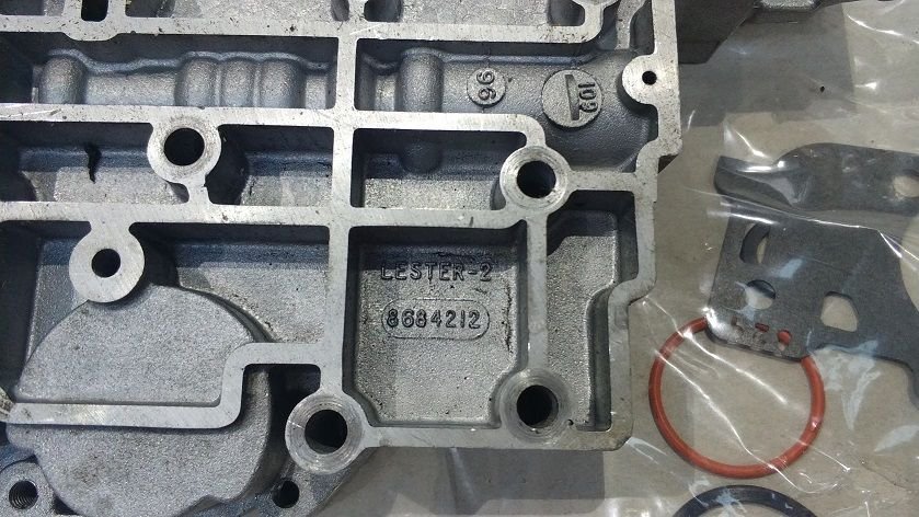

It came with valve body PN: 8684212, which was trashed and appeared to be the wrong one for this casing (pre-96? please confirm?)

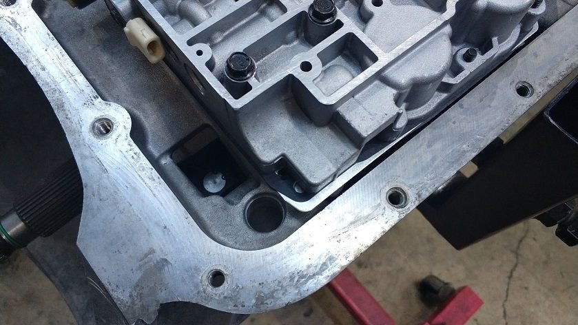

I bought a new valve body for an 03, with PN: 24204267. I assumed this was the correct one to suit my case, but now I'm unsure.

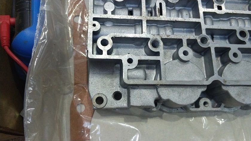

I've noticed on the corner of the valve body, there is a bit of gasket and a bit of spacer plate sticking out.
But on the older model valve body, this area would be covered.
What do I do? Will this valve body work on this case?

It's normal for the plate to stick out like that.
It's much easier to ID the year by looking at the case rather than the numbers.
More important is any parts inside from a 96 and older swapped into a 97 up case.
