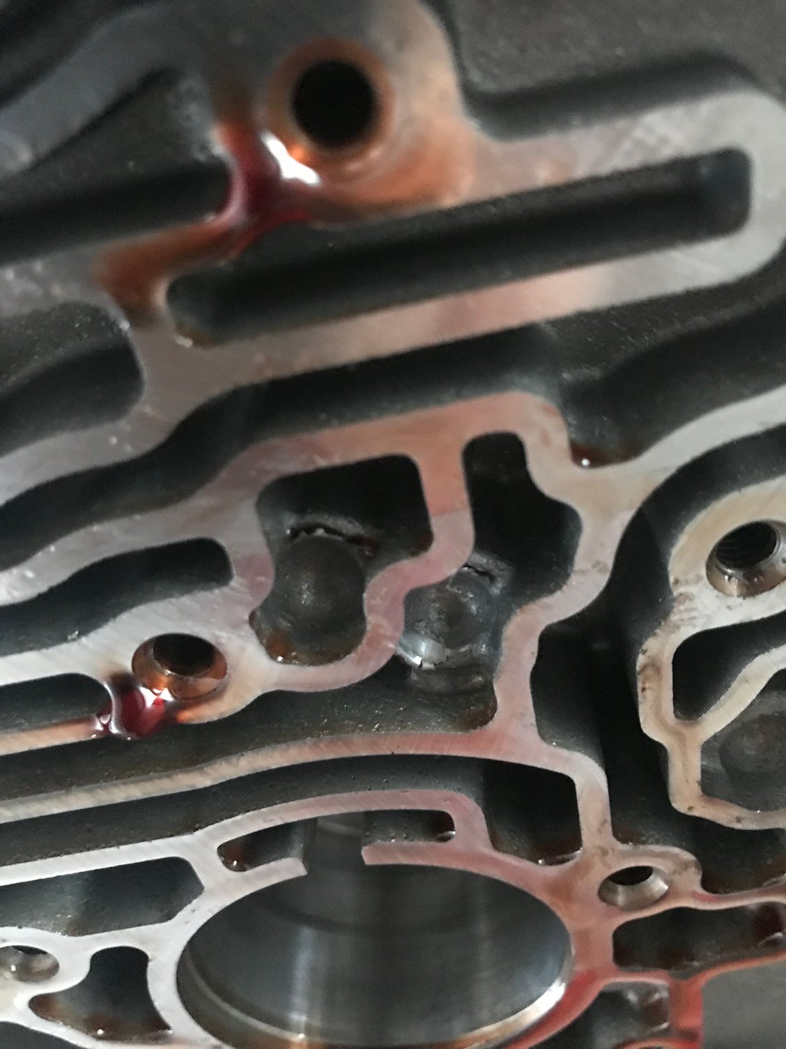

I took out the checkballs and noticed the metal were it sits in is a bit worn out, any idea if this is an issue or not?

Could u take a file and clean it up?? Tht pocket just holds the check ***** in place. If u can clean it up and smooth it out it should be fine. Check the seperater plate. I bet it looks the same, if so toss it and do the hd-2 shift kit.

Alright, Ill try to see if I can clean it up and Im gona install a jakes performance recal kit, dual feed the direct clutches

Throw the HD2 in the garbage where it belongs. About half the kit should be thrown away, 1/4 of it is decent parts, and 1/4 is the half *** way to do things that should be done internally.
Jakes kit is good if you want a set of instructions and parts all in a nice box. Glad you chose that over the HD2
