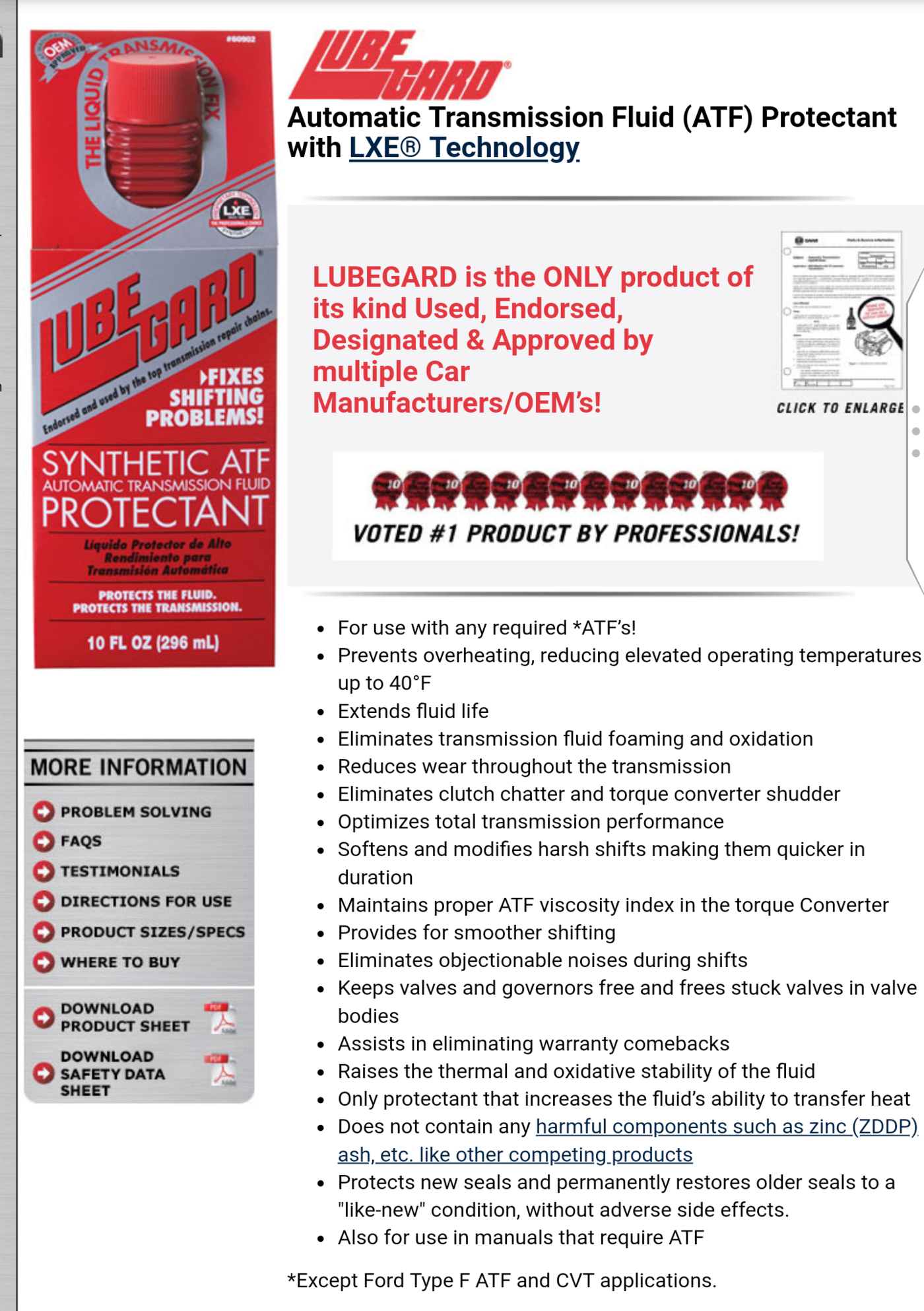

I've used Mobile 1 ATF along with Red Lubegard in both of them. Lubegard is OEM approved. Frequent fluid & filter changes are key and not getting too hot. I like to change filter and fluid ~15,000 to 20,000 miles but I'm a fanatic.

Hmm, I'm coming up due for an ATF change (currently 35,000 miles). I'll have to look into the Red Lubegard stuff. If GM supports its use there must be something to it because car manufacturers are notorious for aftermarket type stuff voiding warranties.

I use lubeguard every fluid change also .....

I'm not a fan of additives and avoid them all except for Lubegard. I think it's the real deal when used per institutions. Friend who owned a transmission shop told me about.
