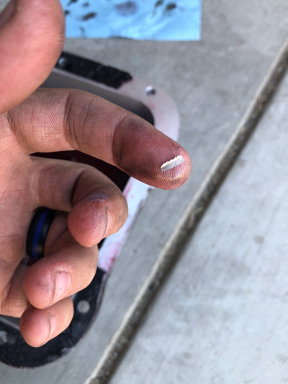

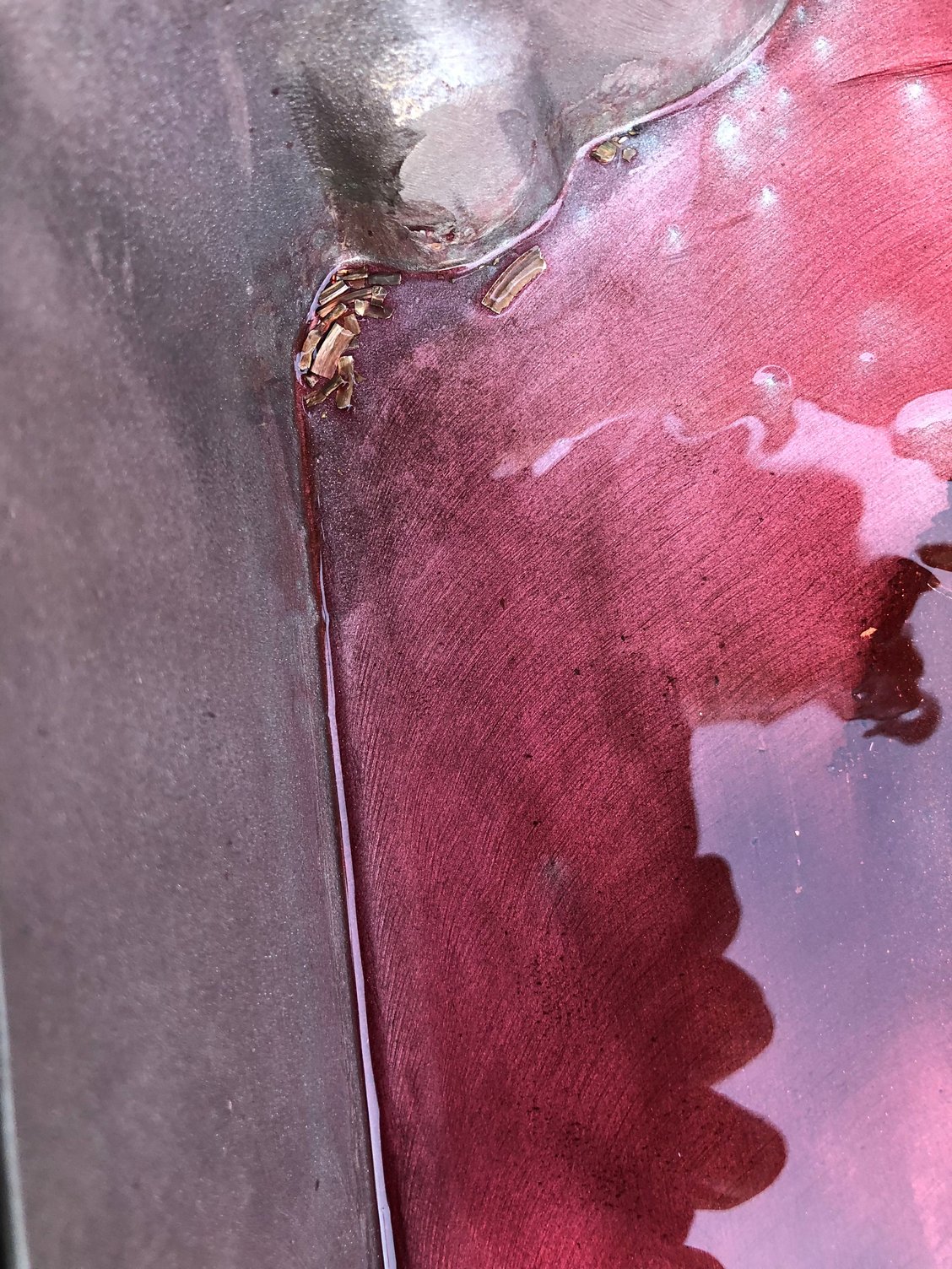

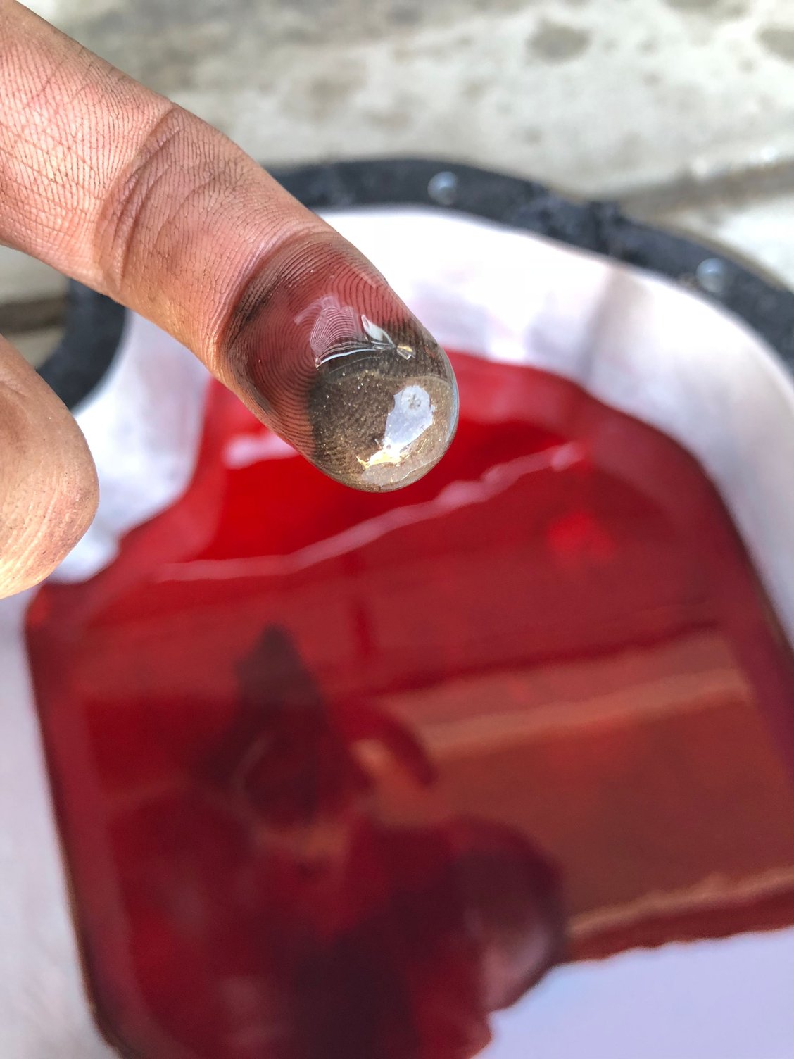

Probably a bushing failure of some sorts. Sucks because it has 1700 miles on it. Was a “Level III” 800hp th400. My setup made 600rwhp. Around 710+at the crank. This happened under mild acceleration. No trips down the track.

Damn, I'd be ripping that th400 out to see what wasn't assembled properly, fix it and get on with life. Getting kinda tired of looking of the pictures.
