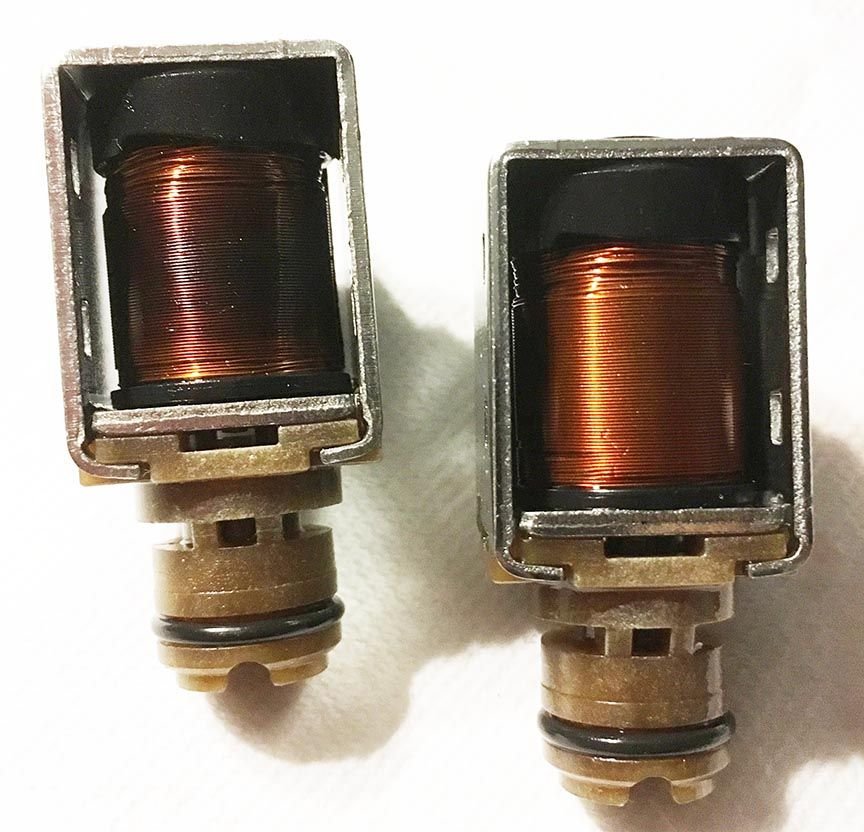

Bit the bullet and pulled the (no drain plug) pan. After pulling the drive shaft, in the way of course. Found the problem. I tested the solenoid and it does nothing. Hopefully that is all there is wrong with this.
Burnt solenoid

Glad you found the problem. If the solenoid still has electrical continuity the PCM thinks its good (no code), but we had several reports of the internal rod sticking and therefore no longer shifting the trans.
