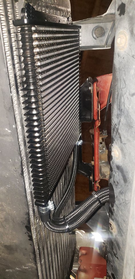

Stock case glide with a SFI bell, trans brake, PTC 9.5 converter specd for a turbo 5.3. BMR cross member, stock Flex plate drilled out for the glide converter and crank spacer. Had to space the converter out with 1 washer to get the spacing right .
Amazon flex dip stick.

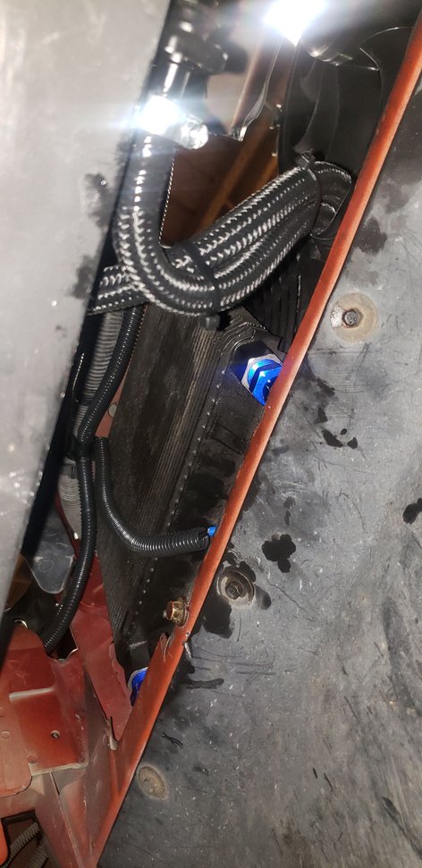

2 trans coolers in series . 1 right behind the Intercooler, feeding another one in front of the radiator .
2nd cooler

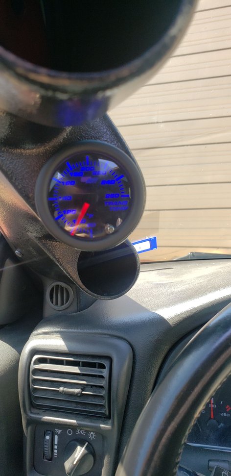

Trans temp gauge.

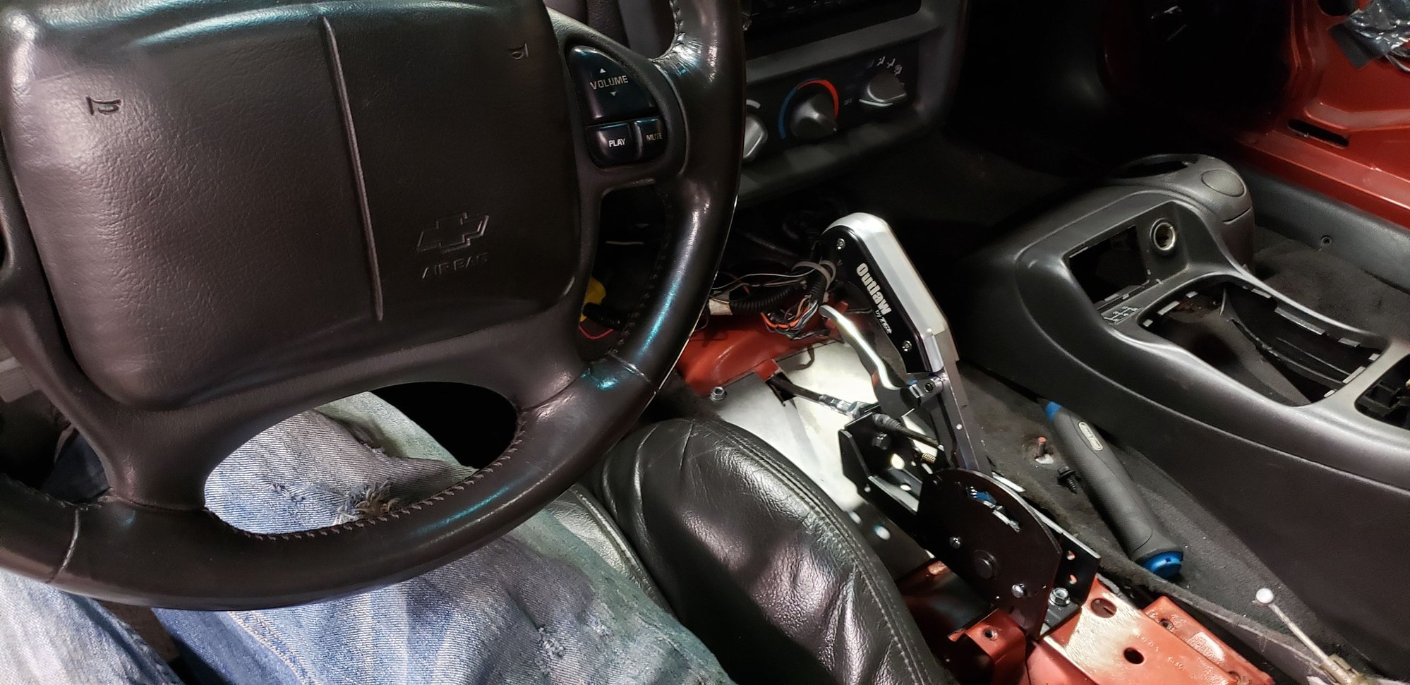

Tci outlaw shifter

Just to update this. The 2 coolers in series work incredible. Trans runs 150-160* . Went on a 25 ish mile cruise yesterday. Car needs a 28" tire in a bad way . 26" tire at 65 mph is roughly 3200 rpm with my 3.89 gears.
