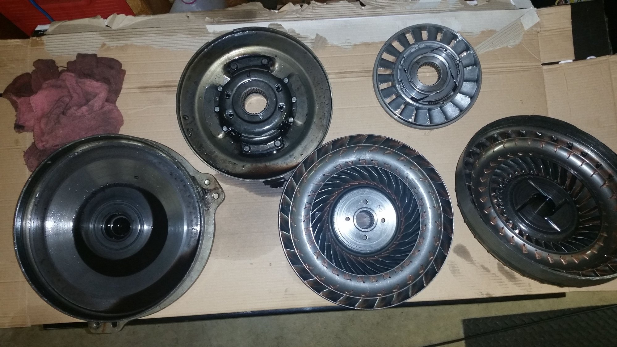

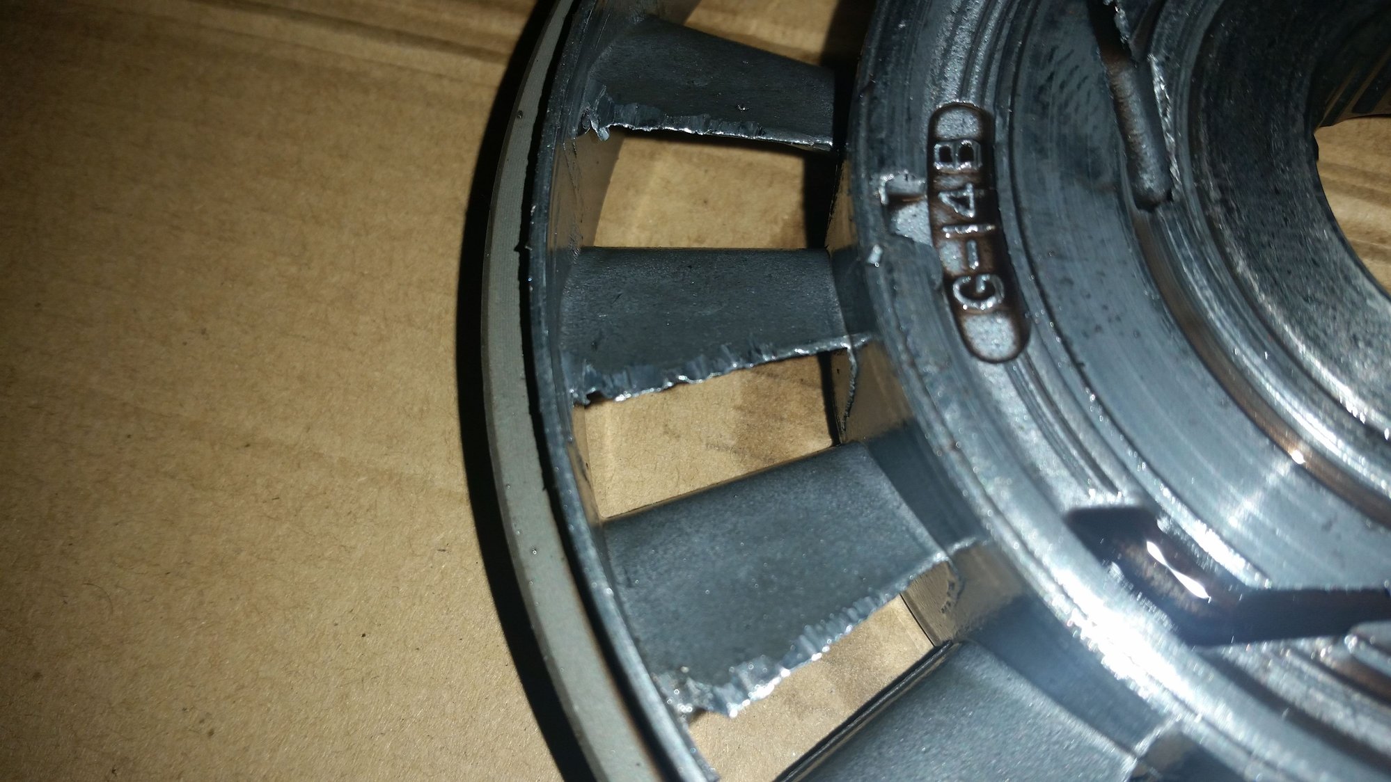

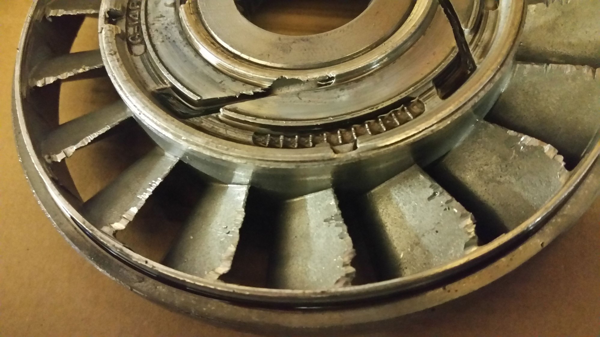

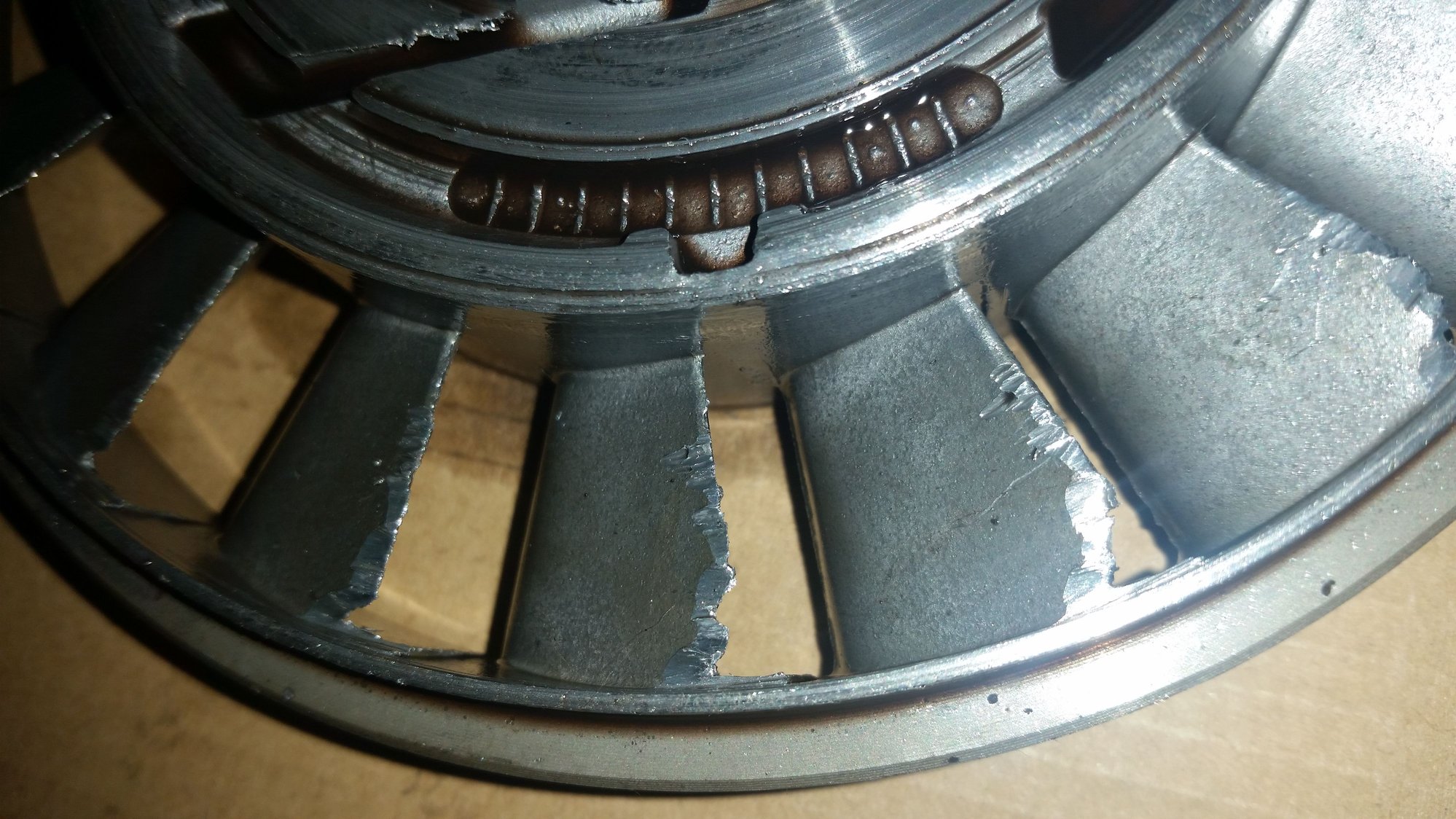

Reviving this old thread, I finally got the Edge 3200 cut open to be cleaned and it's shot. Shop said looks like bearings went out. I don't know if the TC went out and took out the transmission, or the other way around. Right now I still have this horrible Summit converter in the car (YES STILL). It's a DD that was getting over 40k/year minimum miles before covid, little less now. So, the oiginal plan of cut/cleaning the Edge is out the window, I am now going to install a Yank PT4000.
I chose the PT4000 because I actually finding myself wanting the power on a roll most of the time. I do runs from a stop, and obviously do so at the track, so wanted best of both worlds but wanted low STR to keep more power on the highway.
So, anyone want to make a guesstimate on my gains at the track before and after?
I need to first get my shift revs higher, after I put in the cam/springs/pushrods I never bumped it up from stock. But once I do that, I am going to take it to the track and get some "before" numbers. Then I am going to do nothing but swap the converter, tune the shifts to compensate, and do some more runs and see the difference.
Attaching a few pics of the busted up Edge 3200:
