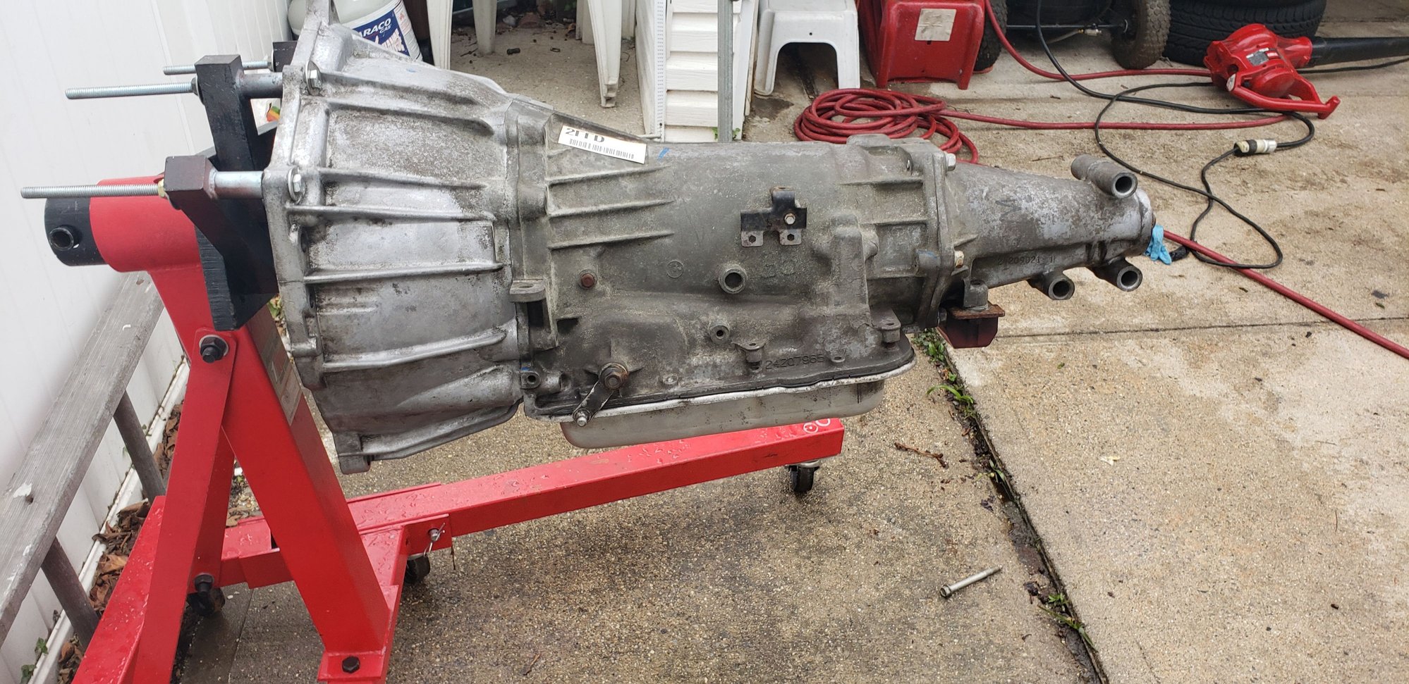

picked up a 4l60e for my ls1 going into my nova. dude i got it from threw in a TC, he wasn't sure if it came from the trans he sold to me.
the trans is a 2FFD unit.....translating to a 2002 v8 LS car
the TC had a sticker TMBX 2422 7948

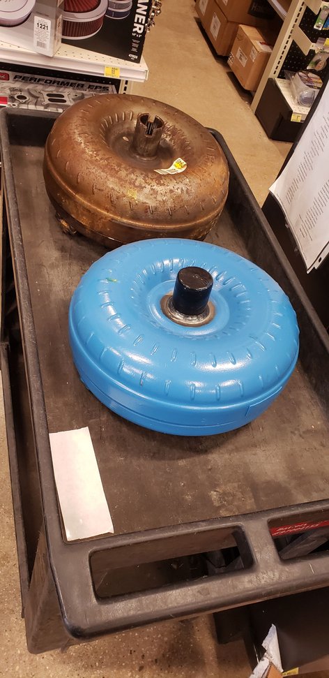

i scooped a rebuilt TC for it from AAP jus to get rolling and used the above mentioned as a core.
the TC i bought from AAP is not as tall as the one i received and returned as a core.

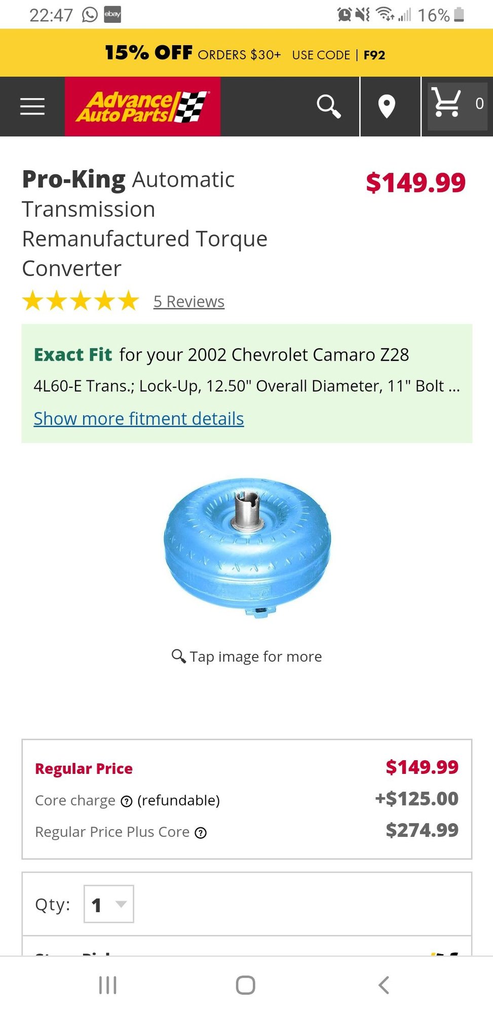

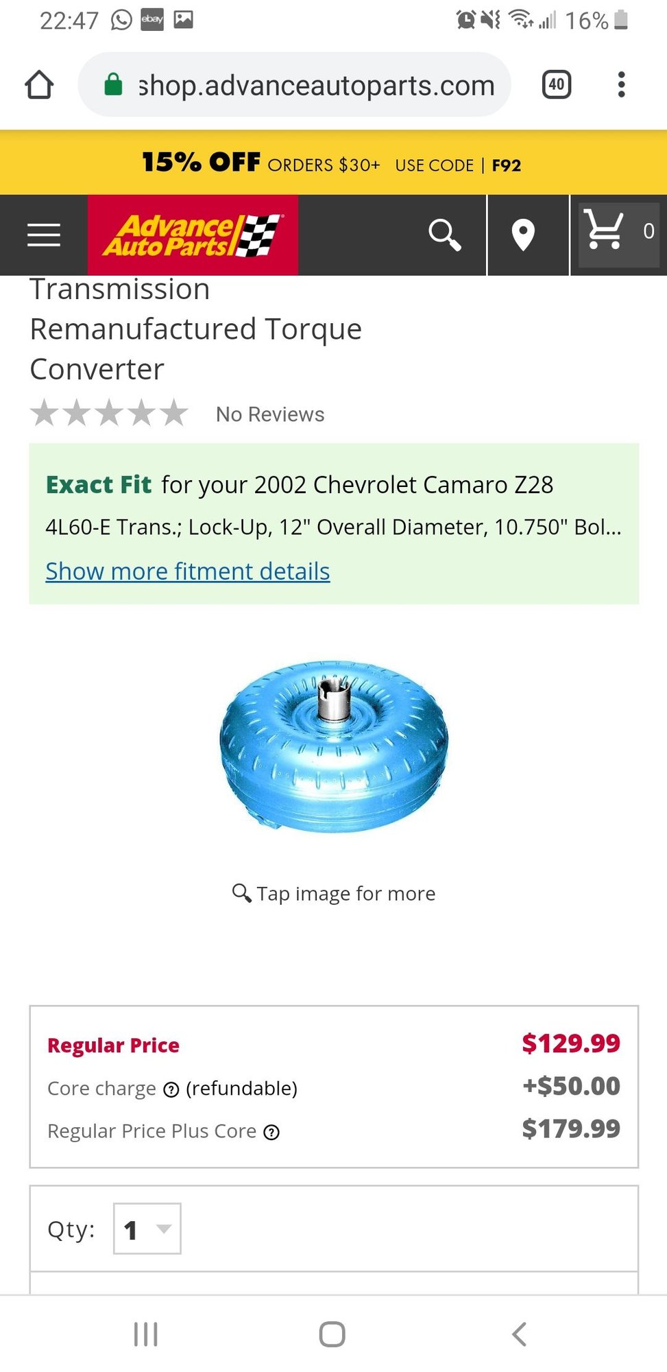

it seems there are 2 TCs that claim to fit a 2002 LS V8 trans GM92 and GM33CW
i seem to have the GM33CW in my possession
are the 2 compatible despite being different sizes.....AAP does list the 2 TCs as EXACT FITS to my 2002 camaro z28 ss
If I can keep it and use it.
any and all help appreciated because i can still return it and get the other one
The one i got from AAP
The one that i didnt get....but matches that TMBX code tbat3 was on thr one i returned as a core.
Blue one is shorter
Old Jun 6, 2019 | 06:01 AM
Jays_SSZ28's Avatar
Joined: Aug 2009
Posts: 2,223
Likes: 56
Yea you need the gm92. The most relevant pictures are of the front of it.
