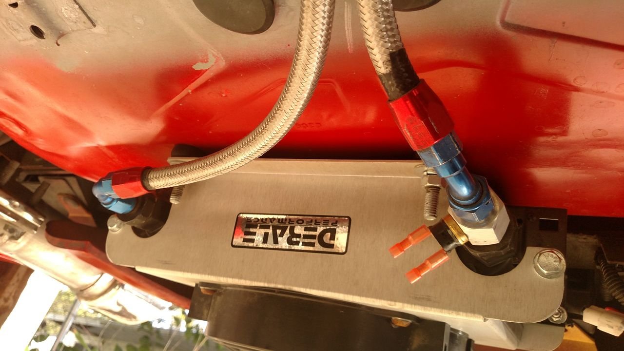

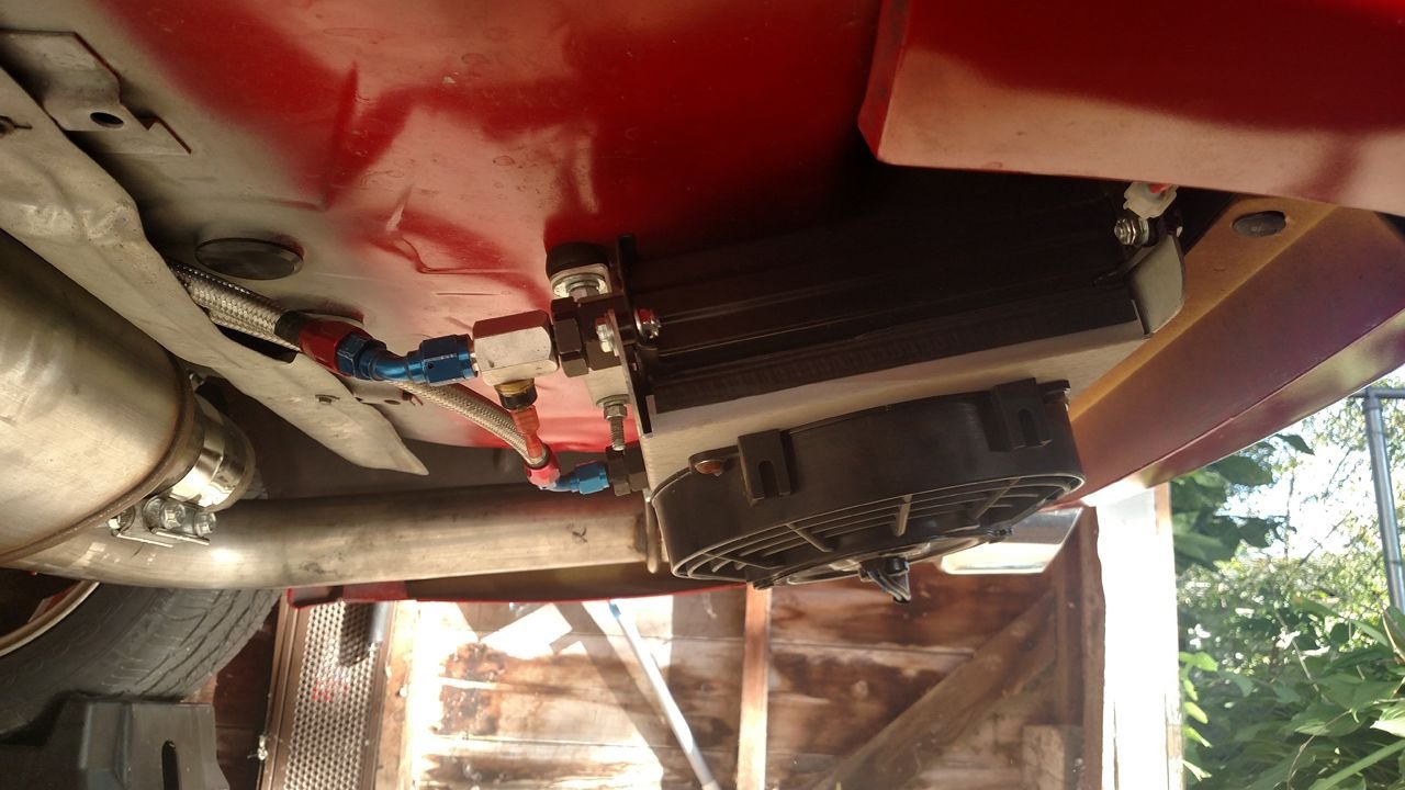

Old Sep 29, 2019 | 10:34 AM
klinznilk's Avatar
Joined: Apr 2015
Posts: 518
Likes: 32
From: Iowa
Here's mine mounted under ttop holder
