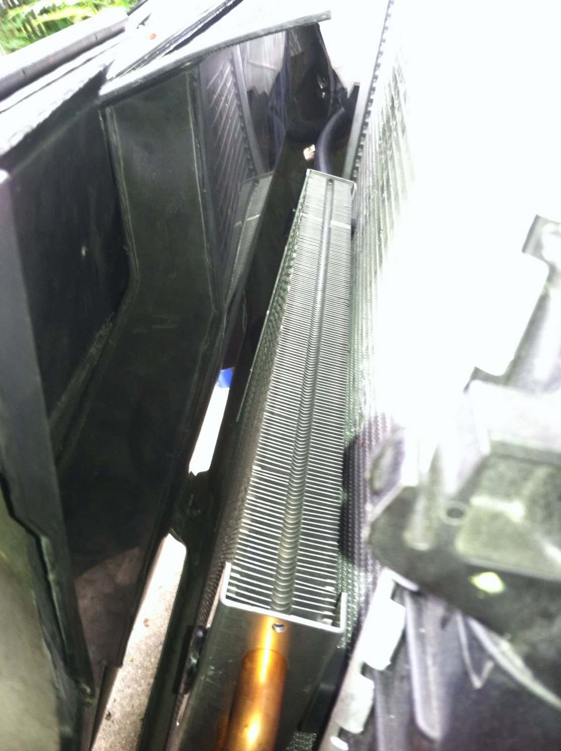

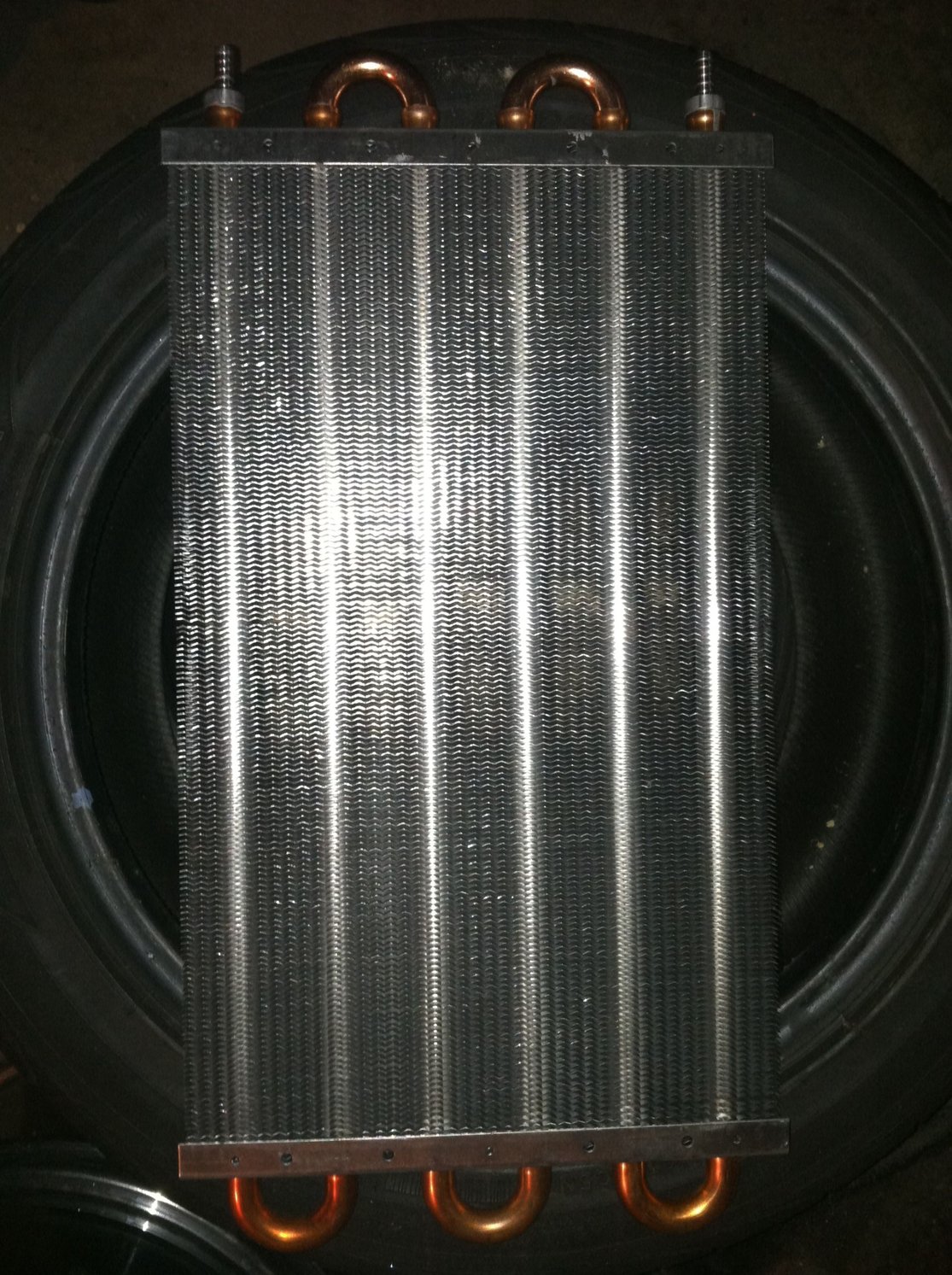

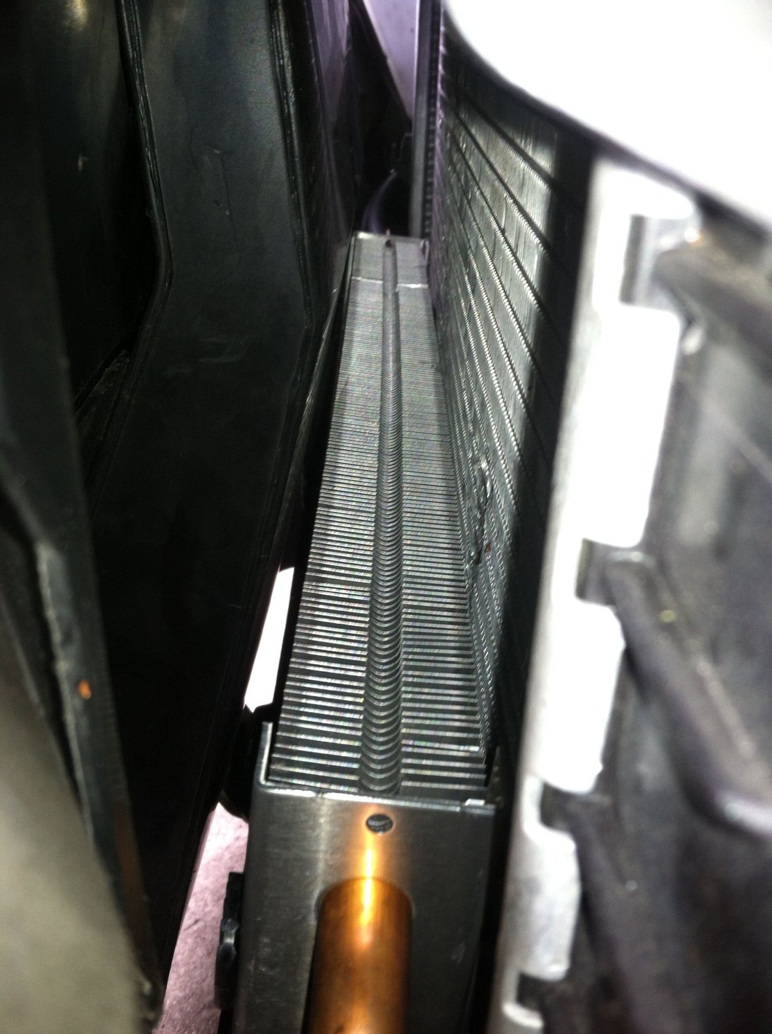

I'v had many different setups over the years. My last setup was the best on my car. Not sure if you have a/c out or not but my last setup was without a/c. I ran a big summit cooler in between the radiator (lt1 radiator) and the SSRA. Perfect setup for my car. The consensus around here is a fin+tube is not as good as a stacked plate but I have found the opposite on my car. I'm a fan of fin+tube. A smaller stacked plate B&M is what most seem to run and is sufficient.

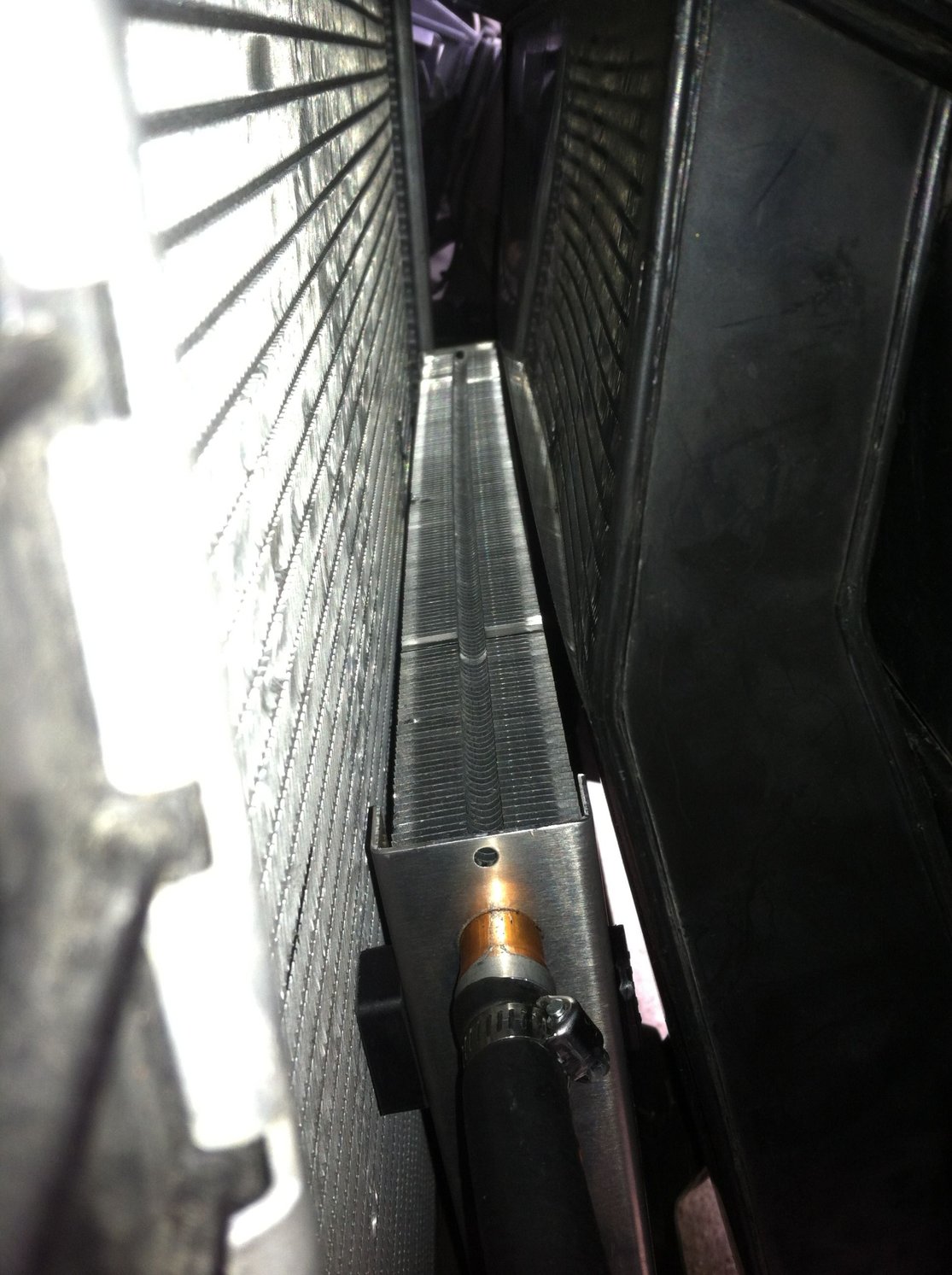

Here is the B&M I am talking about. I'd have to dig around for the part number but I'm sure another member here probably knows. I have ran these on the a/c condenser, on the radiator, on the air damn, and 2 on the air damn. When I ran the one on the air damn like that it was only for track and wouldn't recommend for a street car. 2 coolers didnt seem to help at all, but it did block air going to radiator...not good. This cooler will work best if you can get it on the condenser (if you have a/c) or on radiator (without a/c) Sorry, somehow I dont have pics in my collection with it on the condenser and radiator but I'm sure there's plenty of other pics+info here on this forum.
Thanks for the info and pics. That low mount would get ripped off where I live with our potholes! LOL

Here's a good ol' thread with lots of options and discussion ... I'm even in there with a very simple tube and fin that's been working on my car for 135k+

LOL no doubt, that's why I used it for the track but that's all.
You can use any cooler inline with the stock radiator cooler/heater or you can bypass it. Some will say if you drive in a colder climate you should run it inline with the stock cooler because it acts as a heater to get fluid up to temp quicker. I live in New England and did drive the car in winter but only above freezing with nice roads of course. I always preferred to run the coolers by themselves. Its piece of mind for me also because I didnt want the cooler/radiator leaking into each other. Never had any issues. Always warmed up the car 10 min or so before driving. Only issue that time of year was traction

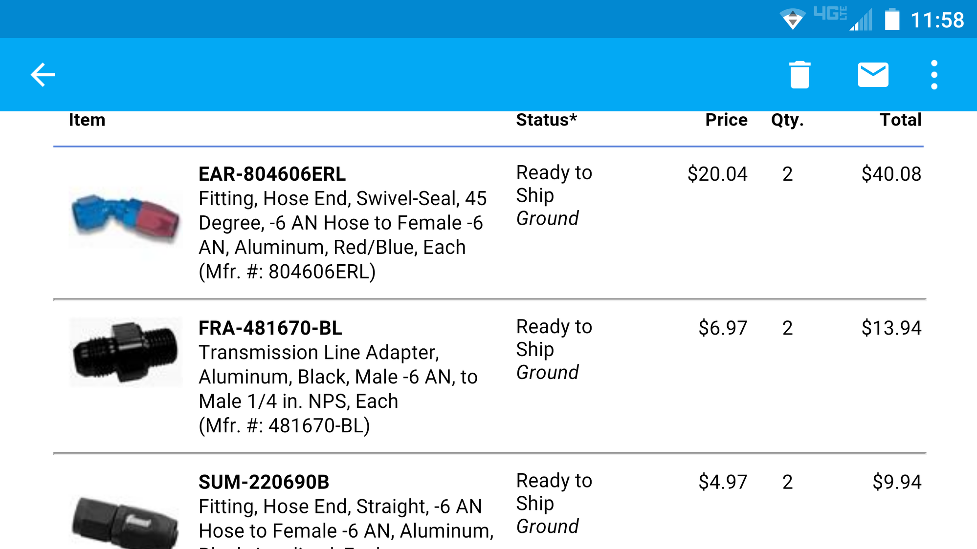

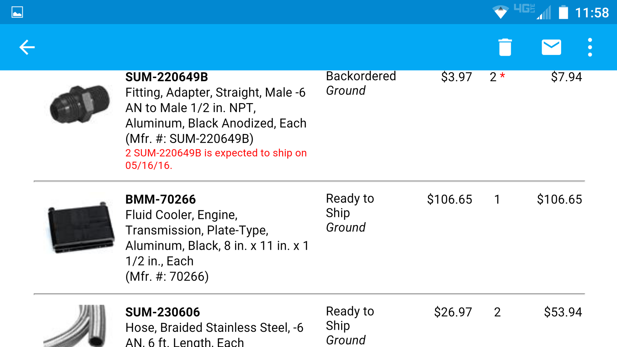

I'm using a Derale remote cooler. Fan moves about 500 CFM and comes with barbed or -6an fittings
