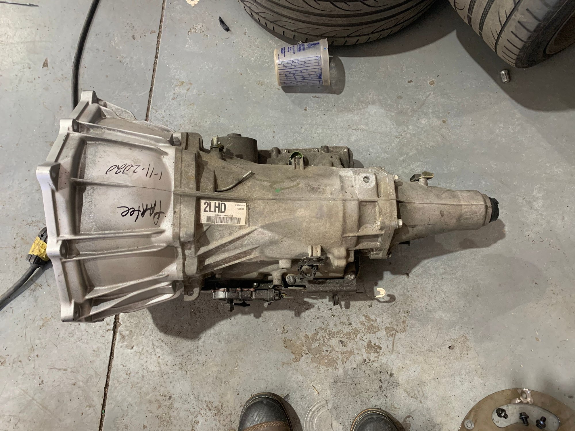

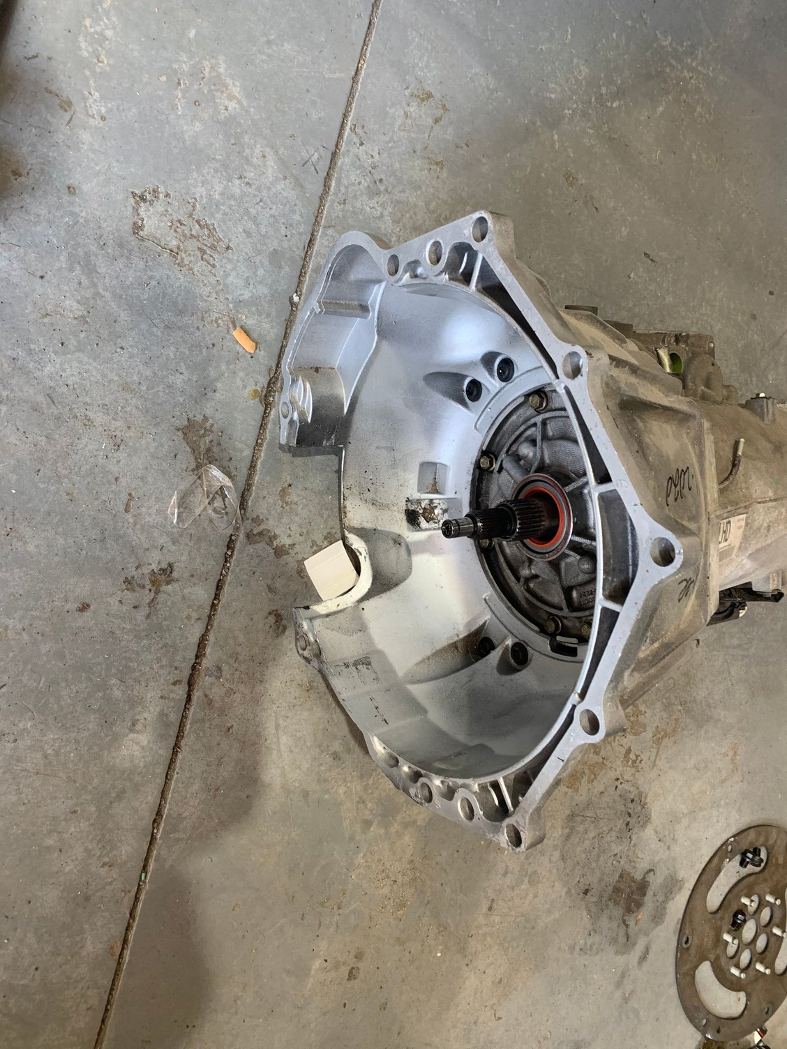

Thanks for offering to help. Here's what I've found out since I posted this thread. The flex plate is on a 11" bolt pattern and the torque converter is on a 10.75 bolt pattern. The transmission case is a 2002 but it appears someone has put a earlier shaft and pump in it. I've been dealing with a guy named Jason at Novak Adapt in Utah, real knowledgeable guy and willing to help. He's getting together a parts list that I'll need to try and make this transmission and torque converter work. Any suggestions or recommendations you may have would be greatly appreciated. I've attached a photo of the case and the shaft once i pulled the torque converter off.

Isn't that a 298 mm input shaft.
pre '98 and v6's

You know I'm not sure what size it is. The guy I've been dealing with at Novak Adapters sent me a photo of what the shaft should look like if it was a 2002 model and a photo of the old style shaft and according to him this was the old style shaft in a 2002 case. I'm lost when it comes to transmission so I'm dependent on guys like you and him to guide me thru this! Any suggestions or recommendations you may have would be appreciated.

Thats a bastard of a transmission. This is an assumption, but the newly painted bellhousing with that input shaft looks like a van transmission with an LS type bellhousing, The fastest way to make that work on an LS1 would be to swap the original bell housing back onto it, get one if you don't have it. Use the torque converter for that transmission, use crank pilot adapter. Use a LS type flexplate and oval out the holes. That will get it connected.
BUT..... Do you know if this transmission works? Can you exchange it for one that will just bolt up to an LS engine?
The correct thing to do is get an LS type transmission. If you go swapping parts you're going to get into a full rebuild, which as seen on this site usually ends up with a non working transmission.
Yes it can work. IT'S NOT WORTH ADAPTING. Please get a transmission that already has the correct parts.
Did you but any chance get this from a supplier in florida? I've seen ads on c raigslist that show a picture of a transmission just like that, wrong bellhousing/input shaft combination.
