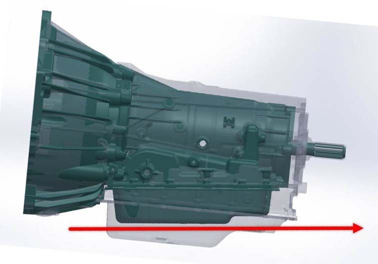

Aligning the input and output centerlines of the 4L70 and 6L80, if a 4L70e is swapped with the 6L80e it appears that the transmission will run at a different angle. Will this cause oil starvation issues? If so, can the 6L80e transmission be overfilled to compensate?

Hmm. the engine to bell surface angle should be the same and the shaft angle,,
I'd look at pan options.
