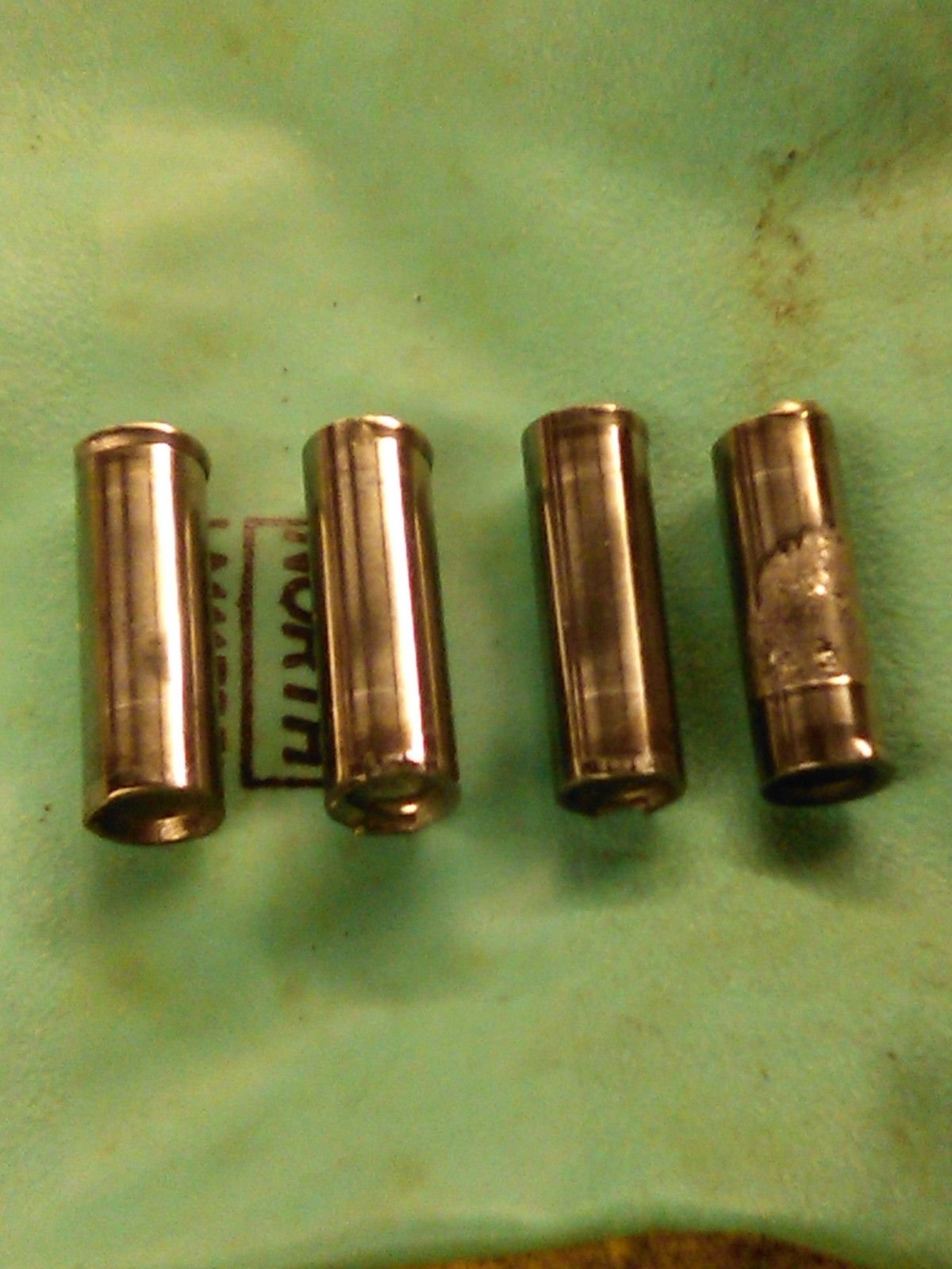

vorteciroc , I owe you a HUGE THANK YOU!
If you didn't mention the tightness of the pinions, or my method of figuring front end play - I would have probably exploded my first 4l80e.
I felt something wasn't right (after your post) so I tore everything down and figured ALL end plays out again.
I found that I did it all wrong - never taking into consideration the rear end play with the front end play - and figuring rear end play with the planets installed.
After re-doing all that - with no planets installed for rear end play, and thinking a lot about the ck methods - here is what I got.
rear end play .012
rear carrier .011 - however it may change (reason at the end of post).
front hub .010
front end play .016 with a .090 pump washer - HUGE difference! I originally did the front end play being .012 TOO TIGHT! Pretty sure that would have been catastrophic!?
Also, upon a second tear down, I noticed the rear planetary pinions seemed loose. I checked the clearance in the pinions and they were over .030 (with a feeler gauge), and one had a little wobble. So, I decided to just rebuild them. The picture is of the 4 pinions - guess which one was the wobbler?
3 pinion shafts measure .443 and the 1 worn one measures .434 - it was only a matter of time. Lesson learned here!!
If it wasn't for your input I would have never found this until after the explosion.... Thanks again!
You owe me no thanks.
You took the time to properly examine the parts you have...
and to examine the clearances.
So you need to thank yourself.
