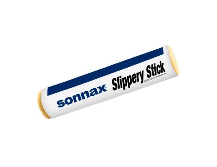

Some of the Older Transmission Parts Houses sell a lube-stick...
Kinda like a glue-stick/ chap-stick... I don't care for it.
Sonnax seems to still sell some also... but it was originally a product intended for lubricating different types of locks and door parts.
Here is one of the original products:
Here is a repackaged Sonnax product:
LMAO!
