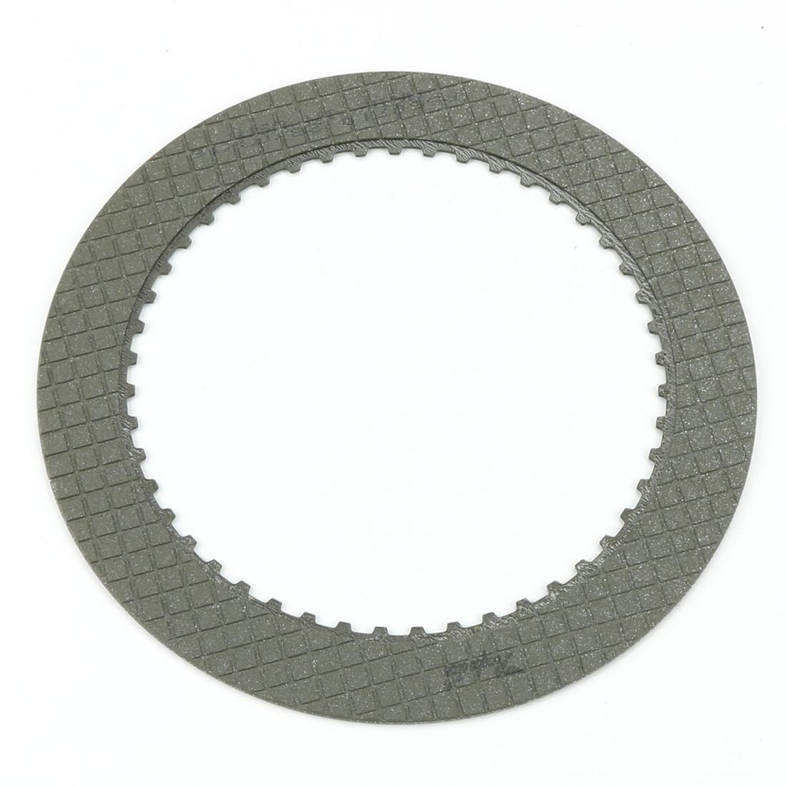

I'm looking around for the frictions mentioned in the instructions for this Griner th400 brake VB and just cant find such an animal
they give part number 34304H and oem ref # 24202646

They don't match the part numbers you list but here are some
Waffled forward/direct http://www.transmissionpartsusa.com/...-00046551w.htm
Tan slotted forward/direct https://transpartswarehouse.com/auto...d-1964-up.html

#24202646:
Is one of the GM part numbers for the 4L80E Forward clutch/ Direct clutch Borg-Warner High-Energy (green) friction plates.
These are smooth... so do not know why they are revered to as "Grooved/ Slotted" in your instructions.
The "hard" frictions plates that the instructions mention (stated as: "no longer used") are a semi-waffle type friction plate from a GM/ Allison that are used in the Allison AT540 transmissions.
The other "hard" frictions that are also mentioned, are the "full-waffle" frictions plates from Raybestos/ Allomatic... like the ones in the hyper-link below:
Click Here
