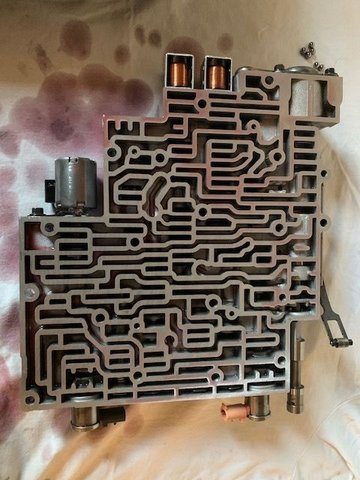

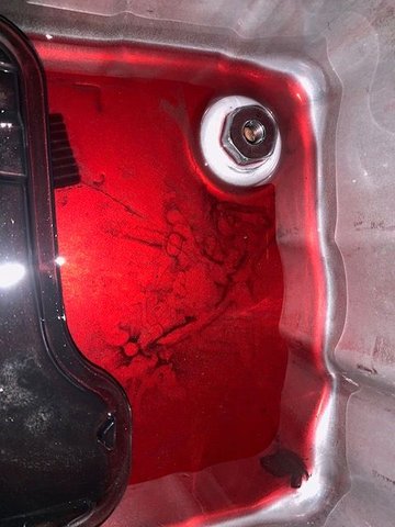

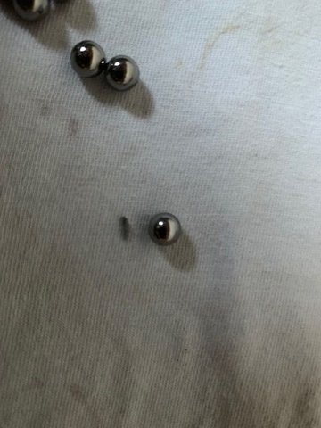

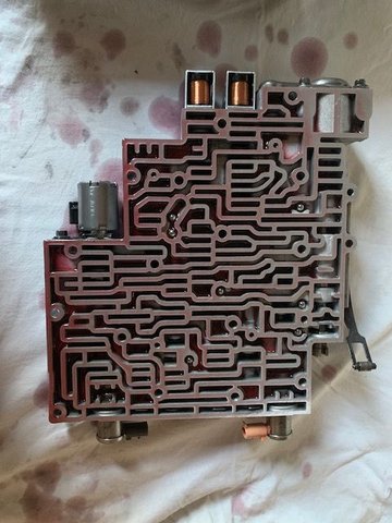

I took the valve body off today and took a few pictures. I noticed a little bit of metal down in the pan which kind of scared me, and I did find one sizable metal shaving (pic attached). I think this shaving may have somehow gotten leftover from when I reamed out the hole for the sonnax tcc regulator valve. Please take a look at the pics, and let me know what y'all recommend I do next. Like I mentioned, I have the parts coming for the vacuum test stand and I should have that together by the end of this weekend. I found a diagram of circuits to vacuum test on the sonnax website. I suppose I can start there.
