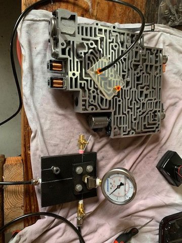

After the initial transmission rebuild, I noticed some weird 2-3 shifting. I would call if kind of a hesitation. I didn't notice any kind of flare (sudden increase in rpm) or anything during the 2-3 shift, and I didn't notice any kind sudden pressure change during shifting. My pressure at 75% throttle was >200psi, pressure in PD123 at idle was 70psi and pressure in R at idle was 110psi.

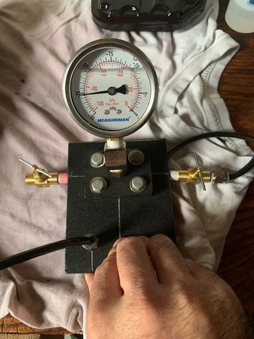

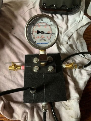

Based on the advice of some on this board, I decided to pull the valve body and perform vacuum testing (see images showing my vacuum test setup). I ended up using flex seal clear tape on the bottom of my test block which seemed to work really well. I ordered some silicone mat, but I got sick of waiting on it. I got the tape at Lowes, and put two layers on the bottom of the acrylic block.
If anyone has any comments on the test results and suggestions on what to do moving forward, I would really appreciate it. This is my first rebuild, so I'm pretty ignorant on what to do to fix any issues.

The 3/4 and 4/3 #1 locations will both clean up and get much better with sonnax o-ring end plugs.
I usually just do those before even testing because they're bad so often.
The other 2 end plugs you might as well do because they come from sonnax in packs of 5 so Just replace the others. Won't hurt a thing.
3-2 downshift needs to be tested with the valve bottomed in the bore.
I'd get a Central Valve Bodies Drop in valve for the AFL and you should see it jump to 19 ish
Fwd and reverse abuse you don't need to worry too much about. at least not at the nose.
The end plugs is the only area on those valves I ever attempt to correct.
Otherwise they always have shared oil on either end of the valve at the nost so any leak will just leak back into itself. No biggie.
I'd get a reverse abuse bore plug from sonnax and replace the stocker.
Looks like a couple small things will clear up some leaks in the 3rd gear circuit and you'll see some improvement .
